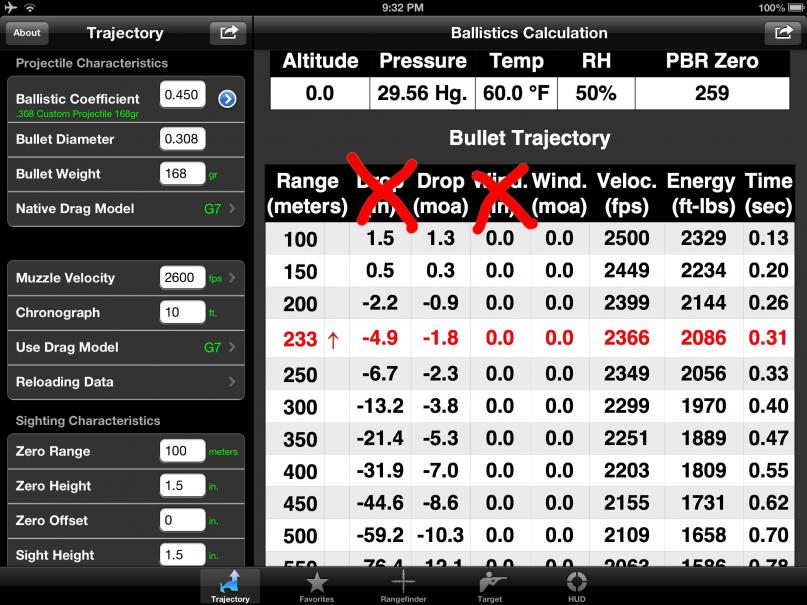

I would like to see the in drop columns from the trajectory card be optional. It can be kind of busy and for the most part, I'm only concerned with how many MOA or Mrad the drop is. Inches is gee wiz info. This goes for the wind as well

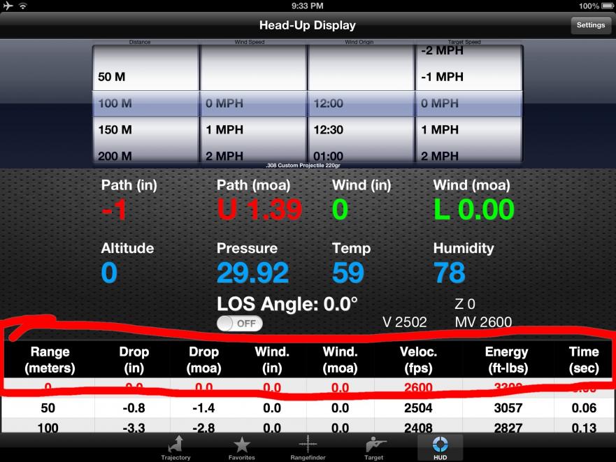

Also, in the HUD, I would like the heading to be fixed so if I scroll through the trajectory card it's always visible.
Sent from my iPad using Tapatalk HD

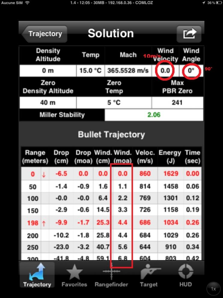

Hi,
How come when printing my range card, wind velocity (10m/s) and wind angle (90°) do not show up in the upper part of the page?
On the other hand, correction appear down the page in the bullet trajectory. It is kind of confusing when printing different wind velocities.
Thanks a lot for your great app
