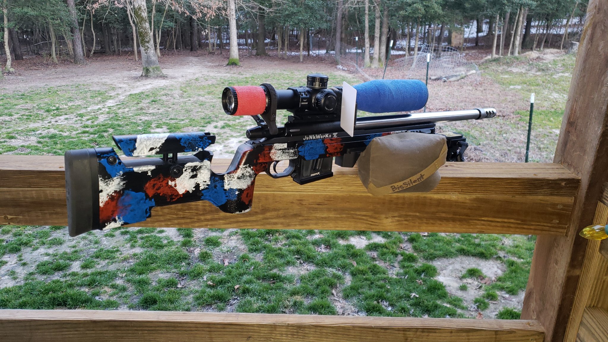

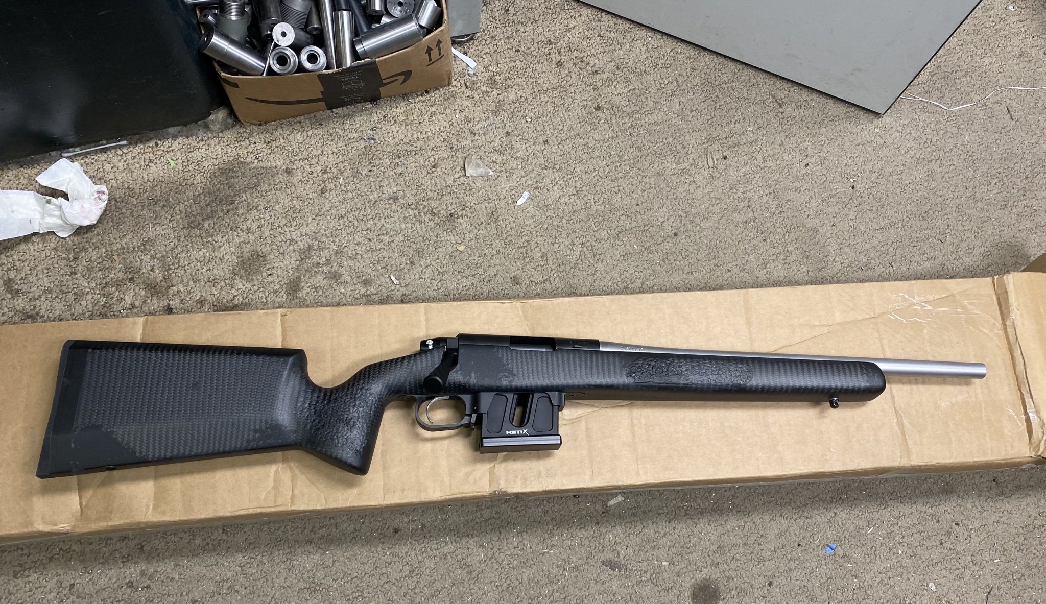

Took some time getting everything together. Mag adjustment was a little funky but once I had all 4 squared away there hasn't been any problems since, 500 ish rounds in. Barrel is a 20" green mountain with eachus chamber from keystone accuracy, MPA BA chassis, trigger tech diamond flat. Runs good with everything I have fed into her so far, SK standard +, SK rifle match, SK long range match, Lapua center X, Lapua X-Act. Had a few light strike hiccups that I'm basing on the unexpected 20 degree weather and the liberal grease application, but I've cleaned that all out and going for another run later this week to be sure. ZERO regrets so far in my choice.
Took some time getting everything together. Mag adjustment was a little funky but once I had all 4 squared away there hasn't been any problems since, 500 ish rounds in. Barrel is a 20" green mountain with eachus chamber from keystone accuracy, MPA BA chassis, trigger tech diamond flat. Runs good with everything I have fed into her so far, SK standard +, SK rifle match, SK long range match, Lapua center X, Lapua X-Act. Had a few light strike hiccups that I'm basing on the unexpected 20 degree weather and the liberal grease application, but I've cleaned that all out and going for another run later this week to be sure. ZERO regrets so far in my choice. View attachment 7533271
Great looking rig!
One quick thing - the grease we apply is intentional and will promote a smoother operating action. I'd make sure to put some back on the shroud where it interacts with the bolt body. We use Shooters Choice all weather grease that's good in extreme temperatures.
If you run into anything you need assistance with, please let us know. Thanks - Ray
Reactions: SubMech and usafa77

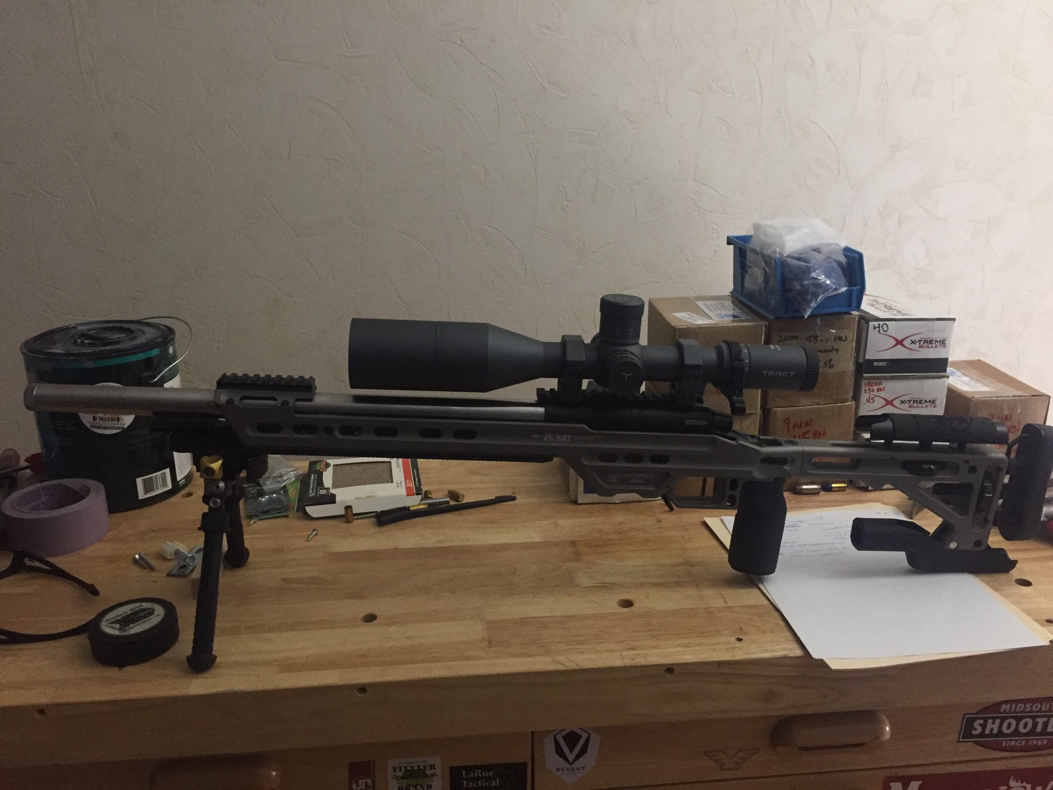

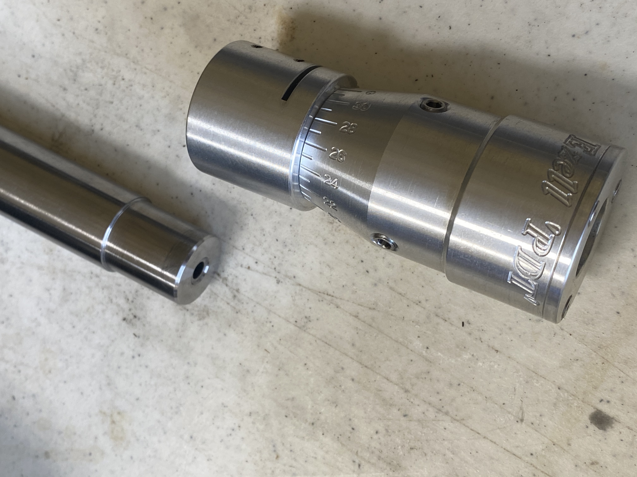

My RimX fitted with a M24 profile Shilen ratchet barrel blank I secured from another site. As this was to be a test barrel, instead of making the tenon according to RimX dimension I threaded for a Savage barrel nut for ease in fitting. For chamber I used a standard .225" chucking reamer for my Lapua Midas+ and used a PTG.22CF Throater to adjust bullet jam to about .050". Cut barrel to 21-1/2" and turned the front to accept Ezell PD tuner that I use on my Anschutz 1907. Was going to compare this setup to another Shilen ratchet #5 profile which I got from Lee Gardner precision with his Match chamber. This barrel and tuner shoots very well. So far initial testing has shown that they work the same, but special chamber reamers not needed or precise tenon machining. Easy set-up for those with a good lathe and machine skills.

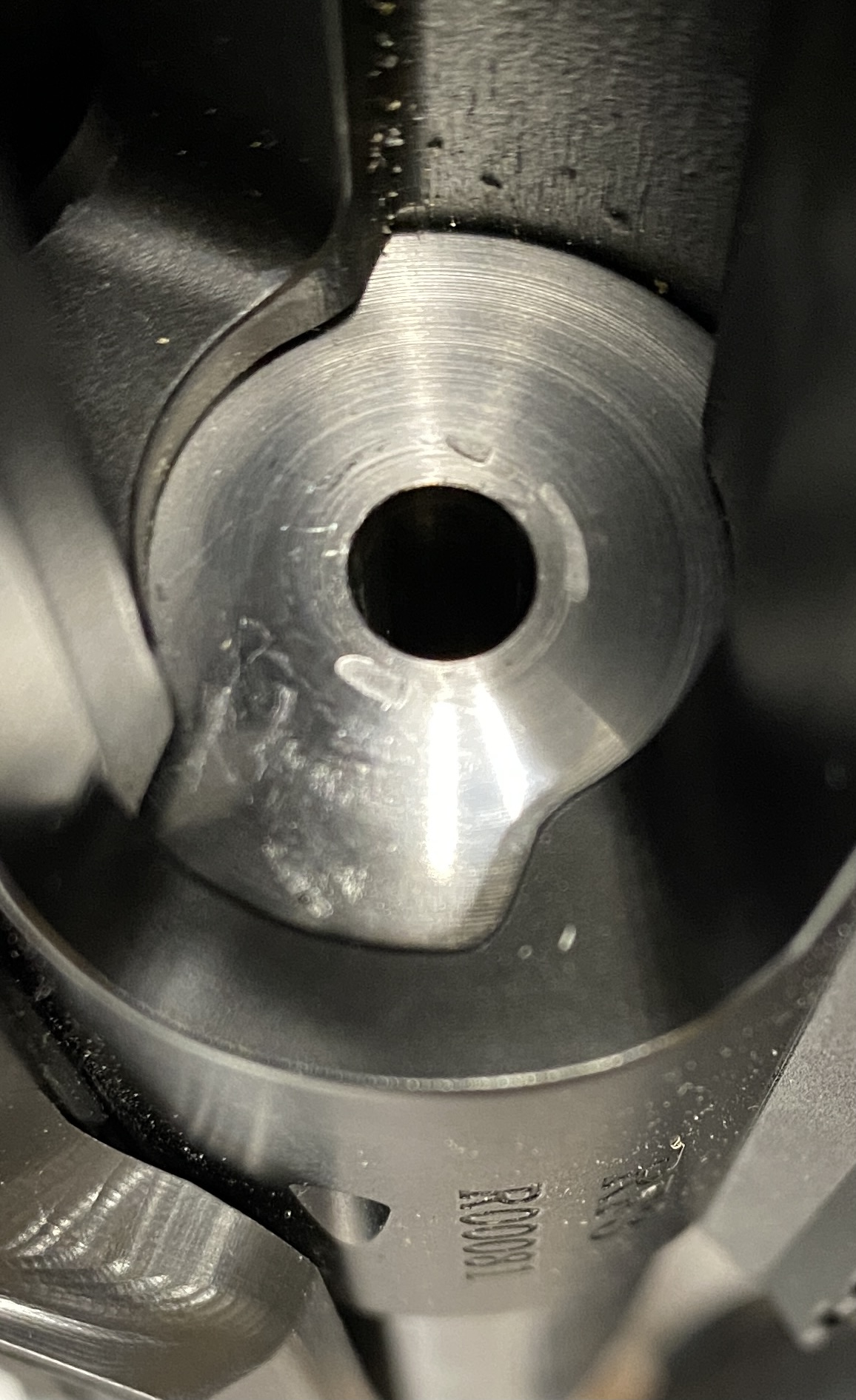

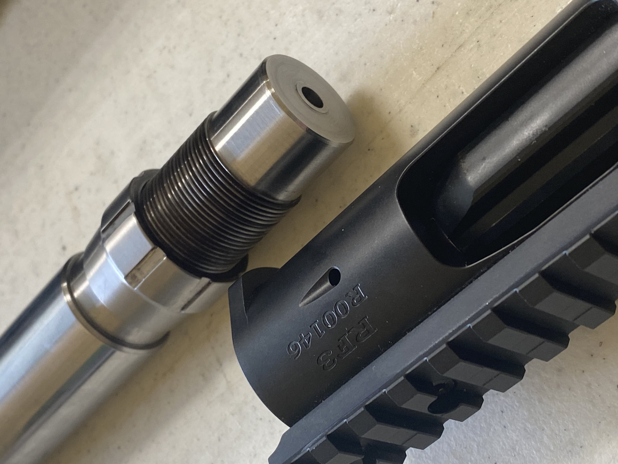

Anyone have an idea where and what are those
Indentation on the breech face?
Benchmark barrel prefit. Barrel is brand new , I’ve shot the first 170 rounds through it and that’s what I’ve found once I inspected it after the range session. It’s catching under the nail.
No FTF or extraction issues. Feed fine. Torqued at 70 ft-lbs
I’ve check also I don’t have any bolt back lash with the firing pin removed . Might explain this.
