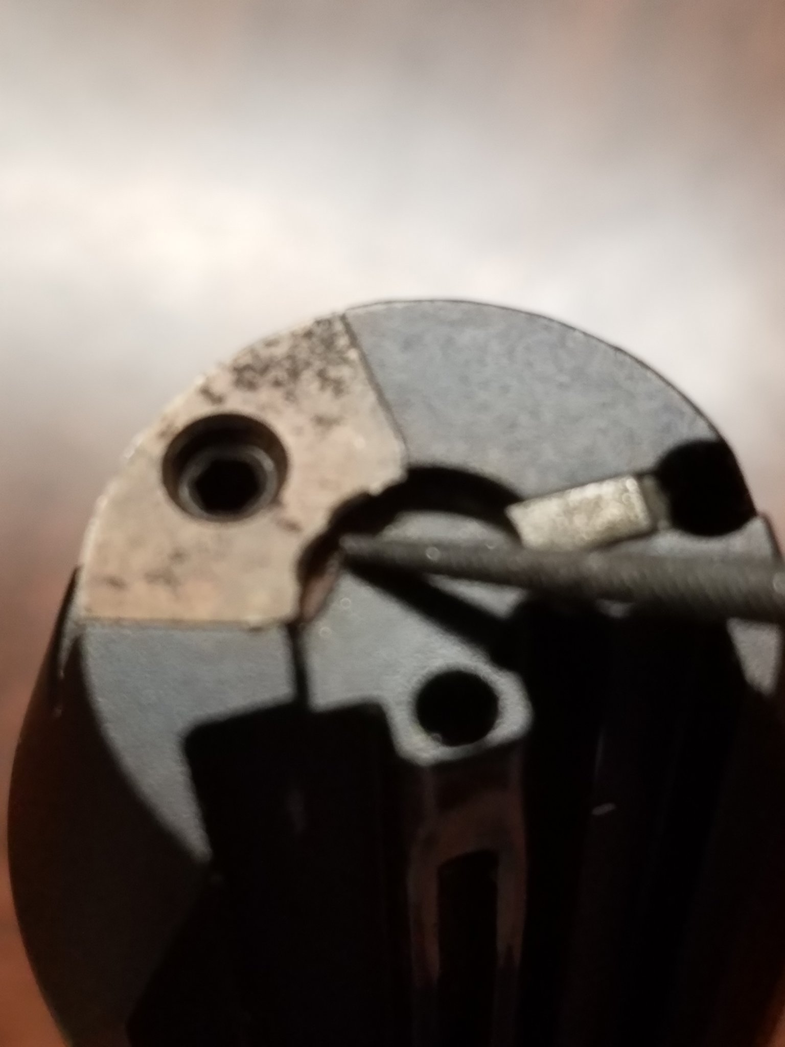

I had a FTF in my RIMX the other day during a rapid fire session 1st one in 2000 rounds. Normally I clean every session the day before I did not do this , I set up to shoot about 15 rounds down the shell jumped the bolt face. Wonder it didnt fire as fast as I was cycling the problem! Well I had noticed a little bit of wax on the breech face of barrel at the end of sessions from blow back on port side. Right in line with the hardened plate ie.tensioner or extractor what ever they call it. The wax had packed under this allowing no room for the minamal edge to capture the case and retain it during cycle. The fix pulled bolt, with a curved micro plastic pick I cleaned this out we were back in business thought the edge suffered some damage from the hard cycle it still works and a new part is in the works. Clean both sides of bolt face regular to stop this from happening. I attacked photo to show damaged tensioner edge.
Reactions: Schütze
So am I reading this correct that a build up of wax under an edge has caused enough damage to a part warranting replacement of that part?

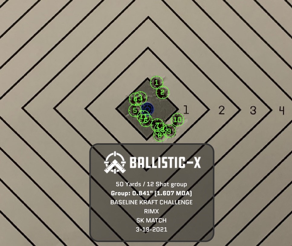

I shot a Kraft challenge with my RimX a few weeks back. That might be the most insightful 12 round drill I've ever shot. Super fun to do and I was surprised with my results given that I rarely shoot positional. I really want to work on it and see if I can get down below 1 MOA for my baseline targets before I start adding some speed requirements to them.
