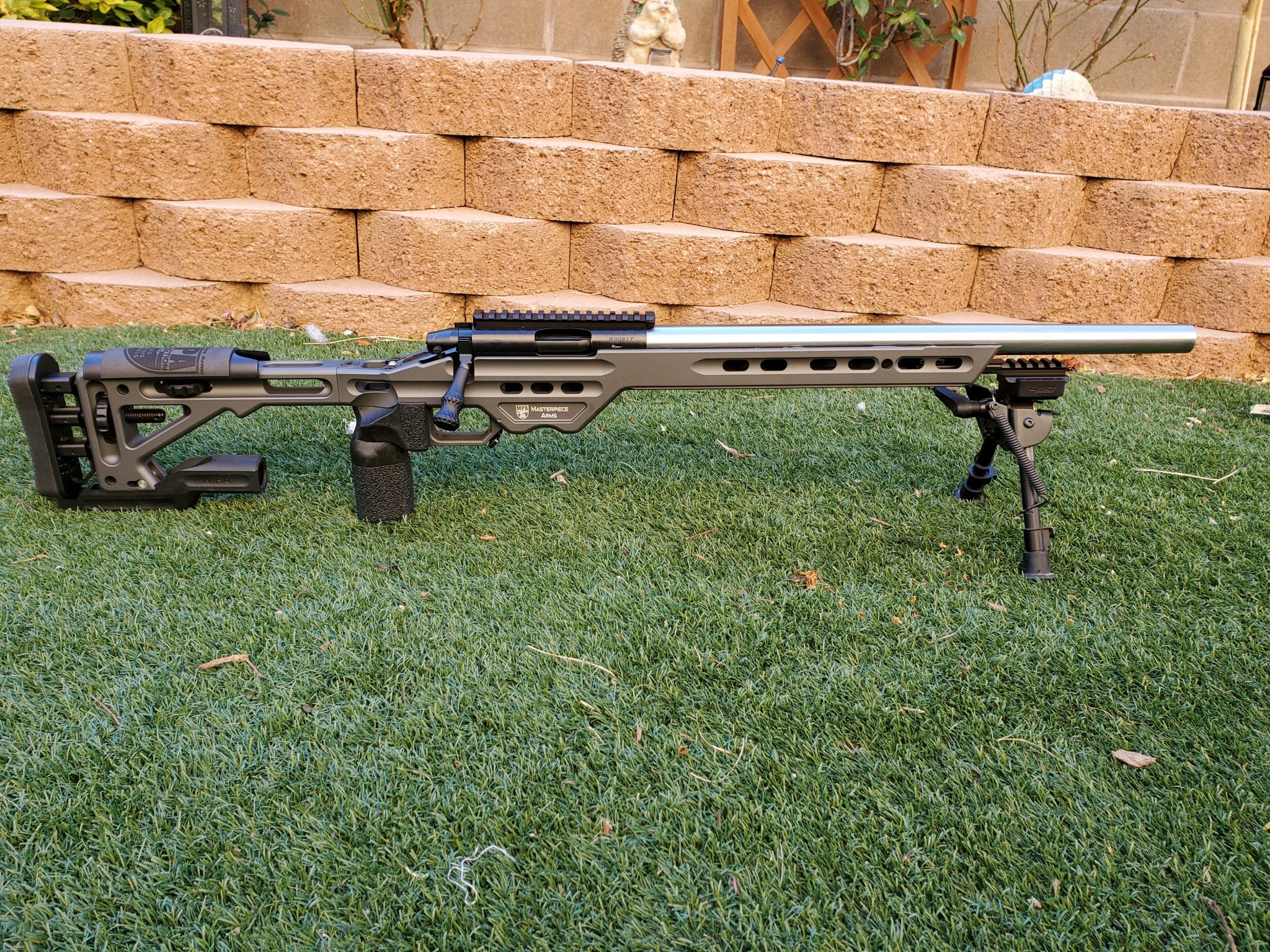

On mine I've installed the keystone GM barrel. I'm 58 and shoot my first NRL22 style match ever yesterday, the RimX runs flawless without any hiccups at all !
The shooter not so much, but that is a different story.
