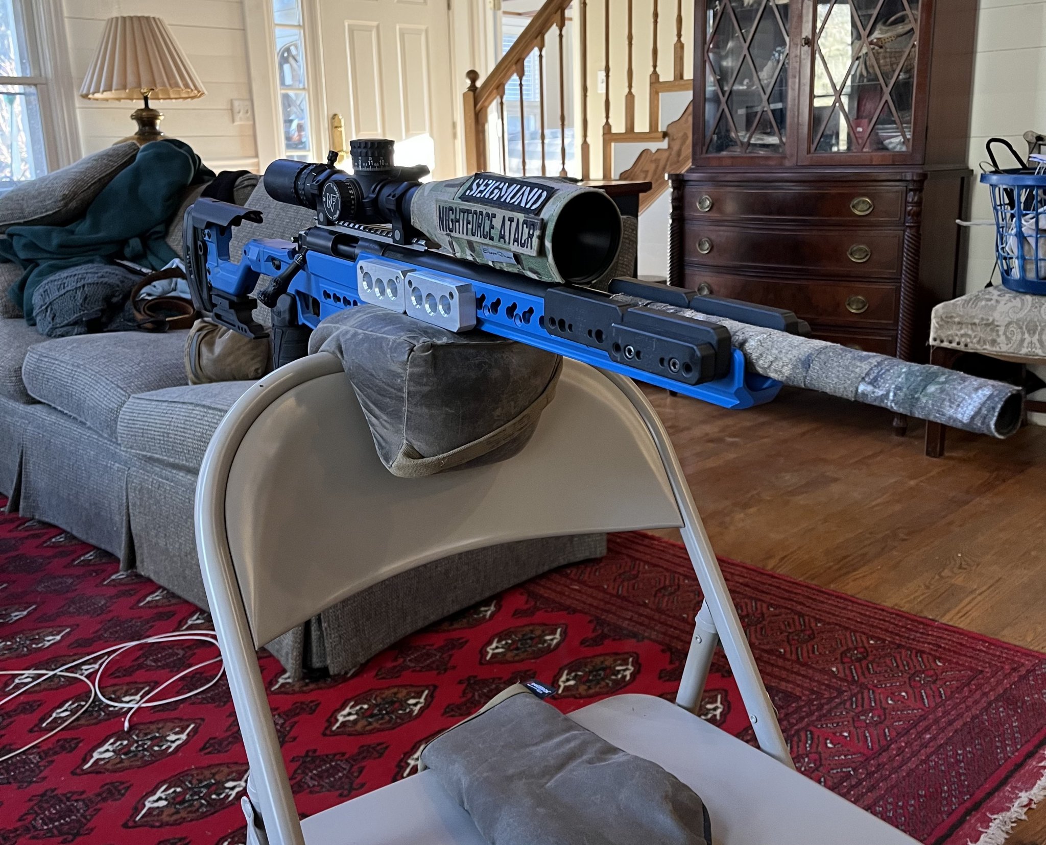

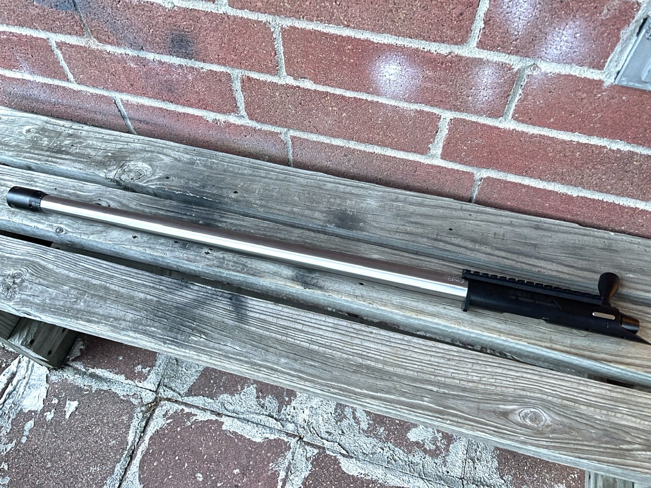

View attachment 7799931Got the goods in. Thanks to Primal Rights for getting the barrel out. Time to get her squared away for Saturday’s match. It’s going to be stupid cold for us here in SE Texas this weekend.

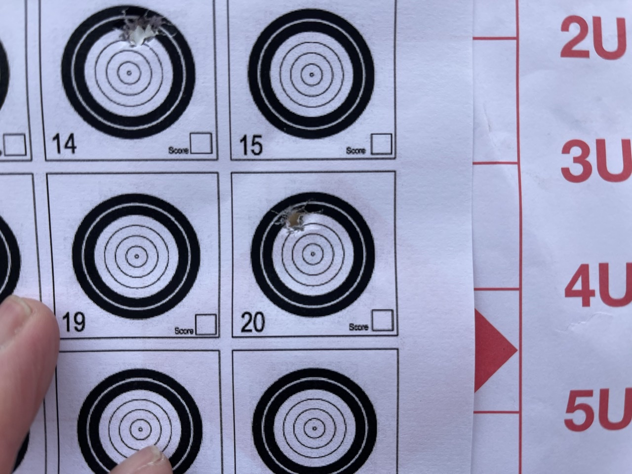

I didn’t do a 6x5 but this was the best I could muster today. I was re-tuning since conditions were much better.

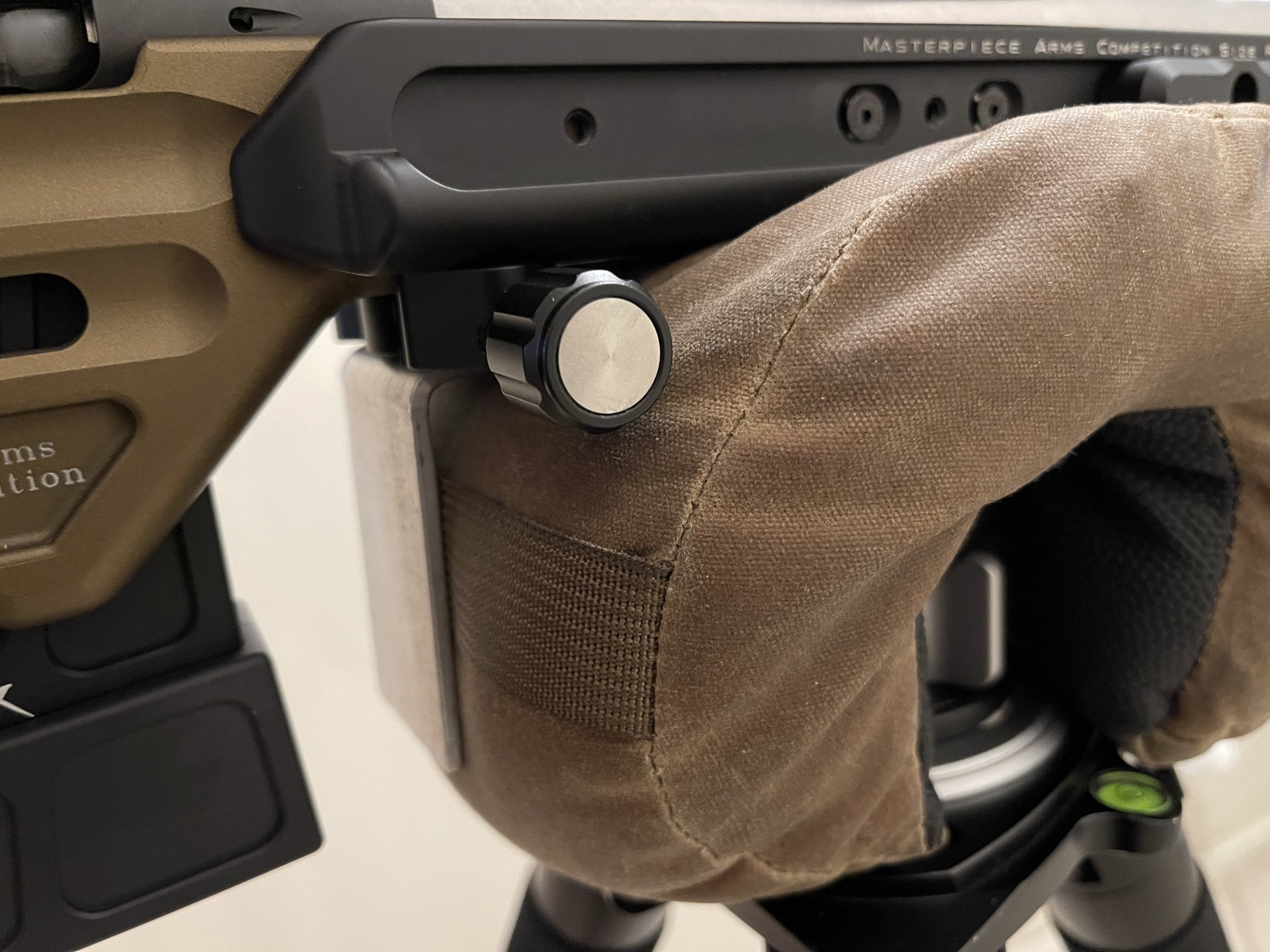

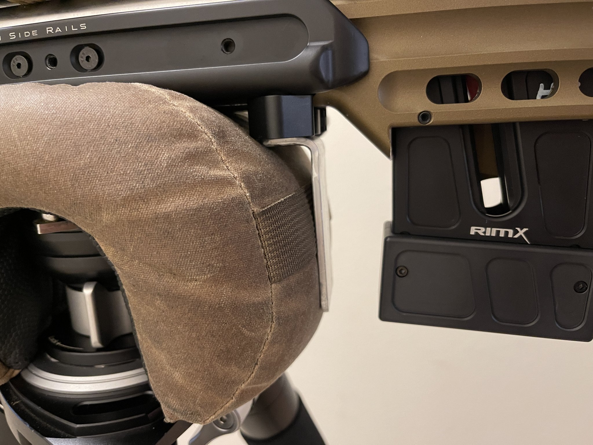

Spent less than $20 to rig up a barricade stop in about an hour. I’m not the first one to make something similar but I did decide to use a smaller clamp instead of a full size one. It’s very crude but works. I don’t have to worry about jamming a barricade or bag against the mag. I have a Manners PRS TCS coming in this week so it should with it as well.

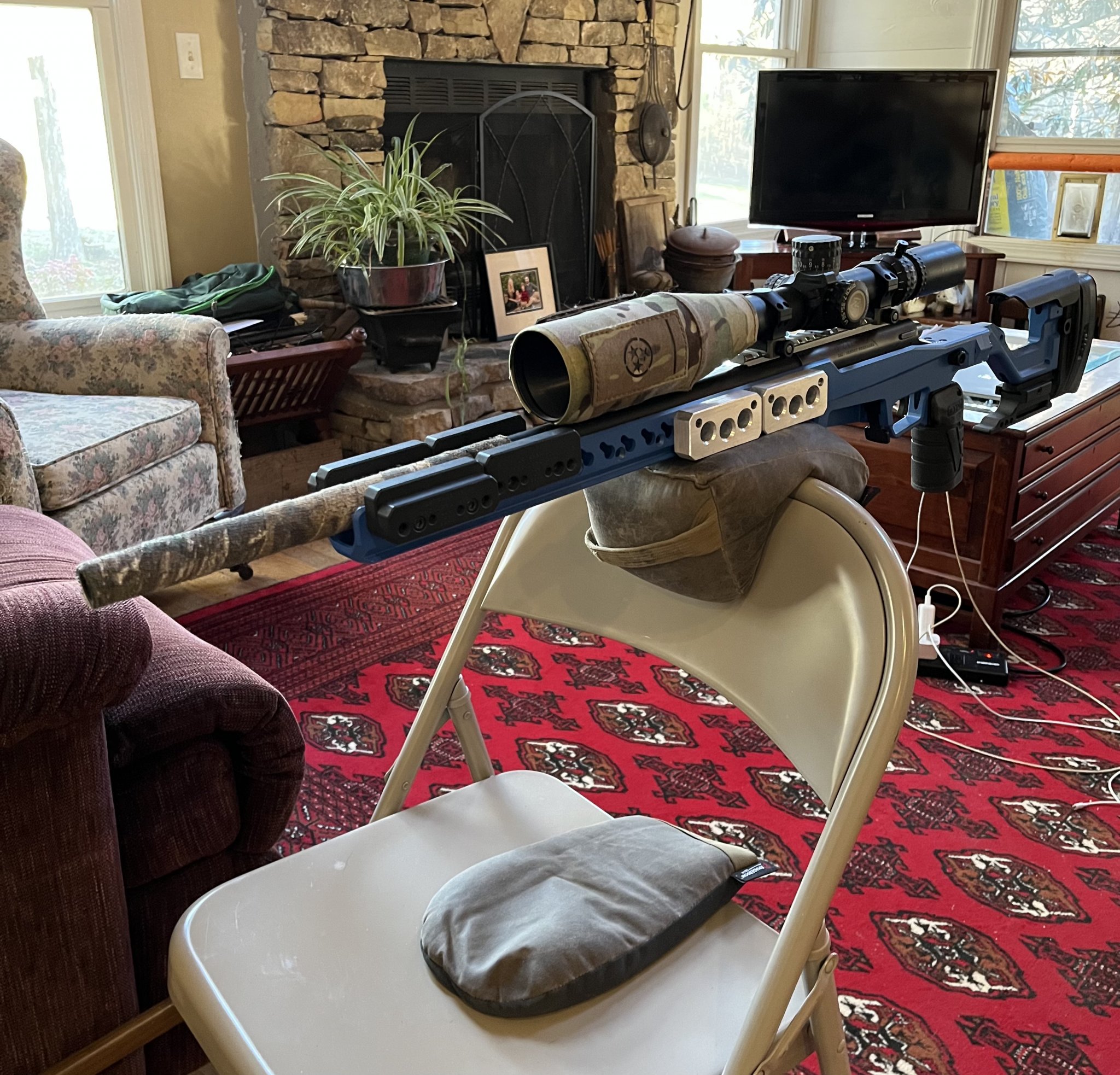

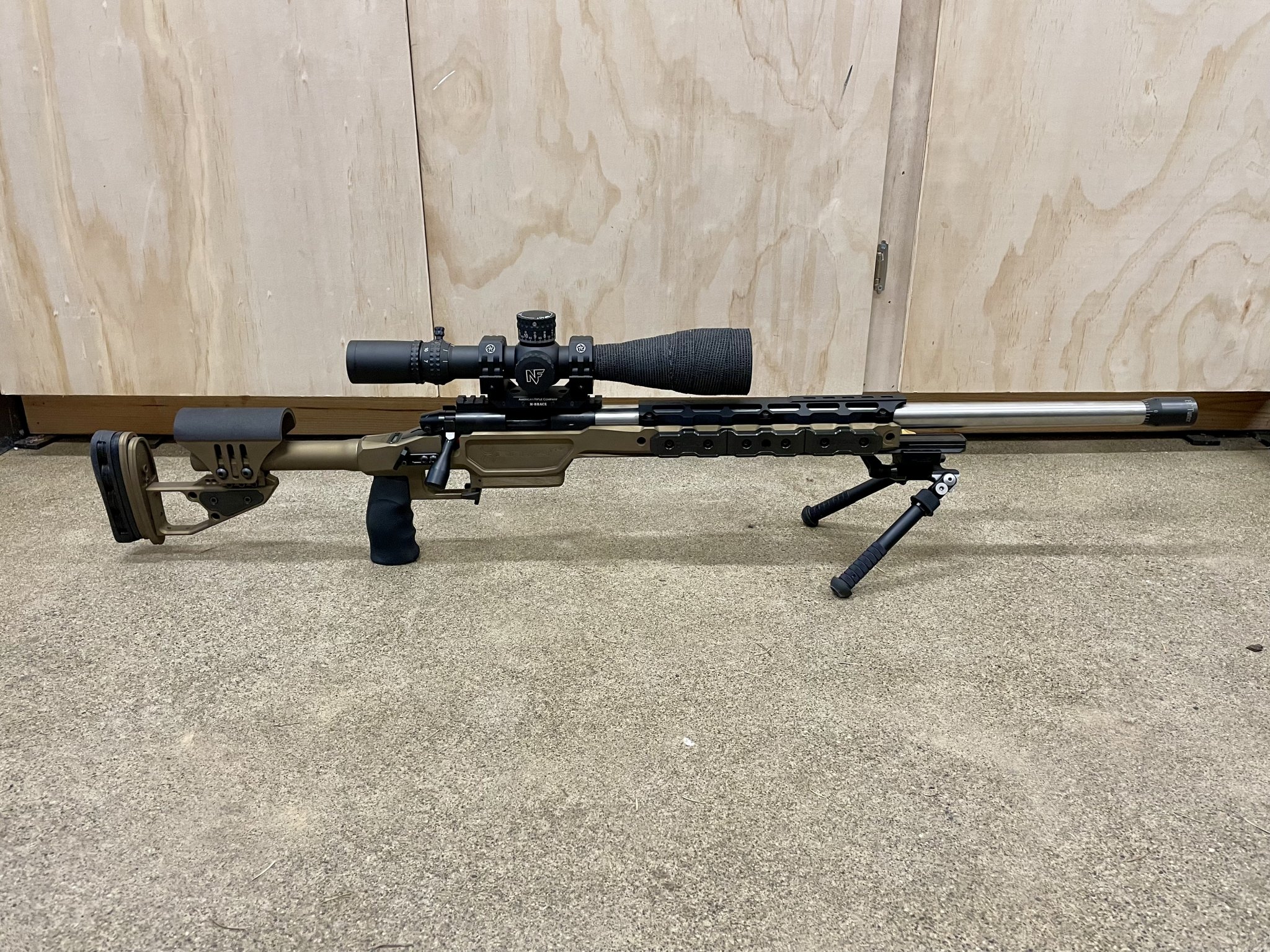

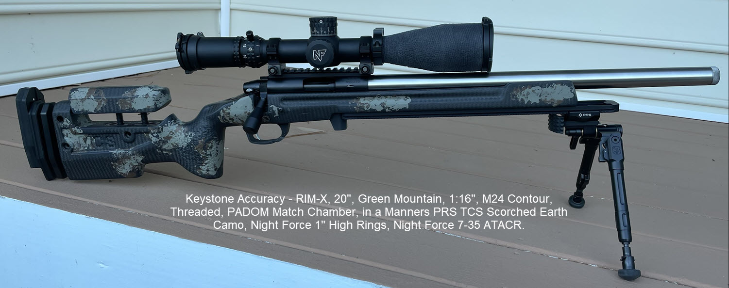

You mentioned a PRS TCS..... Hope this gives you some ideas.
My Rim-X with a 20" Keystone Accuracy 1:16, M24 Contour, Threaded, PADOM Match Chamber, in a Manners PRS TCS stock "Scorched Earth" camo, with a Night Force 7-35 ATACR.
Once life settles down I'll get a chance tweak the balance and zero this rig....

@021411 -- I've added some descriptions to the photos. You can also get the weights directly from AREA419, 419 is the manufacture for the brass weights. Post up a few pics of the SEDONA camo for us to drool over! ;)
@MilSpecOkie -- For the RIM-X I snagged the barreled action "special deal" Keystone Accuracy was running back in the November / December time frame. It's a 20" Green Mountain 1:16" M24 barrel with the PADOM match chamber. Also it has a 2 stage BIX'n ANDY trigger (low sear) installed.
If you need to get longer posts for the Manners PRS TCS cheek piece, KMW Long Range Solutions LLC is the manufacture of the cheek piece hardware. The cheek piece hardware is their LOGGERHEAD ACP. You can purchase extra long posts from them at $11.45 a set.
Extra Long Logger Head ACP Posts

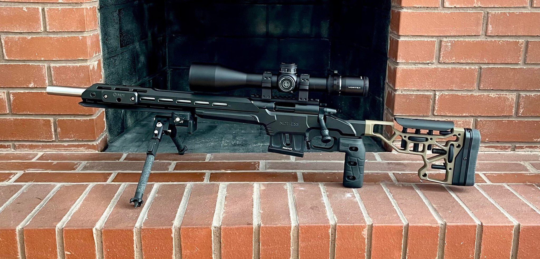

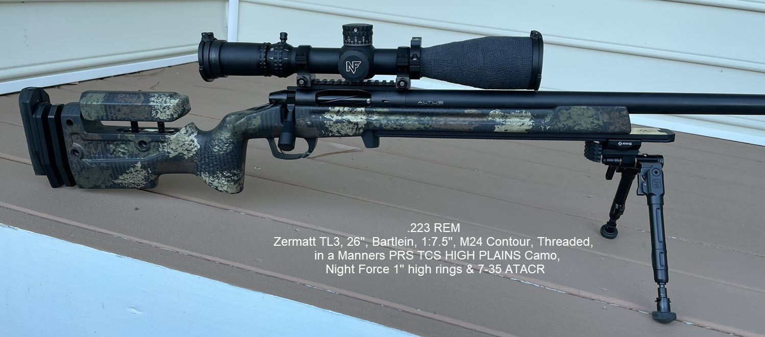

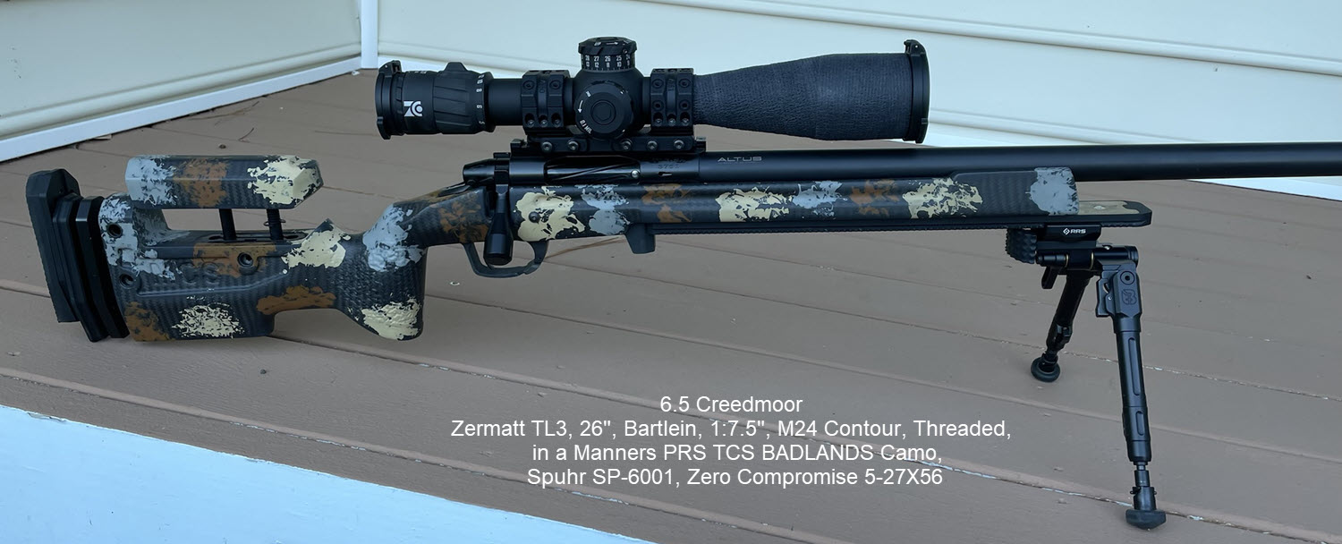

Added two more photos of my other rifles in the Manners PRS TCS stock, descriptions are on the photos. The 6.5 CM is in the BADLANDS camo, the 223 REM is in the HIGH PLAINS camo. All three rifles have the same barrel contour, M24.... This will give you some ideas on the different colors in the PRS TCS.

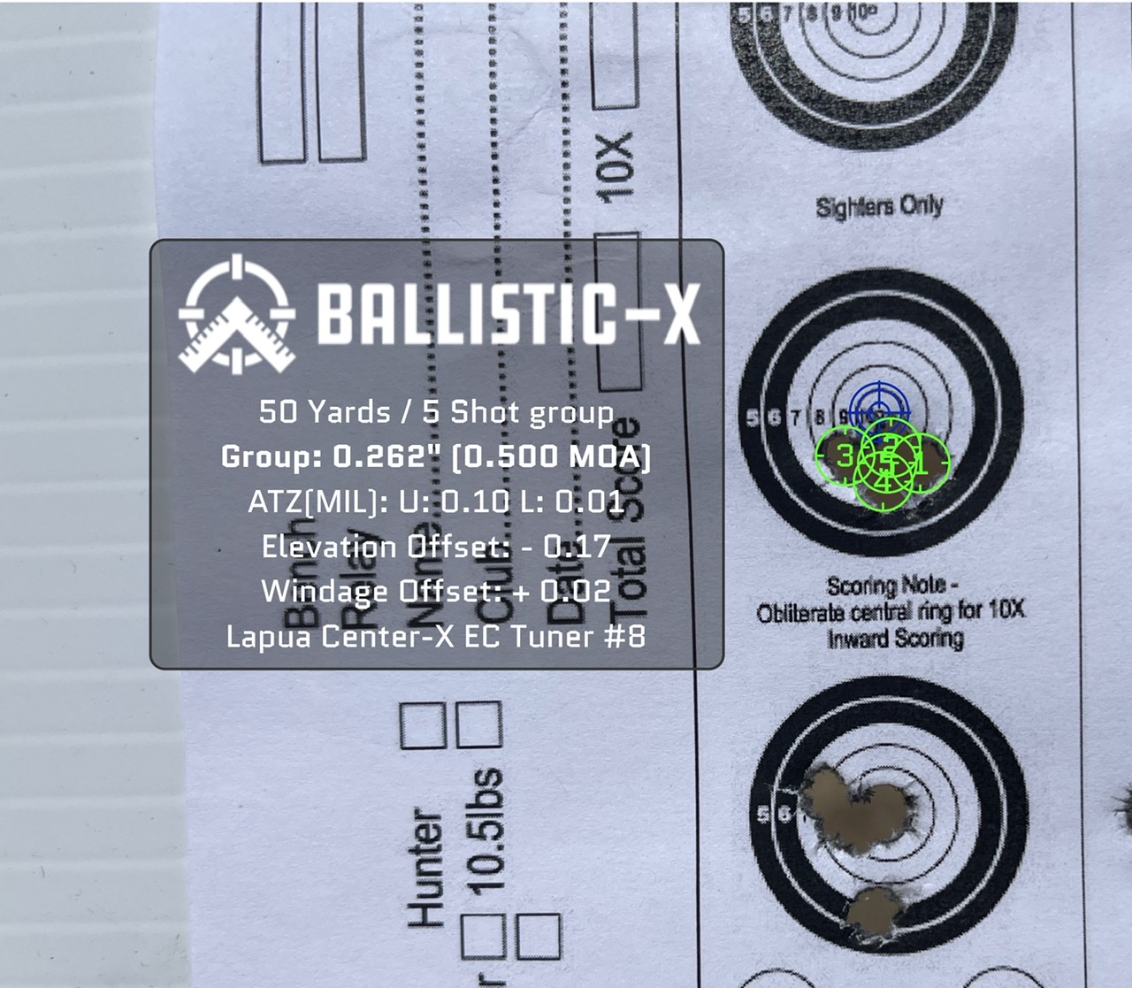

Here are some examples of a PVA 20" Barrel, 1/12 twist, bentz chamber?, ATS Tuner , Atlas Bipod, Rear Bag, Prone Position approx 50- 55 yrds.
I did not clean barrel during ammo change. Very little to no wind. 19-20 F , Sightron SIII 10-50 Scope @ 30X.

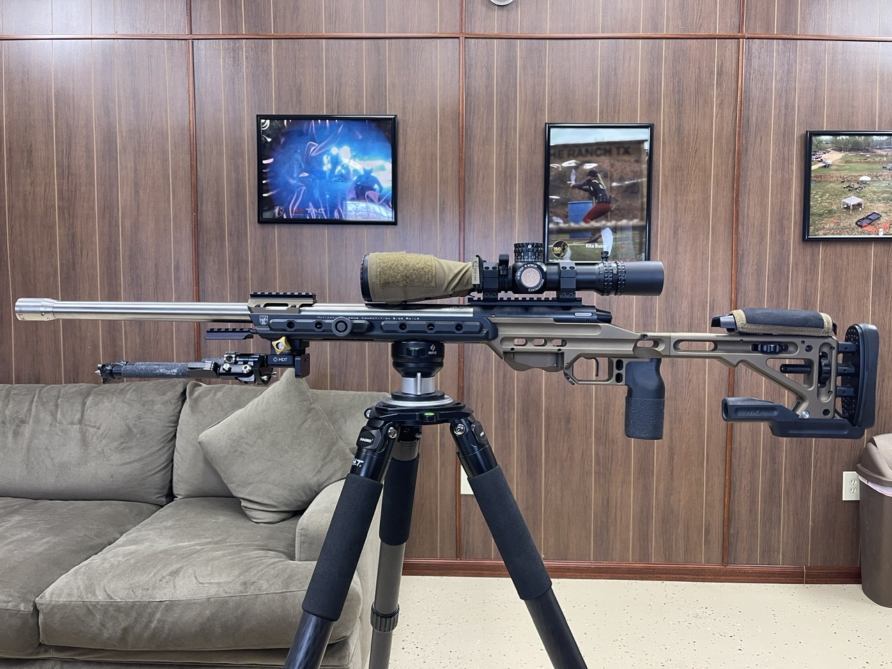

Took a class from Chris Simmons, came to the decision the right chassis checked all the boxes. Retired my McMillan M40A1.
RimX action, Bartlein barrel smithed by Travis Stevens TS Customs, XTSP Mod 22, two stage trigger, Murphy Precision 30 moa base, Nightforce ATACR 7x35x MilC, Accuracy International AT-X AICS chassis, WinTac weights. Homemade stabilizers (aluminum gizmos on top of the Gamechanger) Lets go shoot:)

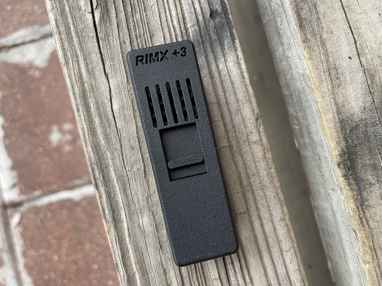

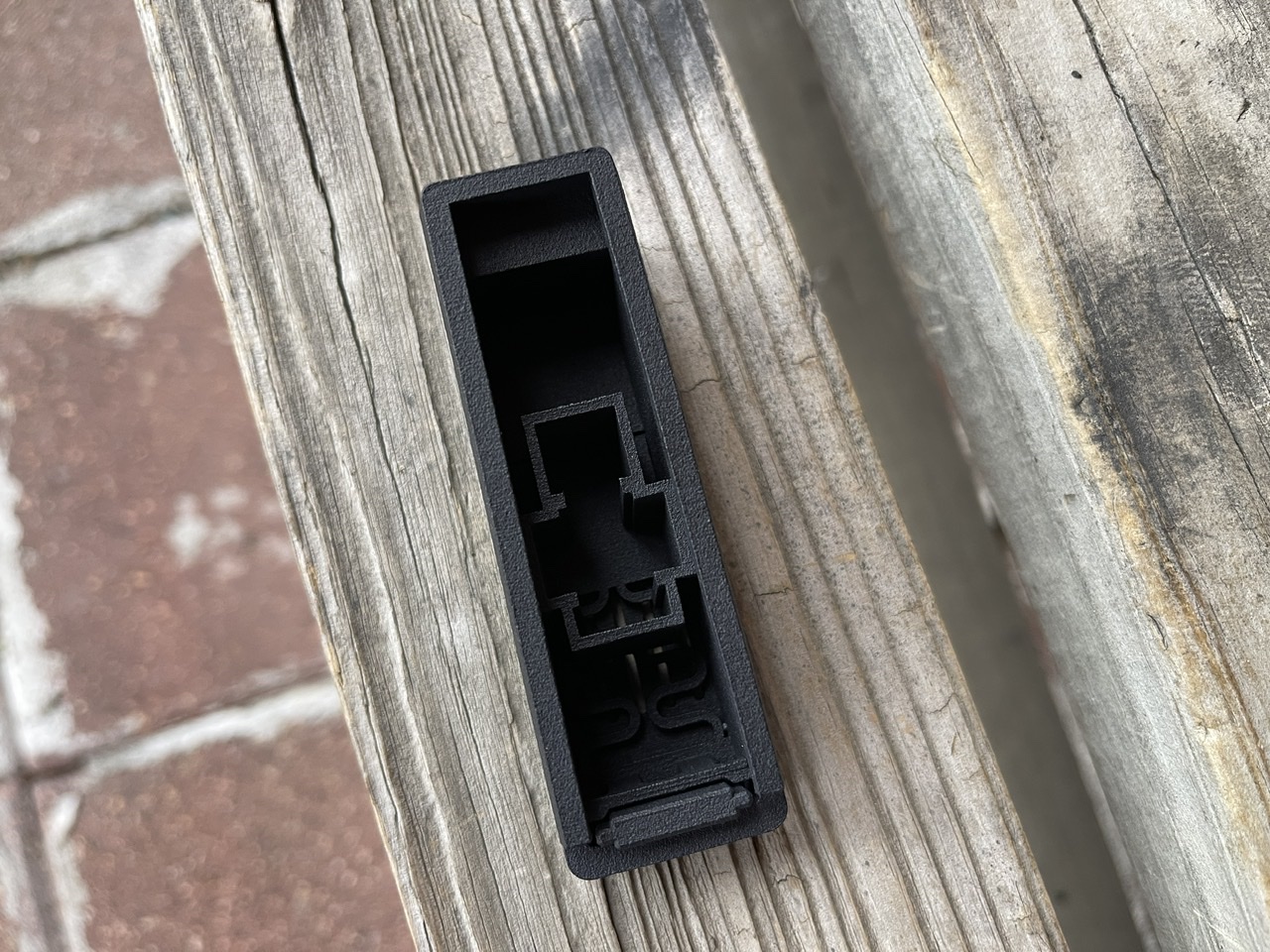

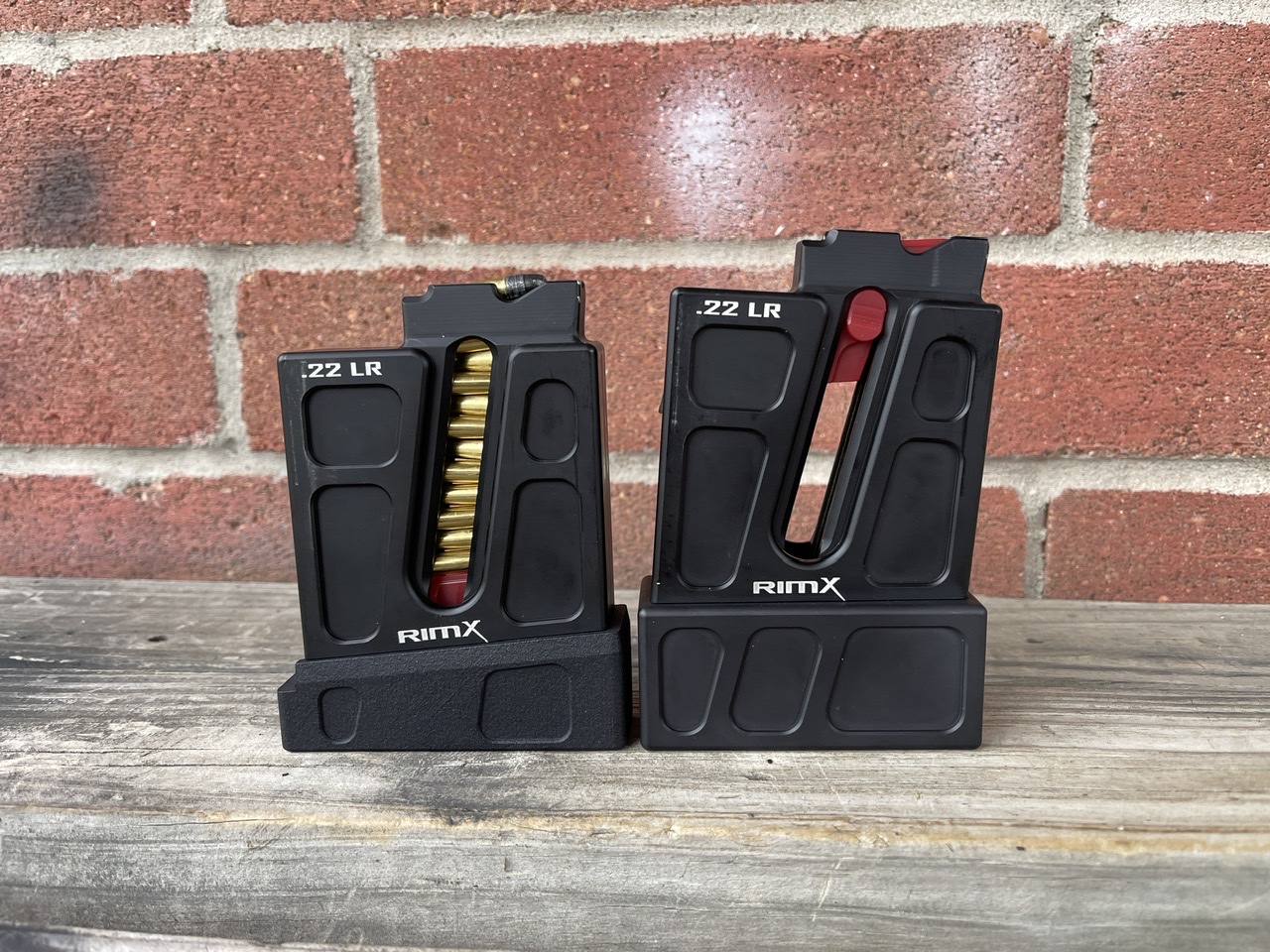

I was always curious about how the MK +3 extensions worked. Pretty nifty. There’s a trap door for the spring after the extension is installed. Fits 13rd no problems.

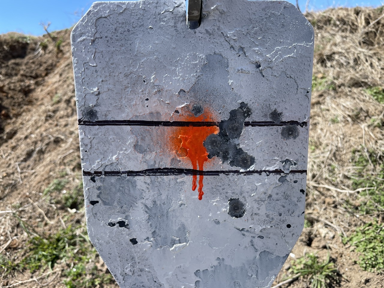

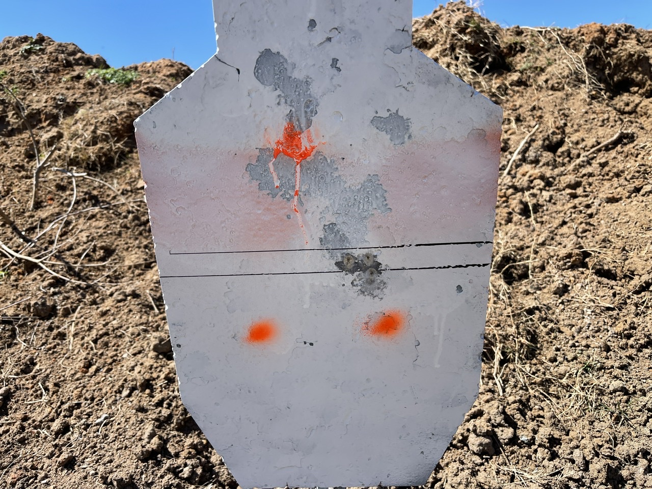

Nothing earth shattering but did some MV tweaking today and checked the dope. I have a match coming up and wanted to fine tune my dope a different way just to see this time. Top target was at 100y with a 6 mph left to right. Waterline is about 3/4” in height.
Bottom target was at 199y with same wind. Waterline is a smidge under 2” in height. The dominant cluster has 6 rounds in it.

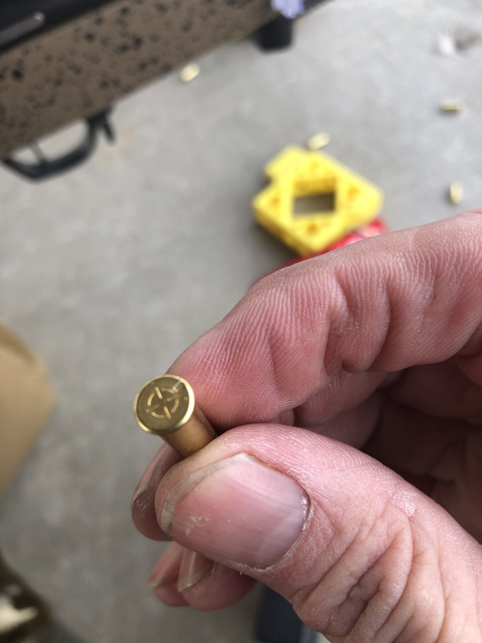

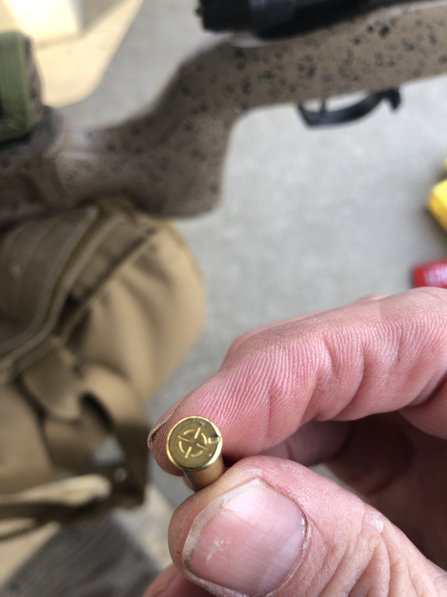

Went from mpa chassis to stock today, while test firing at range 17 of 50 rounds did not fire, they have marks on rim but would not fire. Lapua and sk ammo, is this a mag height issue? Rounds come off mag and chamber fine just no firing.
All you did was switch from a chassis to a stick and things stopped working? No other changes? Trigger etc
