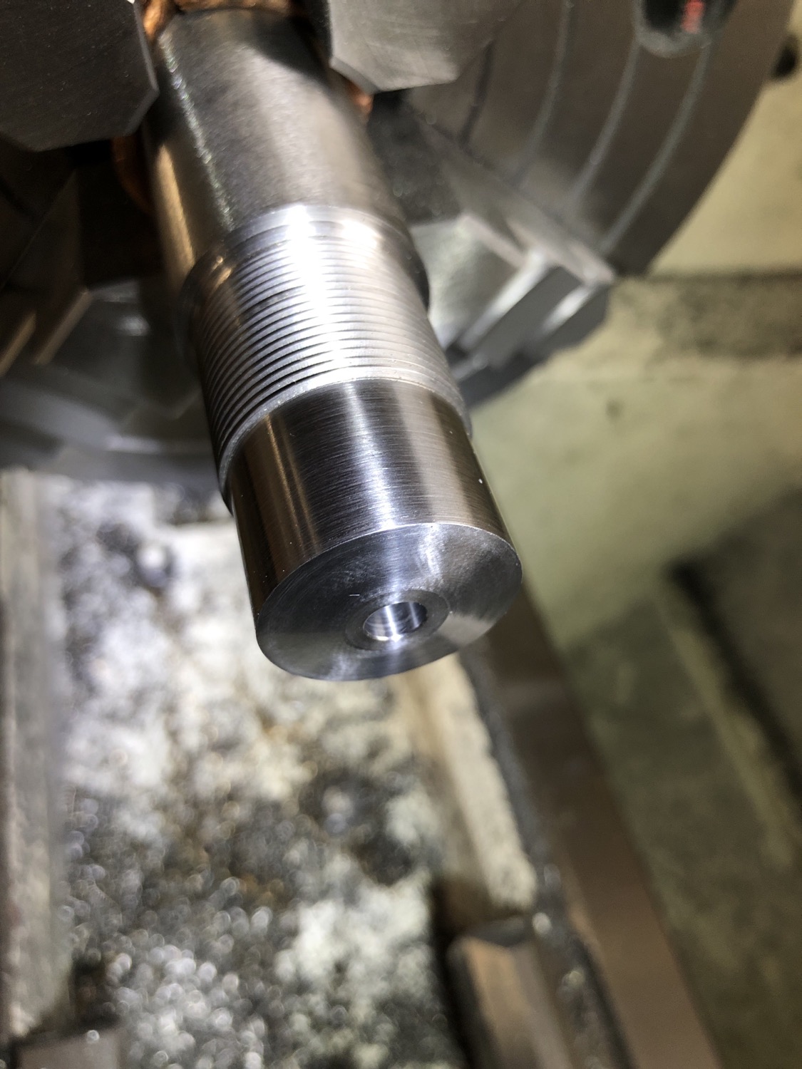

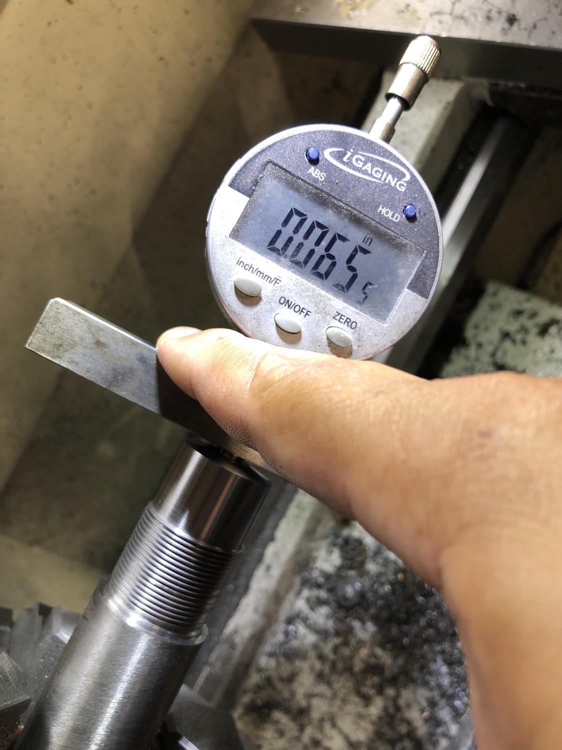

I just finished chambering & installing a Keystone Accuracy contoured GM blank on my Rim-X. I'd purchased a couple of 1.20" dia straight cylinder CM blanks about a year ago, and finally got around to sending them to John at Keystone to have them contoured on his cnc lathe. I went with his Palma sport contour, which is essentially a heavy Palma with a large radius transition from the shank, instead of the normal Palma double taper transition. I had him do one of the GM blanks with the shank fully machined/threaded for the Rim-X, but not chambered, while the other one is just the Palma sport contour.
I went with the blank with John's cnc-produced Rim-X shank, and used my Eley EPS reamer to cut the chamber, then finished it at 23.5" with an 11* crown, and no threading. First time out, it shot OK group-wise, but I kept getting rounds knocked out of the extractor as I was closing the bolt, which requires opening the bolt and picking the loaded round out of the bbl - would estimate this was happening about 30% of the time. Since I'd had very few issues of this happening after I'd adjusted the mag latch height to work with the previous bbl, I thought perhaps the problem was connected with how tight the body of the EPS chamber is, and decided to pull the bbl and run my JGS carbide Win 52D Match reamer into the EPS chamber and see if that would solve the issue. The 52D chamber is .2278" at the rear, and tapers to .225" at the front, while the EPS is .2252" straight, with no taper to the front. The EPS is also .020" longer than the 52D, with a length of .600" compared to .580", and since they both have a 2* leade angle, the 52D reamer didn't re-cut the existing EPS leade. I simply re-cut the chamber by hand while the bbl was still in the bbl vise after removing the action, using Mobil Sigma cutting oil. I took three passes, removing the reamer and blowing the chips & oil off after each pass - it was a little surprising how much metal was cut, but it went very smoothly and required very little effort. I sprayed some brake & parts cleaner down the bore after finishing, then blew it out with compressed air, hoping to avoid pushing any sharp chips through the bore when I wiped it out with patches afterwards.
Whether my diagnosis of the problem was correct or not, re-cutting the chamber evidently fixed it, as I ran at least 50rds through the rifle without another single issue. I was also pleased with the accuracy, though oddly enough, it shot best with an exceptional lot of SK Std+ & SK LR Match, neither of which have ever shot as good in any of my other custom barreled rifles. Next time out, I plan to try some Eley Match in it, as the black box Eley shoots better in both of my CMP 52Ds than any of the SK/Lapua that I've shot in them.

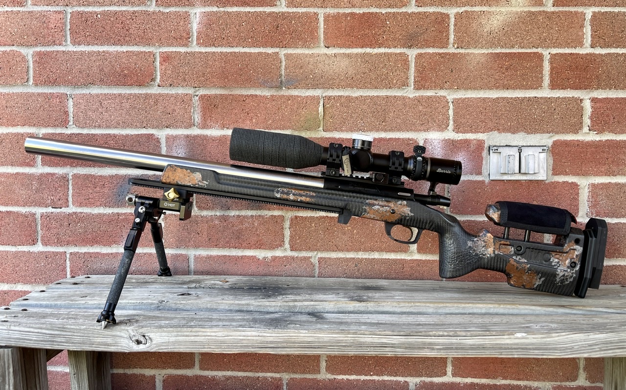

Just screwed my Krieger back on after shooting the latest GM for a while and it hammers one hole just like it did before I pulled it off...

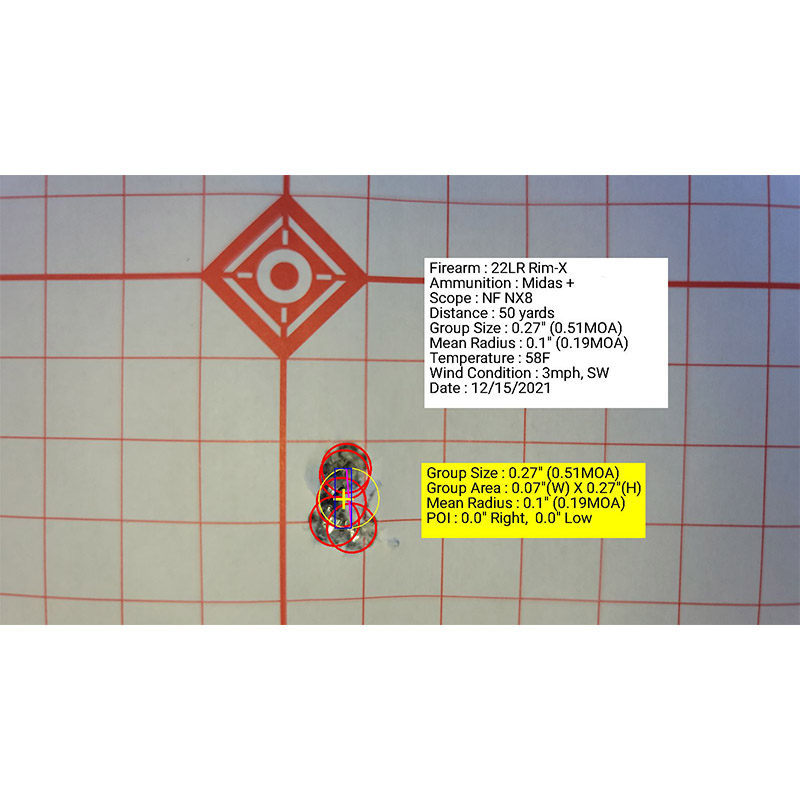

Today was my first range day with the rim-x. I got interrupted with a work emergency, so I only fired 50 rounds, but boy I was pleased. Sorry no pictures and I'm still waiting for the bottom metal for the foundation stock so it's temporarily in a bravo.
For those wondering, I put this together in my basement. I spent about a half hour tuning 3 mags and they run super slick. I shot with 2 guys at a match a few weeks ago that were having troubles with feeding if anything touched the front of the mags. So I payed special attention to this, and I had to add a piece of velcro to the back of the mag to keep it from nose diving if I pushed it into a bag.
I'm using a Primal Rights/TS customs benchmark barrel with the EC tuner. I haven't played with the tuner at all and this is already the most accurate 22lr I've owned. Can't wait to put more rounds down range.

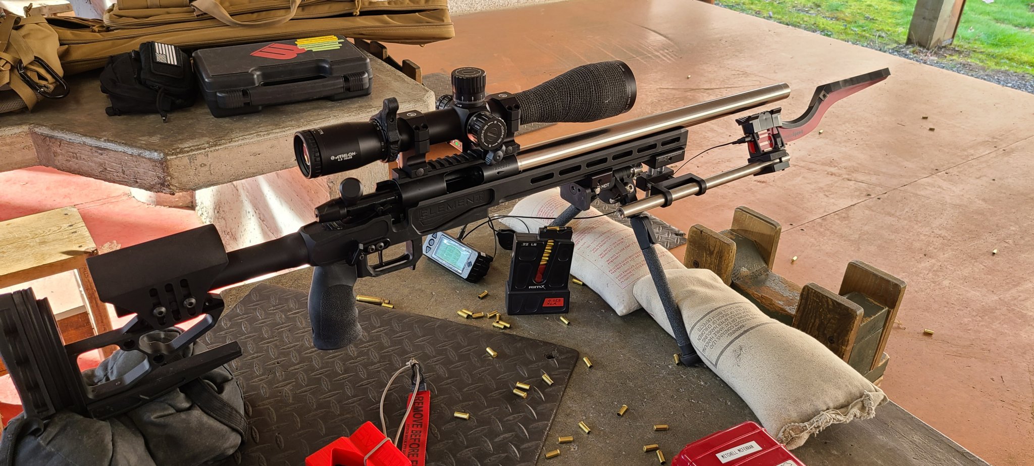

I don’t know how handy you are or what stock/chassis you are using but you can make yourself a barricade stop to protect the mag.
You can see the stop I made protecting the mag from pressing against the bag. The TS/Primal Rights barrel isn’t pictured. I’m messing around with a Krieger right now.

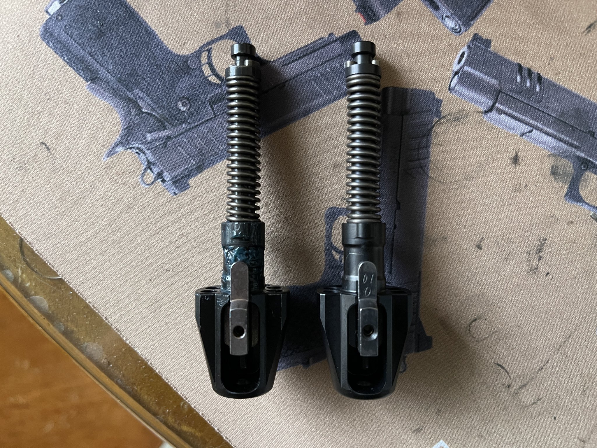

I was sent a firing pin assembly that increased pin travel by 0.010” after troubleshooting some things first. This “fix” might be old news as I didn’t search this entire thread.
If you’re an Eley shooter and plagued by light strikes I would reach out to Zermatt and work out a solution short of not shooting Eley altogether.
