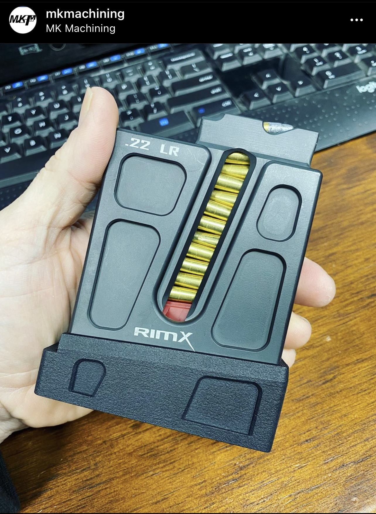

I don't know. MK just posted it on his IG Feed. I sent them the magazine for design.

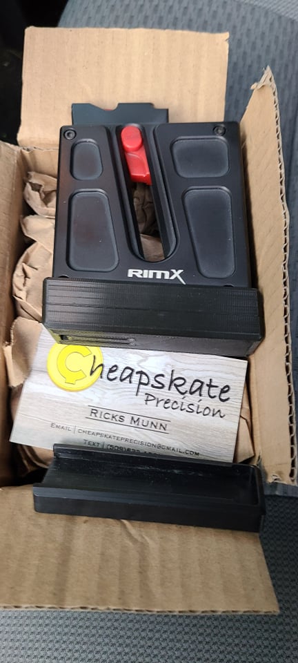

I've got a Zermatt plus five and some new 3D printed ones in a plus 2, 3 and 5 from Cheapskate Precision. I've had zero feeding issues with any of them so far. Springs are a wear item though and I definitely will be looking at sourcing some replacements for the future.
