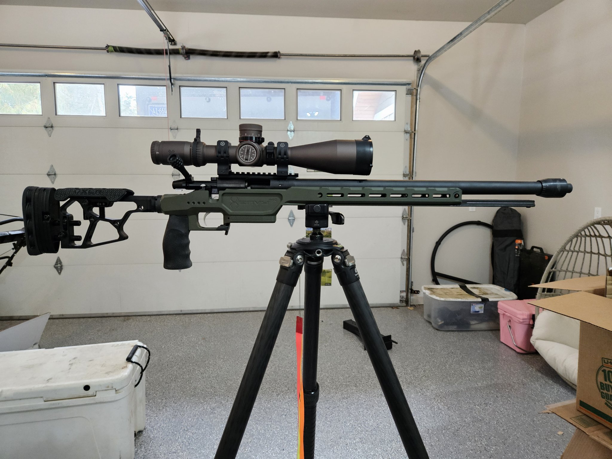

Finally jumping on the 22LR bandwagon. Got myself a RimX action, Modacam barrel and dropped it into a Foundation Exodus with Bix-N-Andy trigger and Hawkins bottom metal. Just need to throw a scope on it and take it to the range to see how she does. Will be fun to shoot some 22 matches alongside all the centerfire stuff.

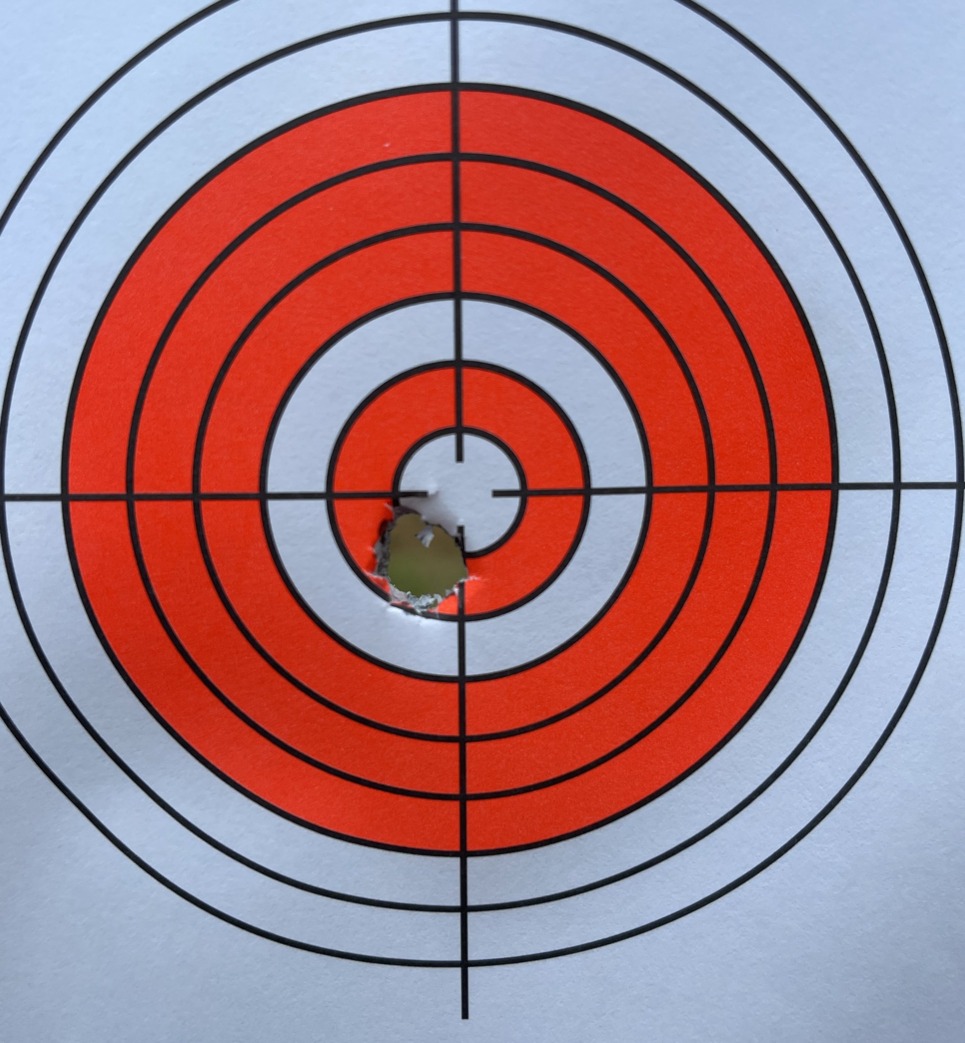

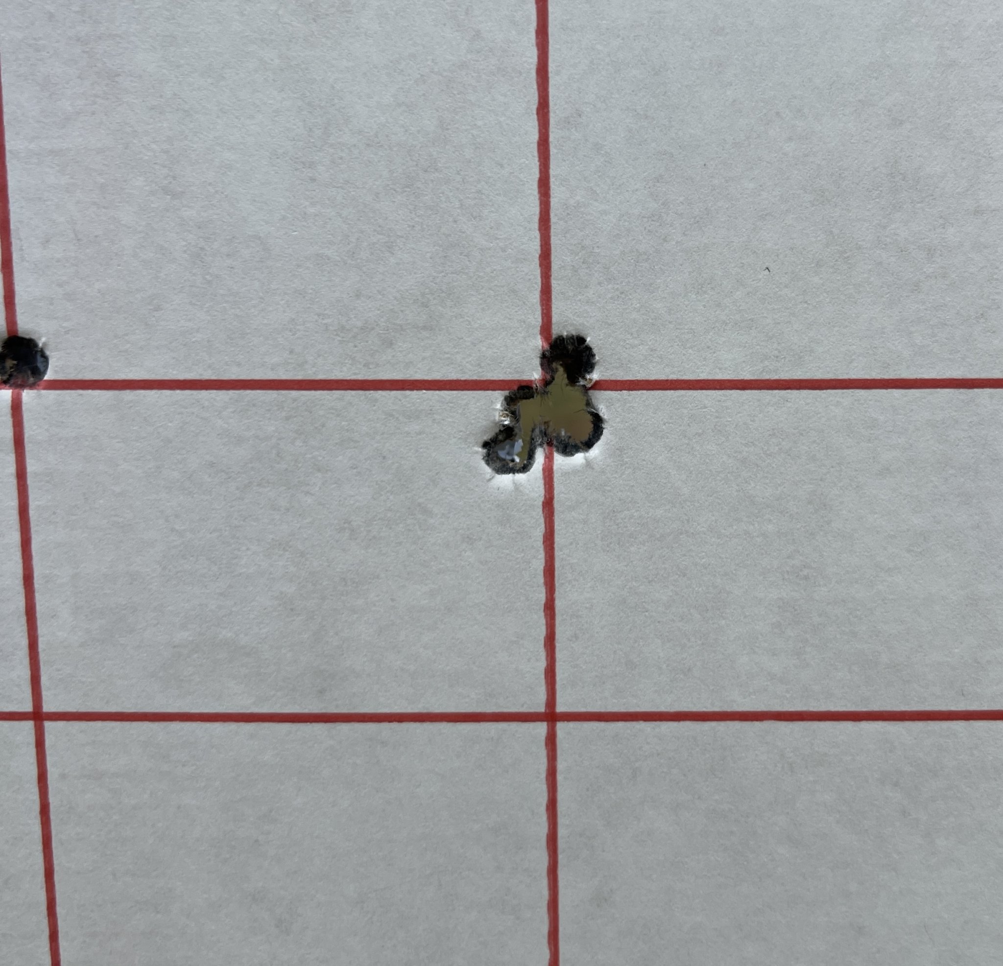

Got my Dead Air Mask in a month ago and finally made it out to the range. During the wait I sent off my well seasoned Primal Rights/TS Customs barrel out to get chopped and threaded from 26” down to 21”. Below are the first 20 rounds with the can, 10 and 10 at 50y. I had to adjust the zero because the scope was on another rifle.
With all that said, 262y wasn’t confident inspiring. Seemed like it was a little everywhere at that distance with a 6” plate. The barrel is a 16.5 twist. Ammo used was SK LR that does really well out of my Keystone barrel.
Cutting the barrel down is, most likely, the reason your groups at distance aren't as good or consistent as they may have been before.
Oh I know. Shot a match with it on Saturday and did okay. I wasn’t confident with it but wasn’t bad. I threw my Keystone barrel back on after as soon as I got home.

View attachment 8097783View attachment 8097784Got my Dead Air Mask in a month ago and finally made it out to the range. During the wait I sent off my well seasoned Primal Rights/TS Customs barrel out to get chopped and threaded from 26” down to 21”. Below are the first 20 rounds with the can, 10 and 10 at 50y. I had to adjust the zero because the scope was on another rifle.
You can't just cut and recrown a barrel at a random length and expect it to shoot! It should be slugged to find the tightest spot and cut and recrowned at this point. Threading doesn't help accuracy either as it opens the bore at the very spot you want the bore the tightest.
It’s fine. I’ll relegate it to 200 and in shooting when I want to shoot with a can. It still hammers at 50 and I was still stacking at 100.
While I don't disagree with what littlesister said I have not had enough barrel experience to say that it is true without a doubt. I have read many times of manufactures "choking" barrels through lapping or other methods to induce a tighter bore near the muzzle and number of gunsmiths echoing the same sentiment. The intriguing thing I find is that if the statement is true would that not mean that any barrel shortening needs to be done from the chamber not the muzzle ??
Good point. Anyone who ever tried to shorten a Anschutz barrel will tell you, you only shorten from the breach never the muzzle . This would hold true for any barrel if you know the choke is where it's supposed to be. I recently had a barrel shortened 3 ins because the choke was found to be 3 ins back of the crown. Accuracy was improved. Not night and day difference but a noticeable difference. I'm not saying a barrel That isn't choked in the correct spot wont shoot. Also not saying a threaded barrel won't shoot. What I'm saying is that if you're trying for all the accuracy you can get from a barrel, you cut and crown at the tight spot and you don't thread.

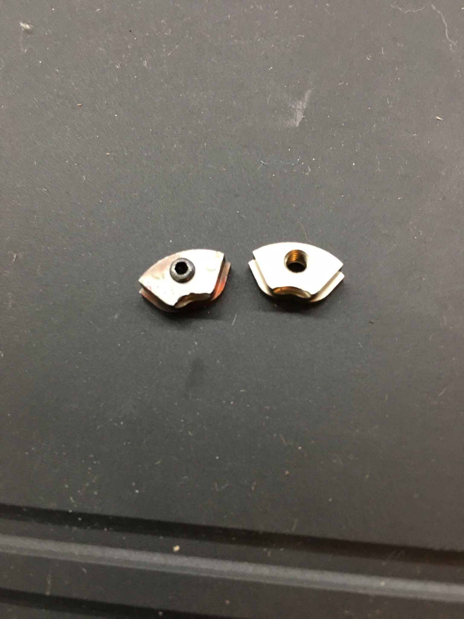

5k? I assume it’s time to replace extractor and tensioner plus spring. How does the extractor look on the edges? Gets easily damaged if you try to close the bolt to hard on a round in front of the extractor.
I have replaced both the extractor and tensioner multiple times. It wasn't until later in the round count I began replacing both after every issue.

Worn vs new
Darn you got some chunks out of that thing... I've got over 10,000rd across various Barrels on my RimX without any issues. Ray did send me a replacement tensioner and extractor a while back but I'm still running the original ones.... going strung and feeding like a dream. XLR Envy chassis
If I remember correctly, the worn “reddish” looking one is out of different material. On the replacement one I’m not seeing this.
Yea I forget. Either different material or different heat treatment. Either way, I got a new one if I need it some day.
Picked up my rimx build last night, dropped it into the envy pro, balances pretty well with the gen3 razor. I'll likely switch to some lighter glass and drop the heavy nose extension, should cut weight by a pound. It's 16.2 as it sits in the photo.
