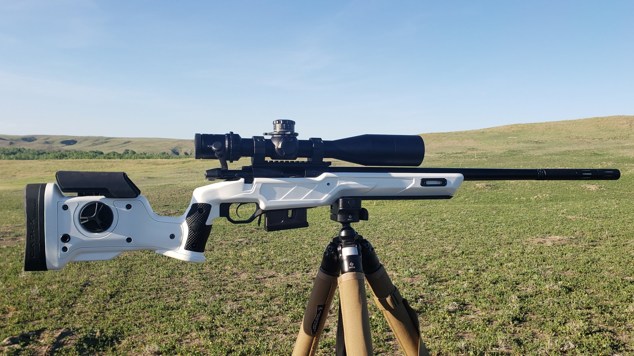

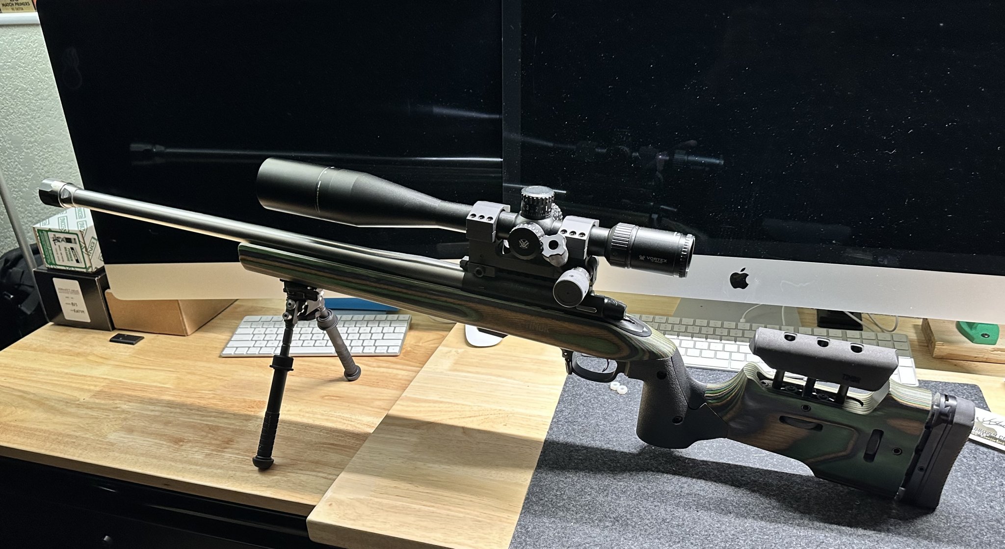

Well I added a rimx to the rimfire collection. The end goal will be a lightweight hunting 22 but just narrowing down the barrel. I was able to snag a 1:14 twist 22” to play with for the time being and have a spare 1:10 twist 22” ks barrel laying around im spinning up as well to play with. Looking forward to this

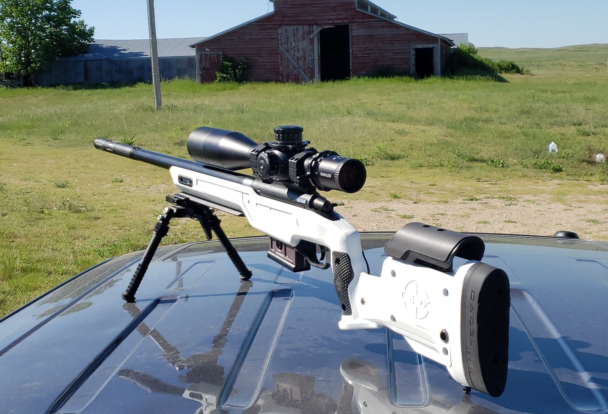

Just got a KRG Whiskey 3 stock for the Rimx that I have coming.... now I need to decide on a barrel. Bartlein, krieger, or lilja...... and a length.
Any thoughts ?
Any thoughts ?

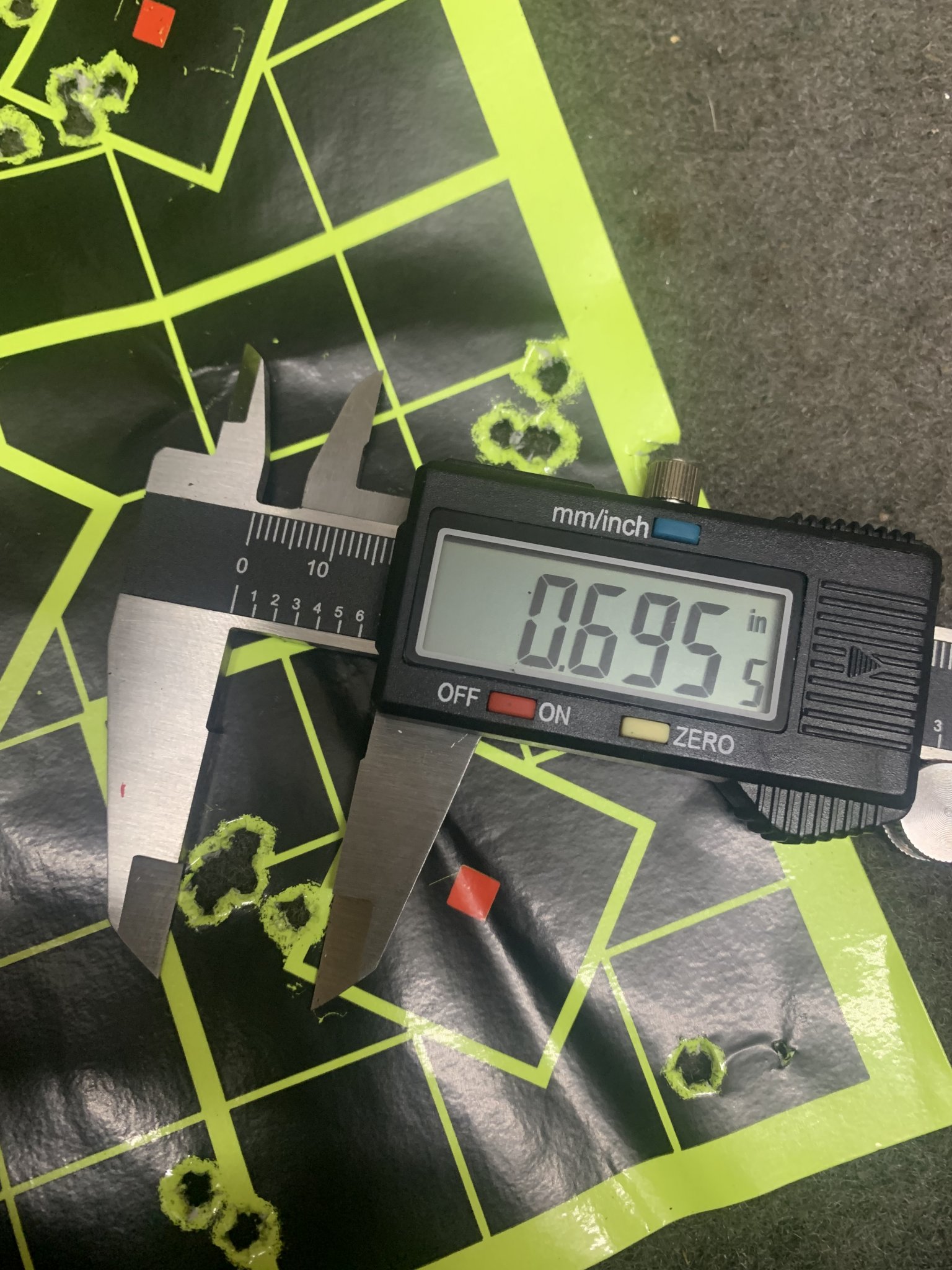

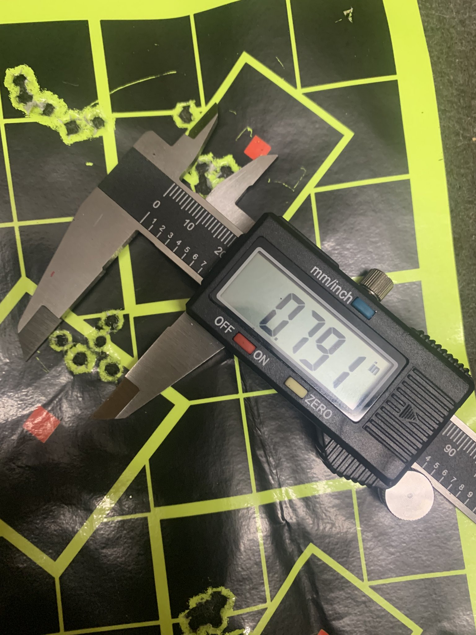

Caught a 51F sunny day today and decided to shoot this Manzella Precision Bartlein RimX @ 100yd. Shot the same lot of CX that shined at 50yd and tested a new lot of R50.
Wasn't as calm as I would have liked with a 7mph gusting cross wind but this R50 really shined!! Looking forward to testing this barrel at 200-400yd in the near future.
All groups we're shot @ 100yd
These are two 10, shot groups with CX lot.. groups measured 0.83 and 0.86
And these are the new R50 lot groups
0.809 - 0.223 = 0.586
This is 4shots before I caught a gust that blew the 5th..
0.437 - 0.223= 0.224 4 shots
0.687 - 0.223 = 0.464
This was the CenterX
0.735 - 0.223 = 0.512

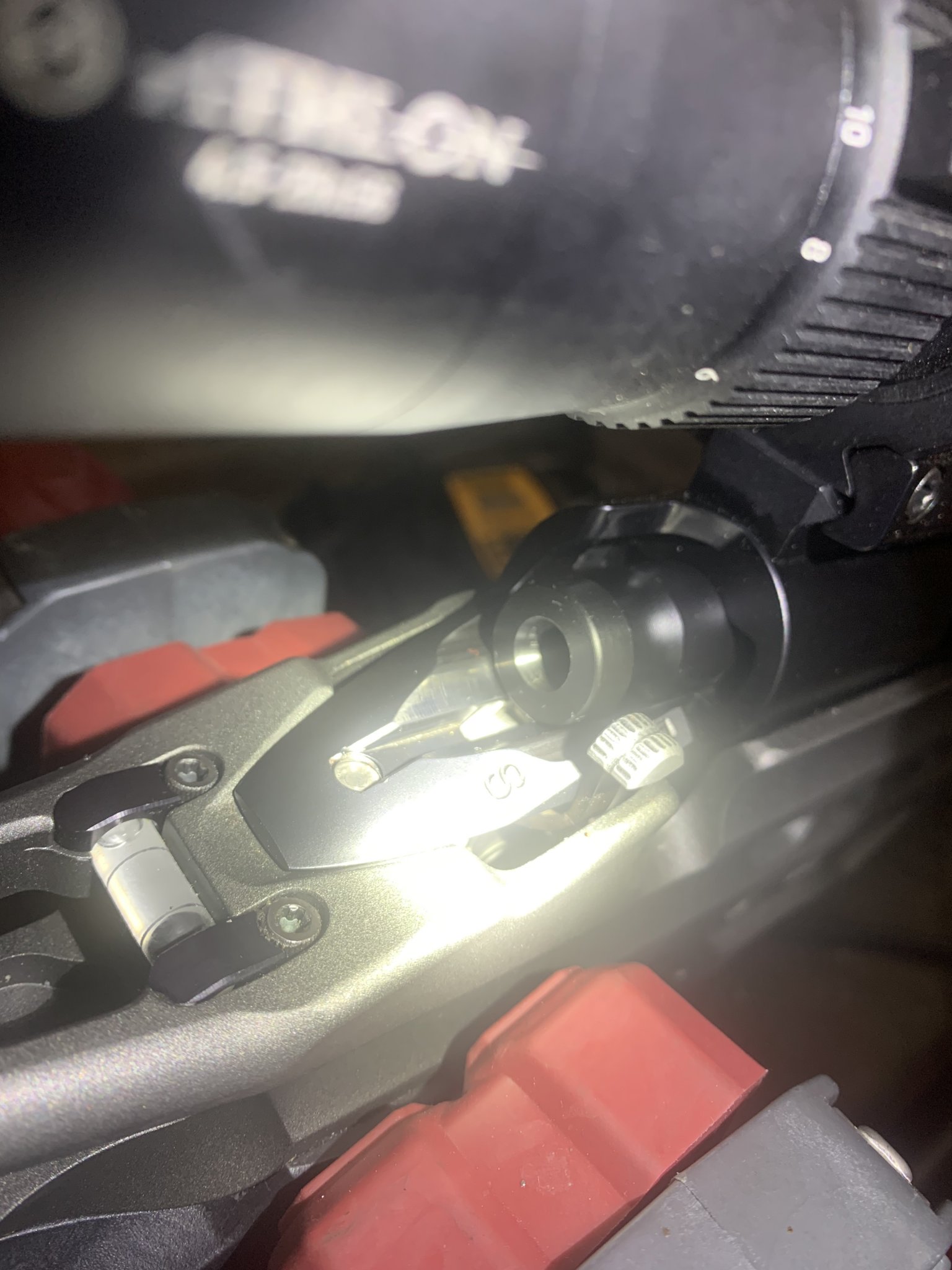

RimX's 6-o'clock-positioned firing pin's open "channel" is prone to pick up lube goo, especially in cold weather. I polished the edges of that channel with 2500-grit automotive sandpaper, insuring that running the bolt left as little marking on the bullet as is possible for a repeater. Again, no improvement in the flyers.

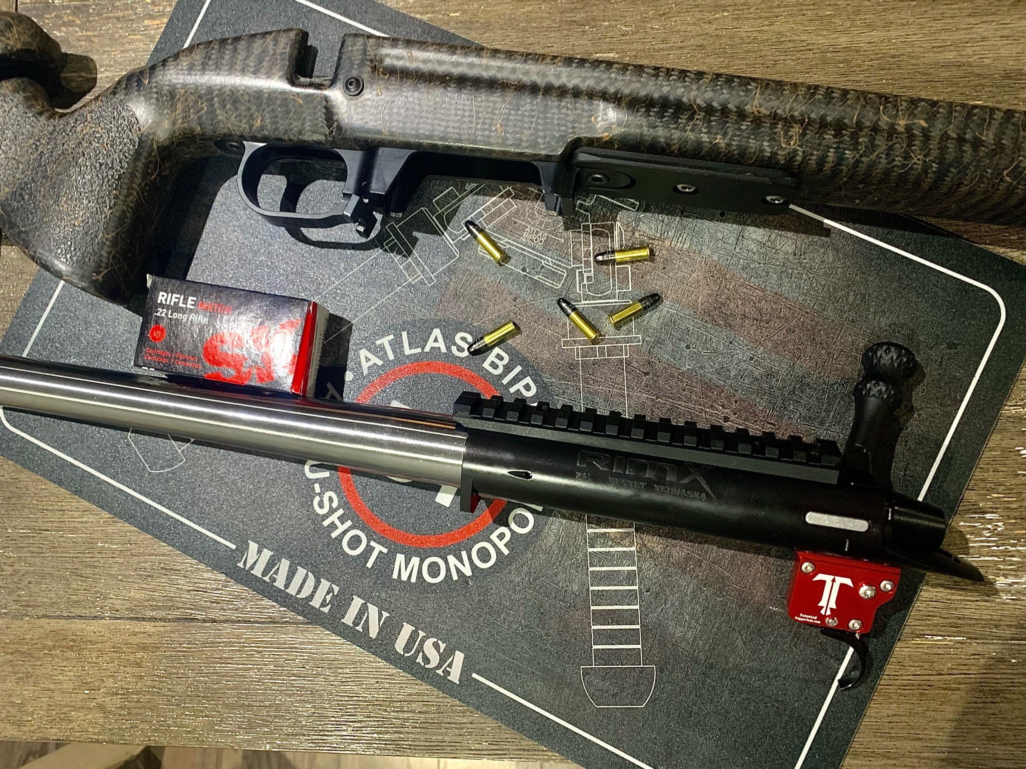

Bartlien barrel showed up to the shop today. Now just waiting for the reviever to show up and I should be ready to shoot. Looks like another month or so before I can get hands on.
I took my RimX out yesterday and tested some Eley Team. Out of the 5 or 6 lots, only 1 was meh. The others produced consistent results from 50 to 300. I would say it is nearing the level of my Vudoo now from an accuracy perspective.
One quick note on the bore guide- I inserted this just for the picture. I will never use it again given the location of that opening right above the trigger. Using a tight fitting jag, I could not imagine a world where any solvent would not get into the trigger. If they had only made it 1” longer…. Great rifle. Pass on their bore guide.
