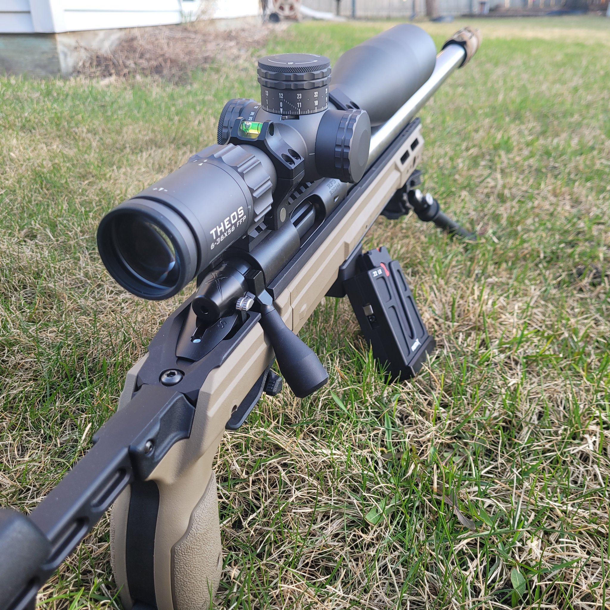

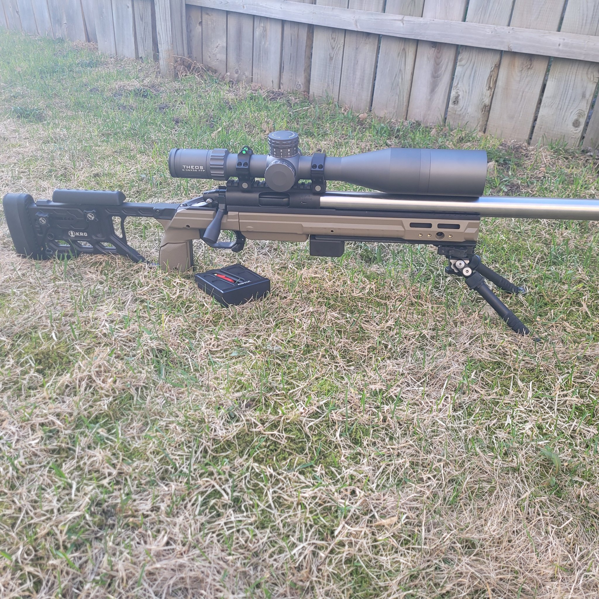

Rifle finally together
KRG Whiskey 3 stock
Bartlein 1.20 barrel
Hawkins rings
Element Theos scope
Can't wait to get her out and shooting this weekend. Hoping it shoots as good as it looks.
*EDIT*
Was able to get out and shoot 50 rounds through the new rifle. At 50 yards it was boringly simple to put the rounds in the same hole. Moving out to 100 yards it was about the same. The 1/3 Ipsc target was boring to hit time and time again. Next time out to the range will get a target out to 200 yards and see what happens. Now mind you this was the first 50 rounds and I was using SK+ ammo, so nothing special.
KRG Whiskey 3 stock
Hawkins rings
Element Theos scope
*EDIT*
Who did your barrel work, and what chamber? thanks

The guys over at Bullet Central did the barrel work and used a Nevis reamer for the chamber.
I'd be interested in hearing how you get along with the Nevius chamber in a Rim-X - I had issues with an EPS chamber being too tight at the back of the chamber, and causing feeding issues in my Rim-X. The Nevius is even tighter than the EPS... I wound up cutting enough of the shank off to remove the whole EPS chamber, then re-cut the tenon and used a JGS Win52D reamer to cut a new chamber. That solved my feeding issues...
