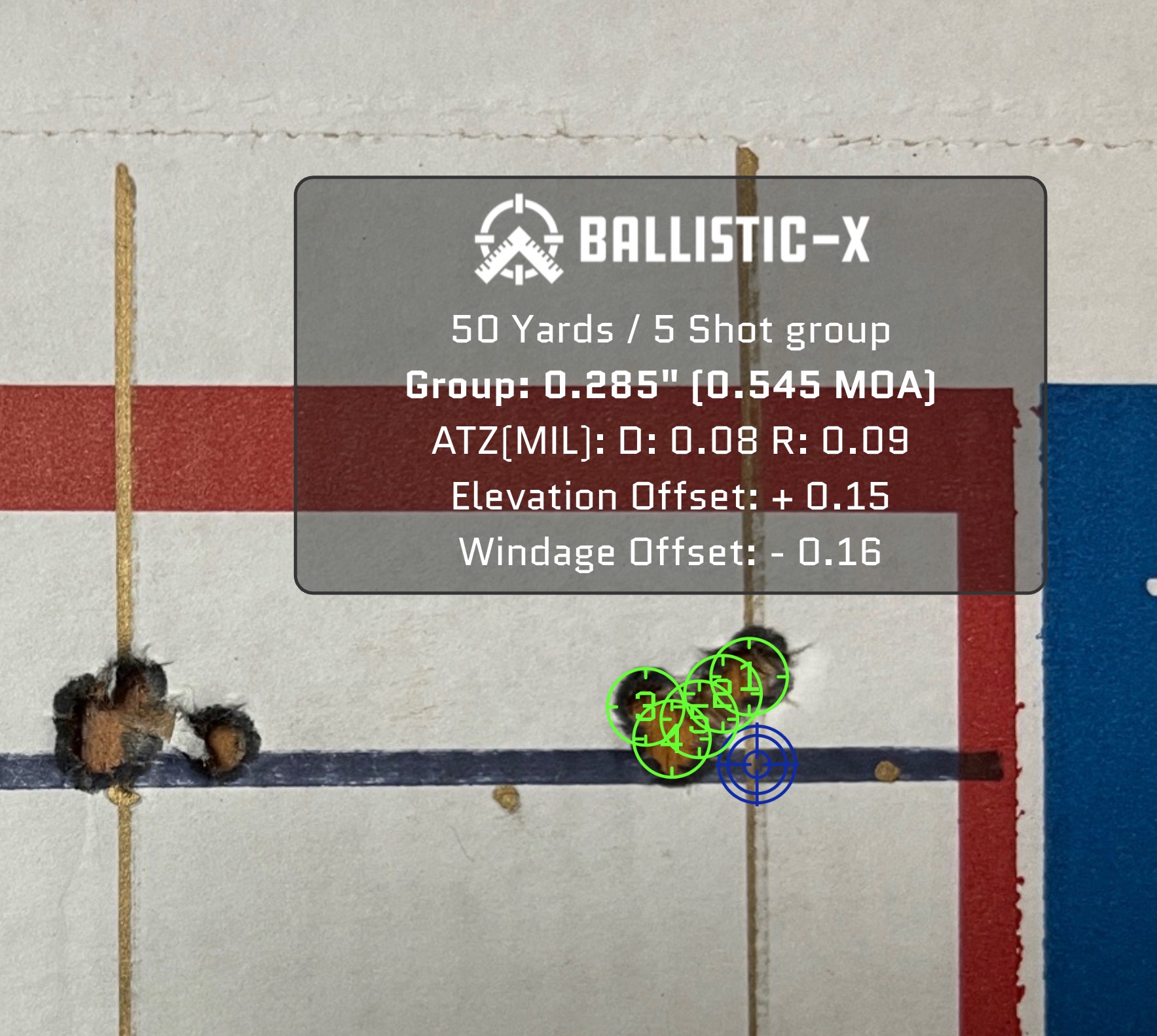

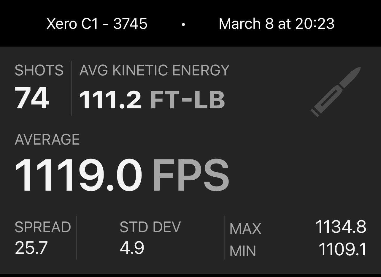

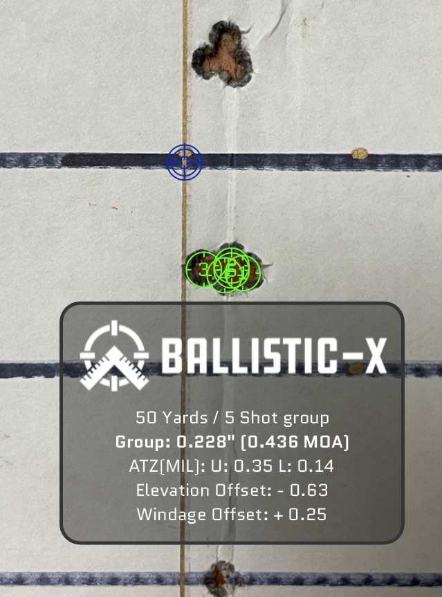

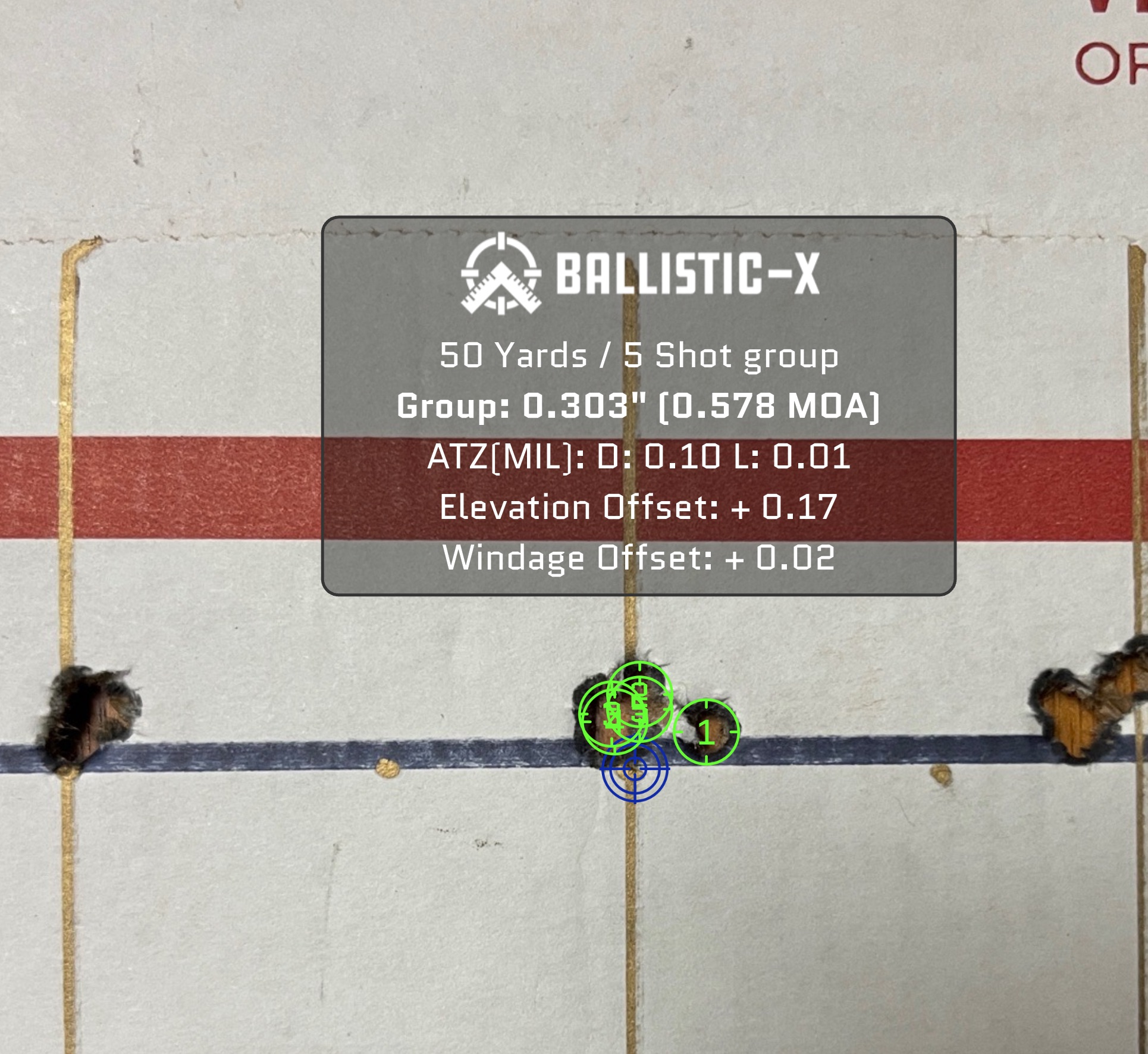

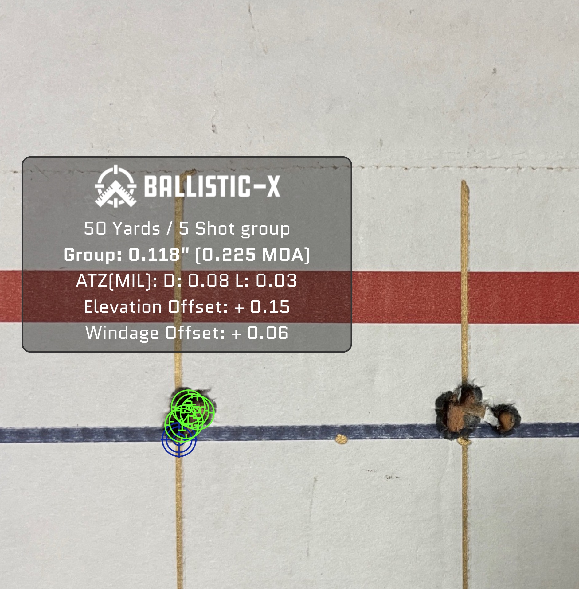

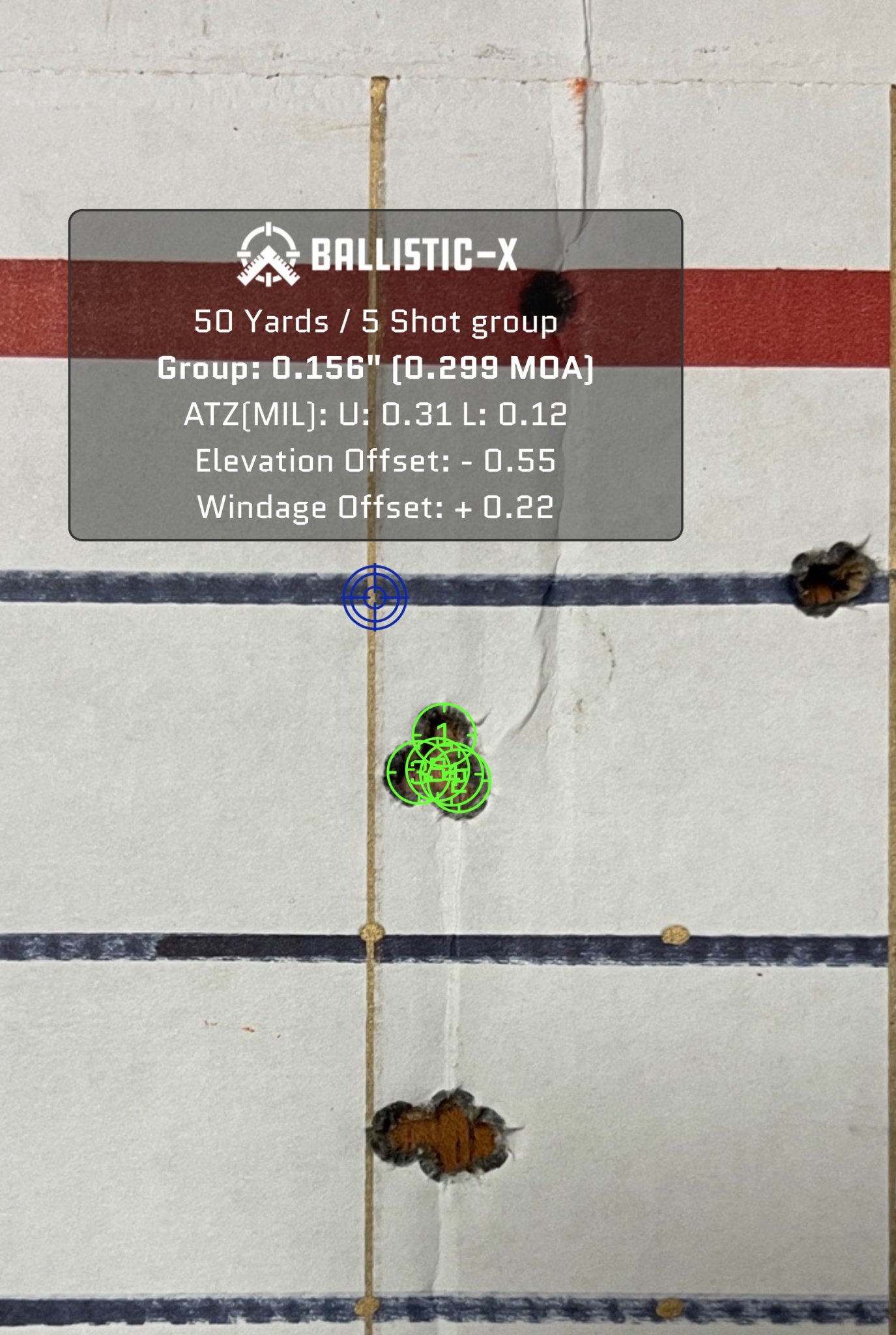

I got a Manzella Precision Green Mountain barrel a while ago and didn’t really shoot it much because I was using another barrel. Decided to screw it on for an upcoming match and use a random lot of Lapua Long Range I picked up. Hot damn it hammers. This “budget” barrel shoots just as good as the Krieger I have been using. Attached are the first 5 groups after shooting about 25 foulers. The first two groups shot low and then I adjusted it. The next 3 are with it zeroed. I promise you these are not cherry picked. I have also attached the chrono numbers on them. I’m a happy camper.
Great shooting. It's really hard to beat these GM barrels. They just hammer.

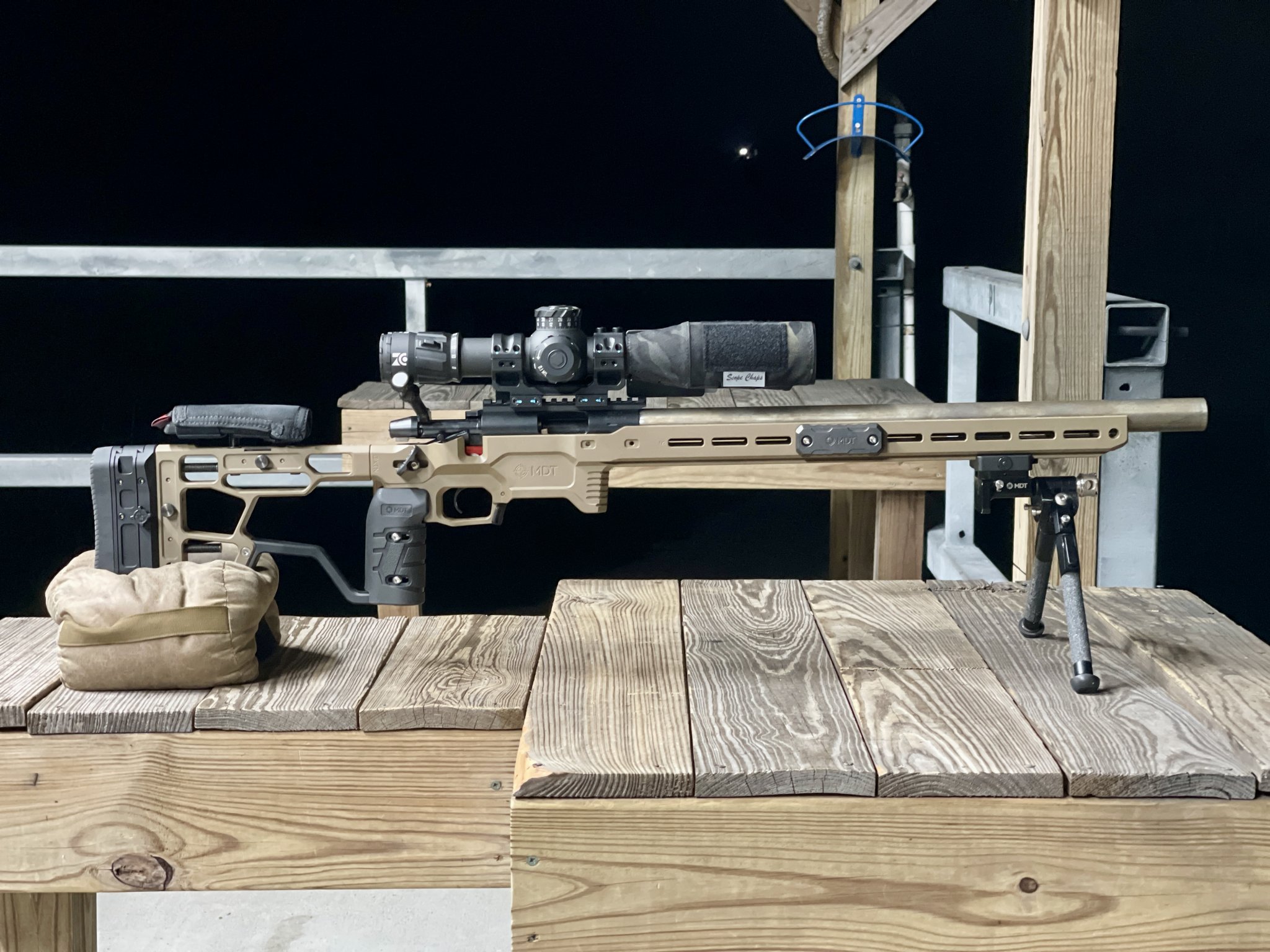

What profile and length is that barrel?

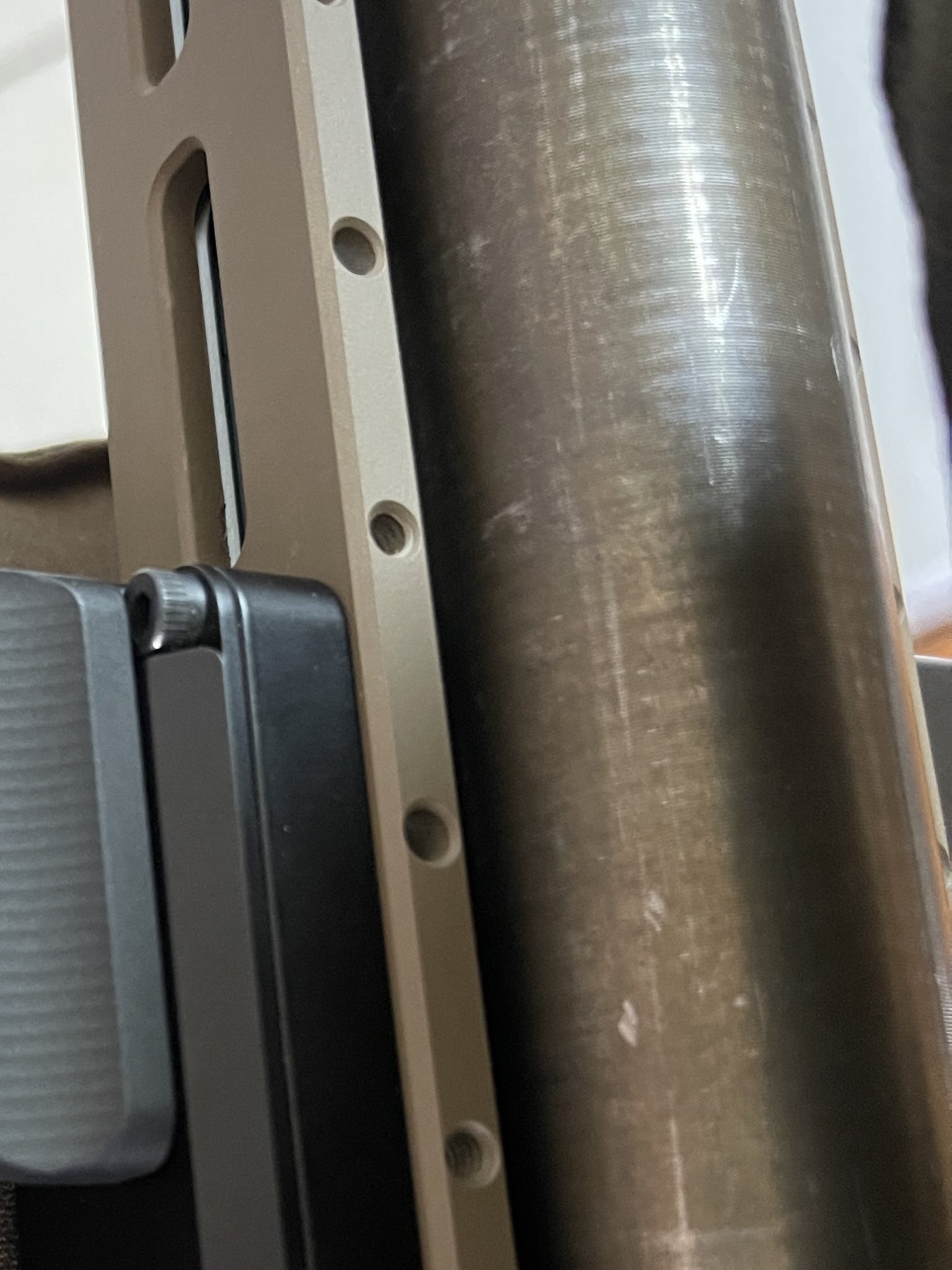

How does that balance, seems like the barrel would be pretty heavy. I have the heavy barrel Begara B14R which has their 20" MTU profile and it seems to balance pretty well on barricades. I am in the process of ordering a barrel for the RimX and could do with any advice from someone who already has one
I think that's going to greatly depend on your setup. Specifically what Chassis/Stock you will be using and what optic. Also, do you have a target weight for the rifle or weight you'd like to stay under? The 1.20 barrels are quite heavy but great for balance in a lot of the larger chassis/stocks (Manners TCS, MDT ACC, MPA Matrix Pro, etc). 24 inch 1.2 barrels are around 7.5 lbs and the action and bolt will weight around 1.5 lbs.
If you're using a lighter weight chassis like an MPA Hybrid or KRG Bravo for example, you might not need that much weight for balance.
It balances nicely but obviously as mentioned already going to depend on the stock/chassis you will be using and your overall target weight. 20#+ balanced rifles aren’t for everyone.

Looking to put the barrel into my MDT Oryx chassis and use it for NRL. Have been using a CZ in XRS chassis with Lilja barrel but difficult to really balance it. My Bergara in the Oryx chassis has the 20" MTU profile and it will balance perfectly on a tank trap tip, which is a good test.

I'm kind of shocked the Oryx balances for you. I don't know the weight on the Bergara Heavy Barrel, but my 10/22 (20 inch 0.900 bull barrel and a 30oz scope) in the Oryx is butt heavy by about 2 lbs. Maybe its the inletting for the 10/22 that makes the Oryx so butt heavy, but I haven't been impressed. I have their ACC Premier for a R700 223 trainer that's fantastic though. If your B14R balances fine in the Oryx though I can't imagine you'd have issues with the RimX.
I'd still plan ahead though. If you're already stepping up into RimX territory it probably won't be long until you upgrade the Chassis/Stock. I'd look at the RimX, Vudoo, and B14R threads more for examples of what people are getting to balance out. Take that into consideration for any future setups you might run and go a similar route. Adding a bit of weight to the butt to balance is usually easier than the forend in my experience.
