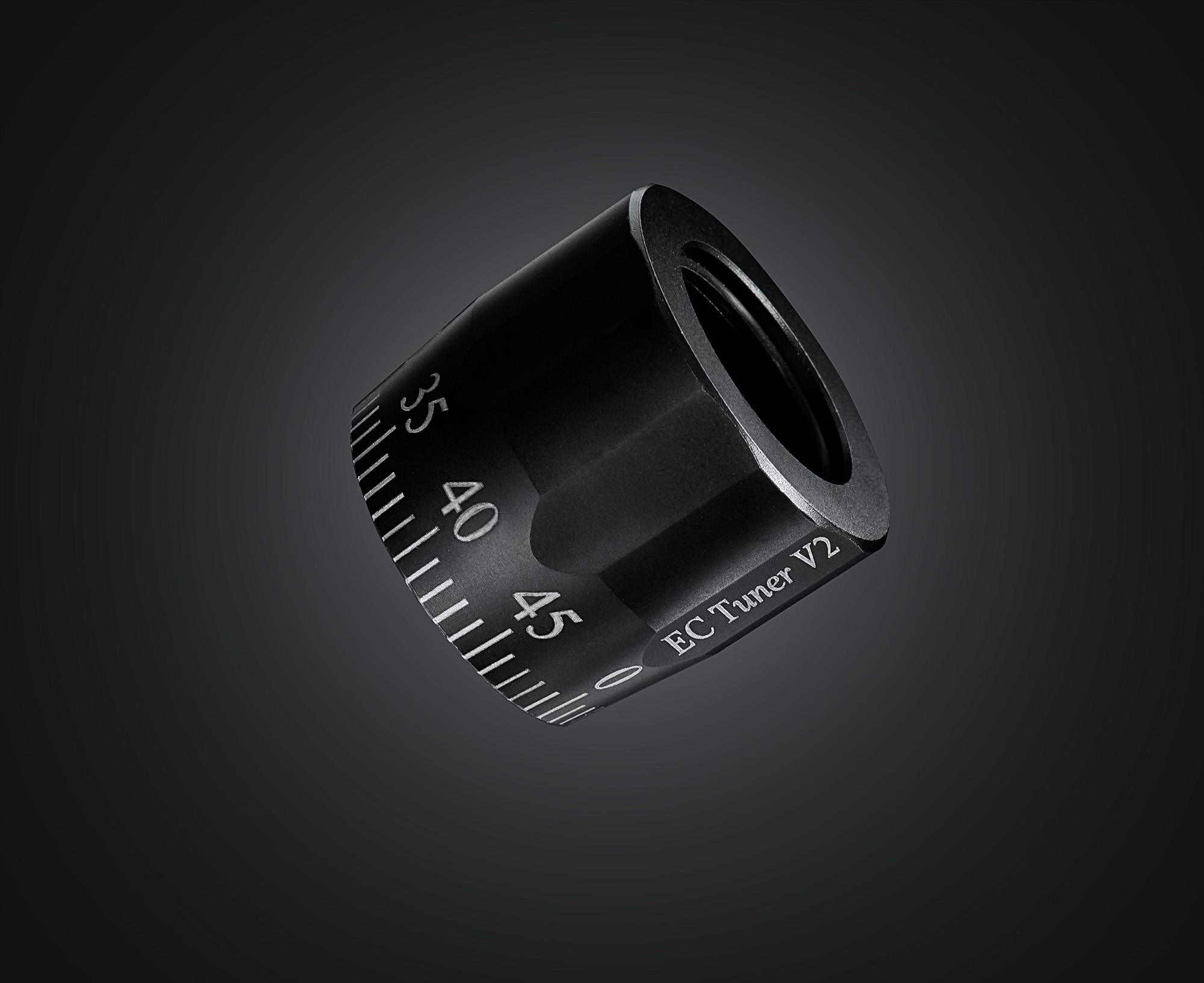

Which tuner is that?
I don't know what tuner he's using....but I was testing that Manzella barrels you just got from me with a Cortina V2 Tuner with 1/2-28 threads adapter. I really like them. No set screws and the setting stays in place.
Cortina V2 tuner
Thread adapter
Cortina V2 tuner
Thread adapter
Thanks padom.

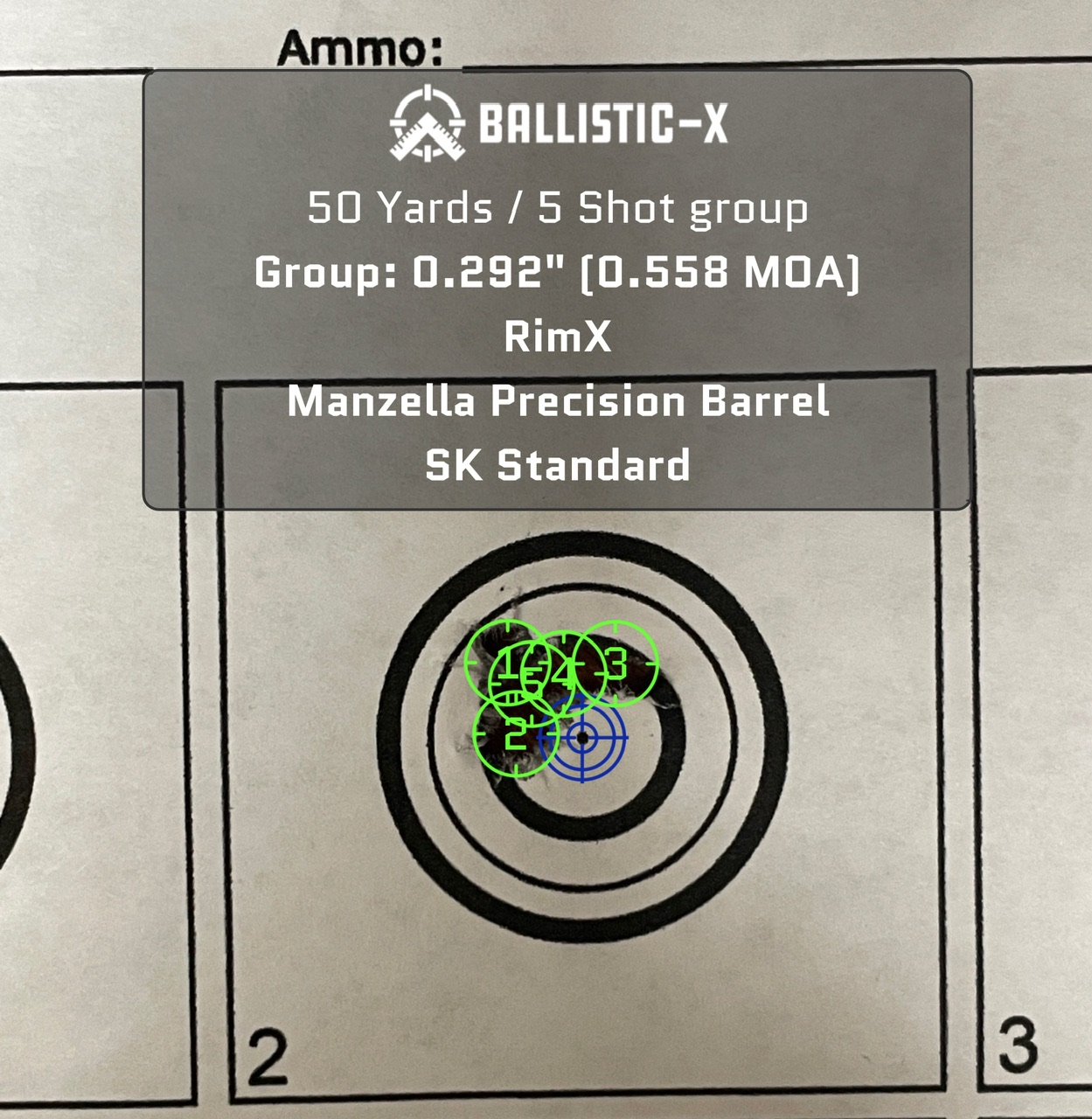

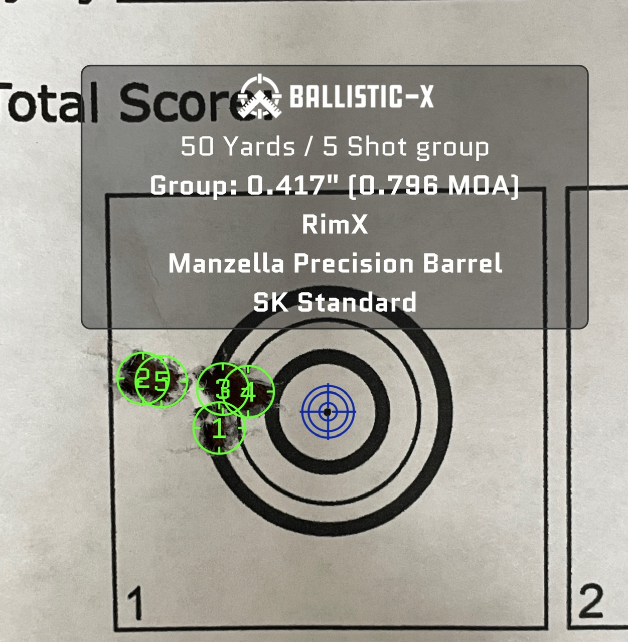

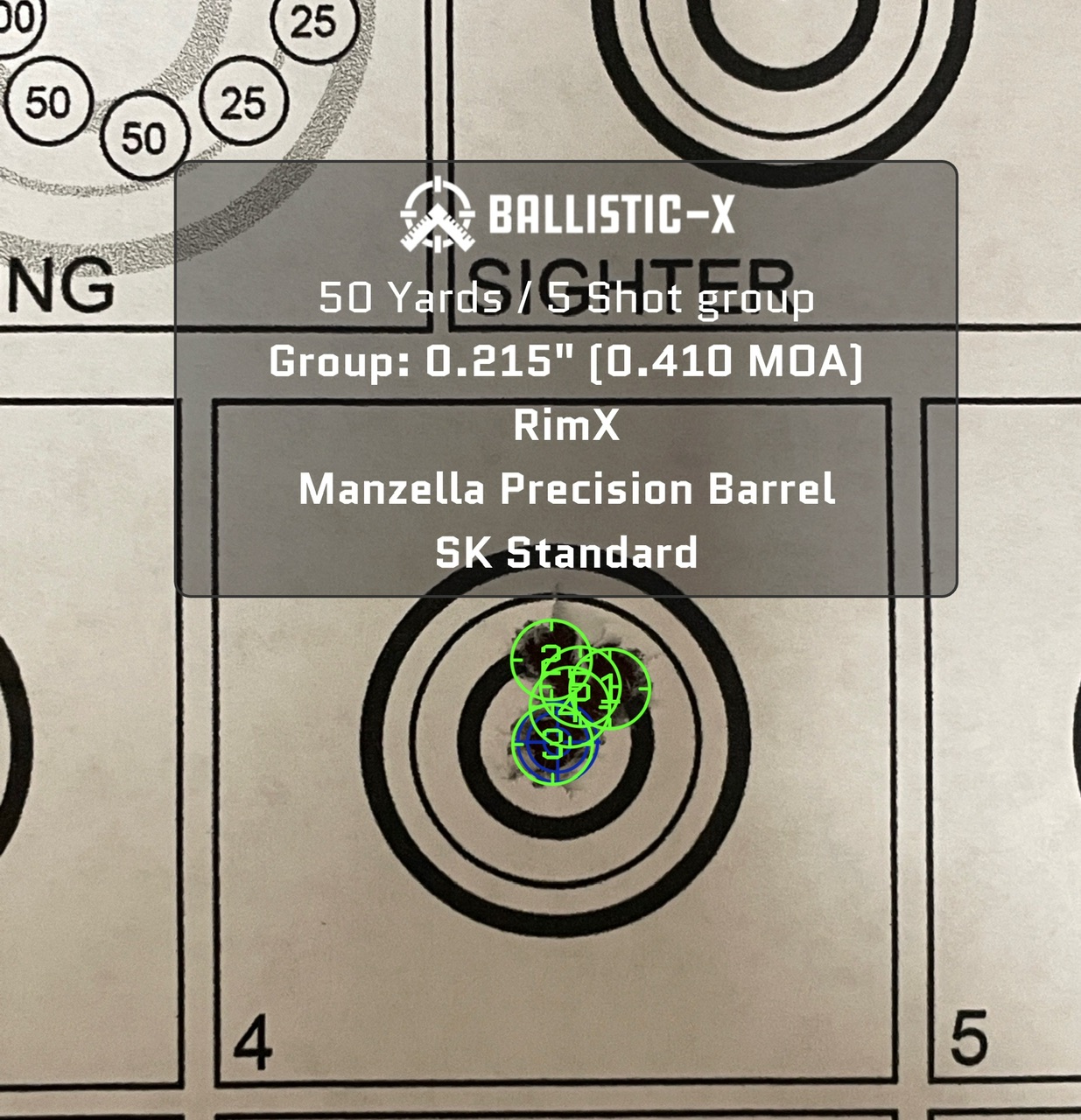

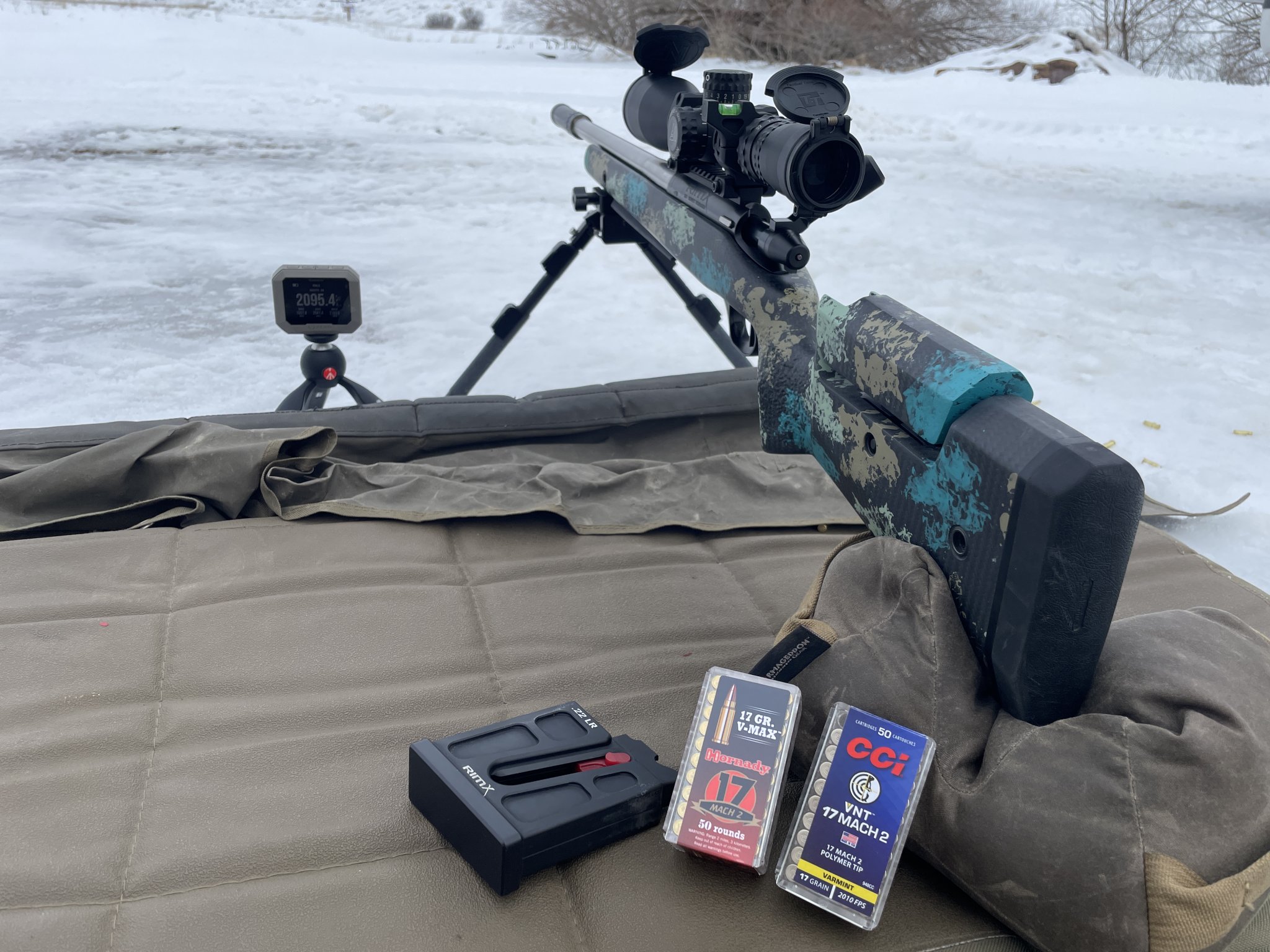

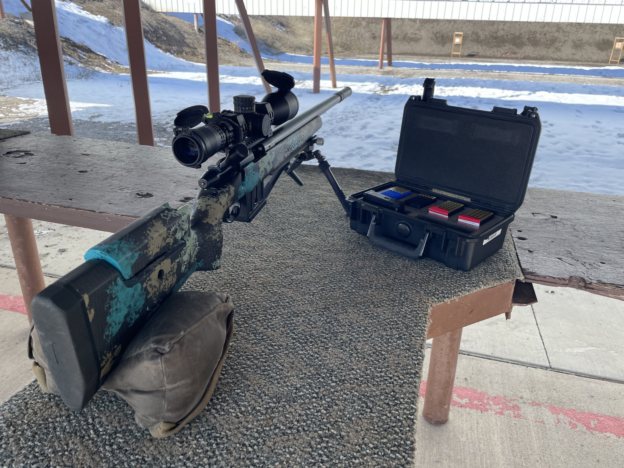

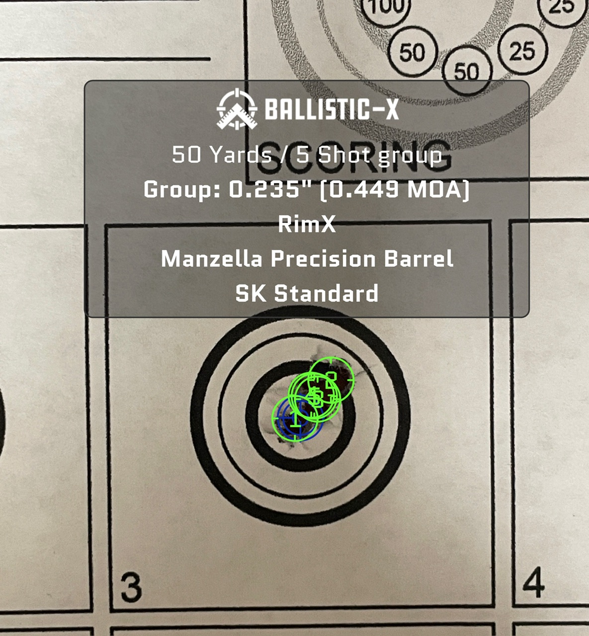

I got out twice in a week, first time that’s happened in FOREVER. 50 yard groups were good and I convinced the RO to let me shoot it at the 100 yard line too (our range doesn’t want 22lr skipping before the backstop so they generally don’t allow 22lr on the 100/200 yard range)
I dialed up 6.75 MOA and gave it just a bit of wind for the slight breeze and first shot landed just right of center. Next shot went just left of center before the final 3 pushed right again for a group just under an inch. I fired 3 more 5 shot groups and then finished with a 10 shot group. An average group size of under 1” at 100 yards with SK Match had me happy as can be. Watching thru the scope as those bullets come down into the target at 100 yards is kid level fun.
