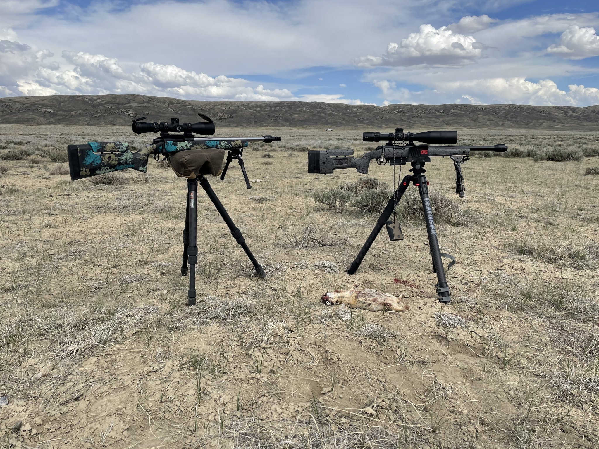

The RimX and my friend’s Bergara tag teamed this sod poodles at 366 yards. Shooting 22lr at that distance on prairie dogs is an absolute riot and it’s great practice off the tripods.
It sure is! 455yds is my personal best with 22lr on a Pdog to date. I've hit some further, but I refused to count them until I had one laying there dead.

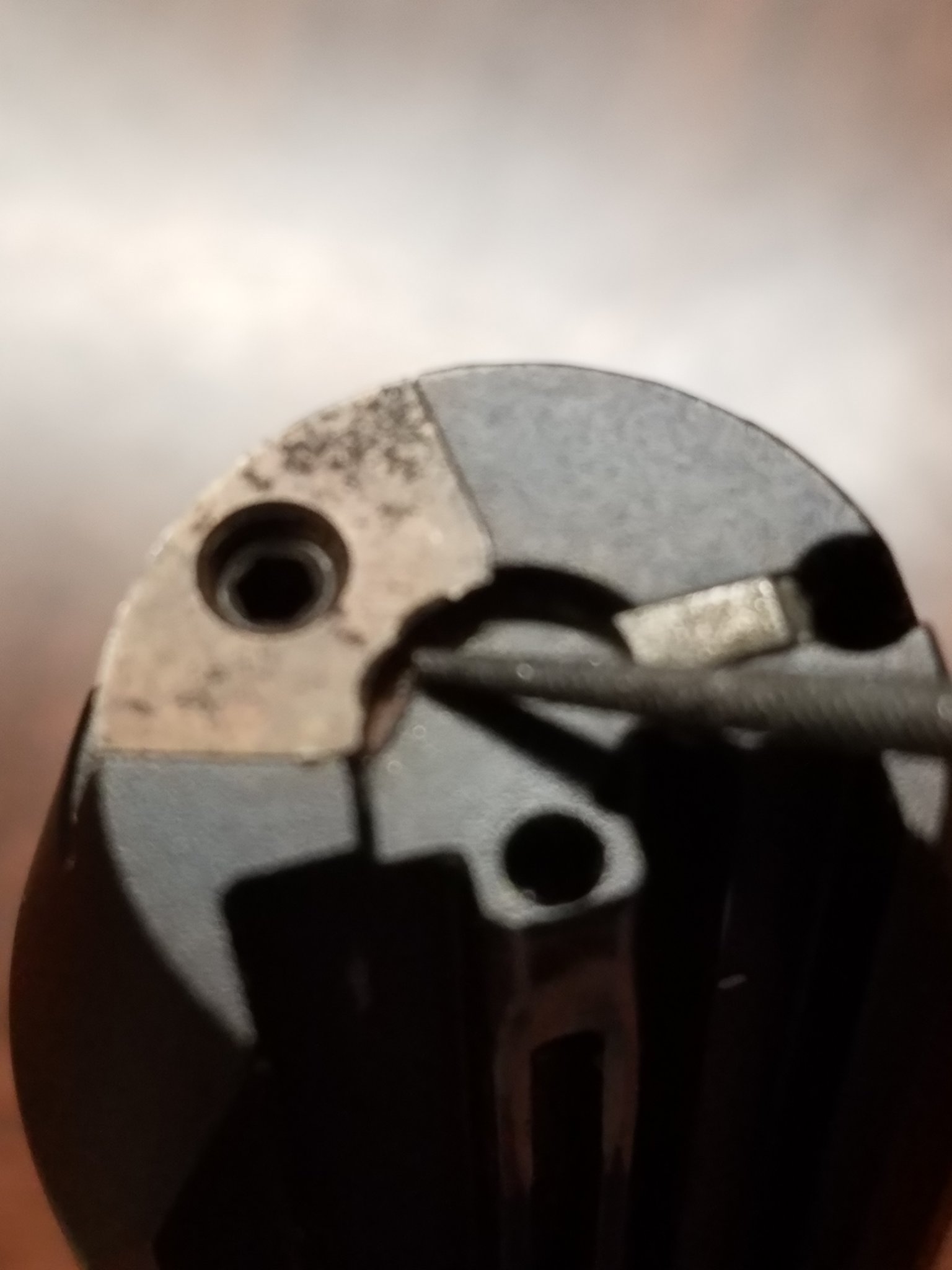

If your having extraction issues pull bolt clean under extractor remove all build up with plastic pic. Examine micro edge of extractor if it looks like one in pic that's chipped away give Ray a hollar for new one.
3 different chassis , Oryx, ACC, and a Vision. Happens in all 3. Extractor and tensioner where replaced, but extraction is not the issue anyway. Happens relatively rarely, sometimes I run 8 mags without failure.
