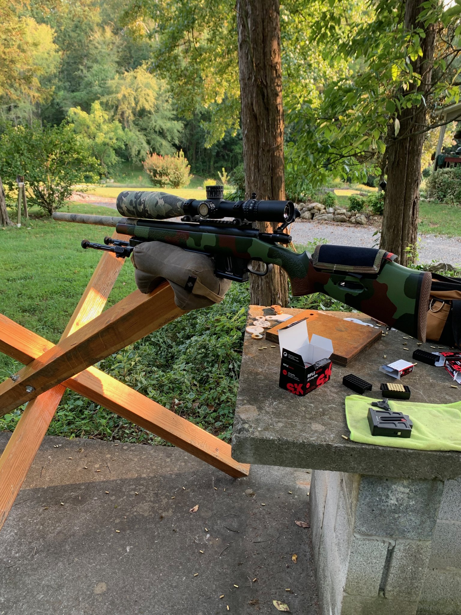

Had a glass upgrade, well swap, took it off my centerfire rifle!!! 22LR is more fun!!!
I have a very heavy to close bolt on my rimx any suggestions ?
50 rounds total down range.
diamond tt trigger
keystone barrel padoms chamber.
No fail to feeds, no fail to ejects gun hammers tight groups......just miserable to close the bolt ? Thanks

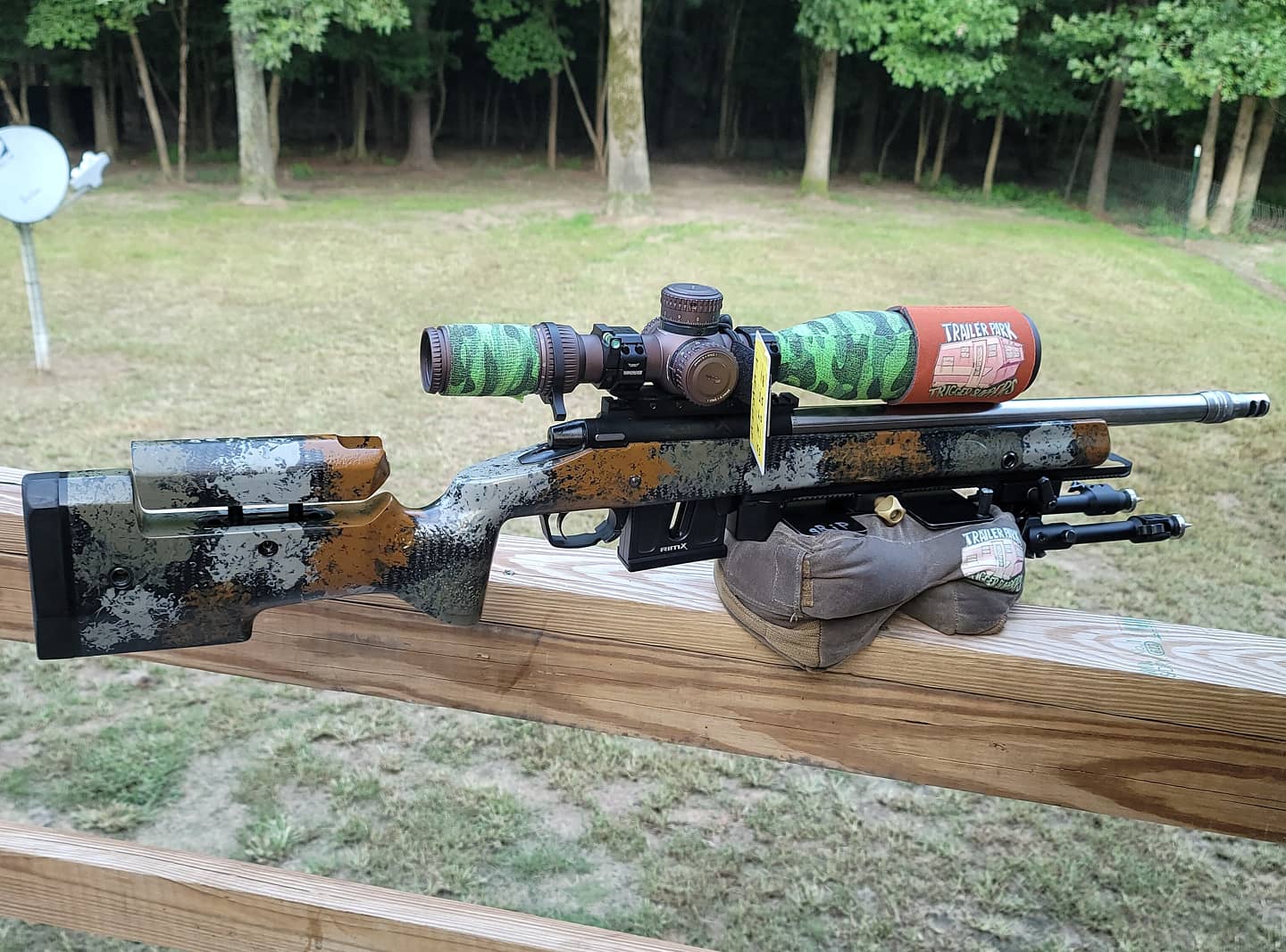

Reliability test after Xring had replaced the old version of the extractor and tensioner. Seems to be running like a sowing machine.
JUST FOR CLARITY:
There was not an update to anything dimensionaly. We made a material change to the extractor (schematic attached) that has proven to be a good decision. There have not been any changes made to the tensioner in any capacity.
Thank you - Ray

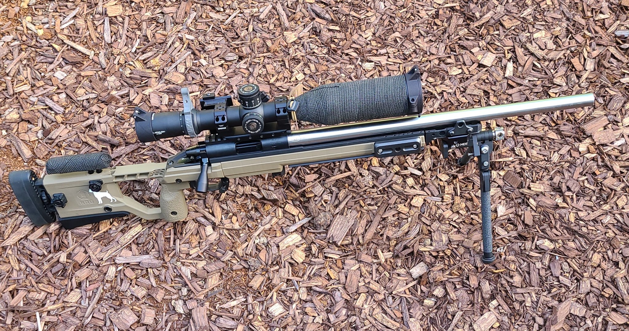

I had exactly the same experience with an early left handed action. Ray sent a new extractor and tensioner that totally solved the issue. Since I've used three different barrels and two different chassis and in over 2K rounds have not had a single failure to feed, eject or fire. Reliability has been 100%. Thanks Ray / Rim-X!
Action-Rim-X
Chassis- MPA Matrix / KRG Bravo
Barrels- Bartlien / Shillen / PVA 1-12
Trigger- B&A Tac Sport Pro 2 stage (low sear)
Glass- Night Force NX8 4x32
