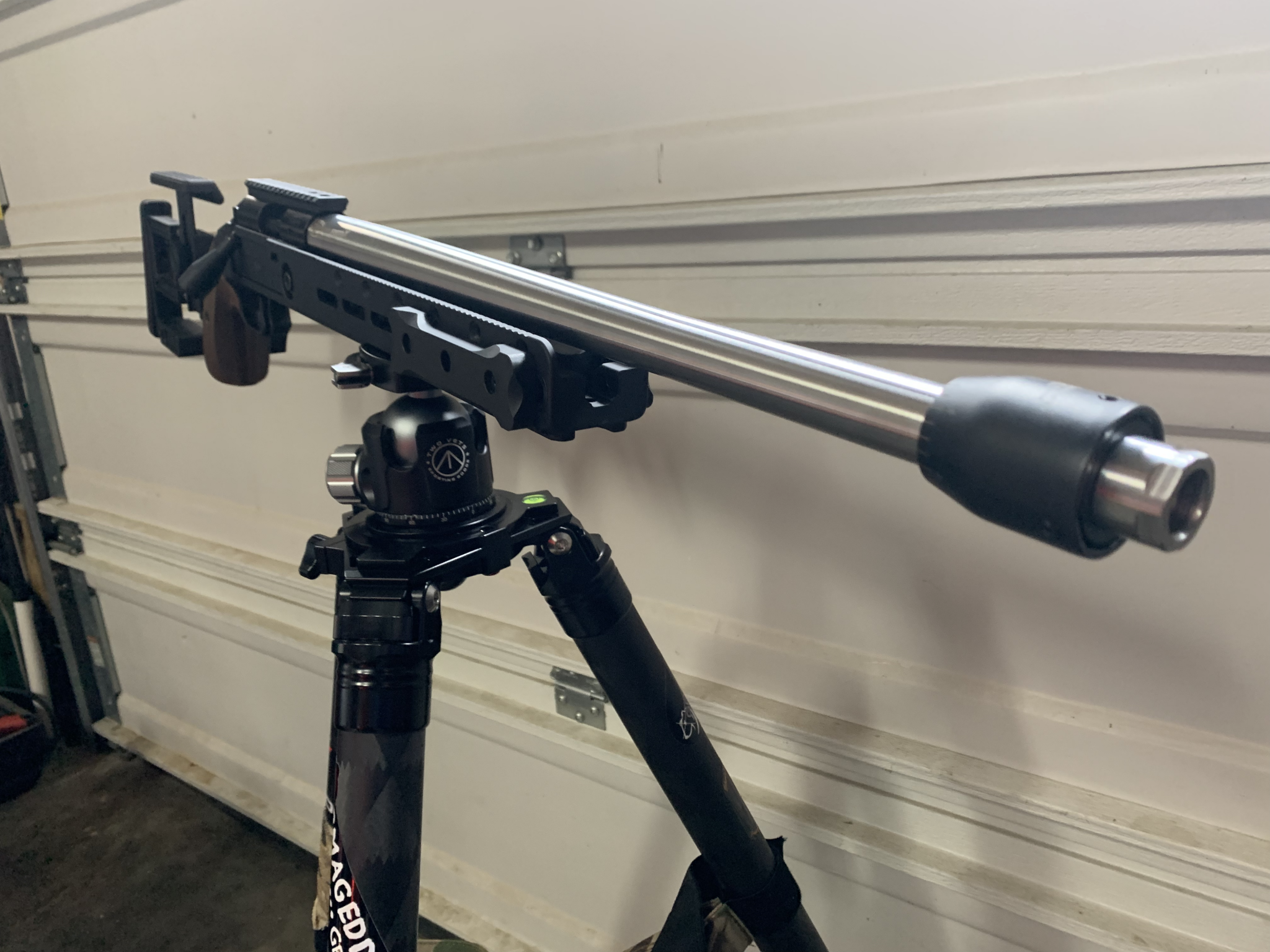

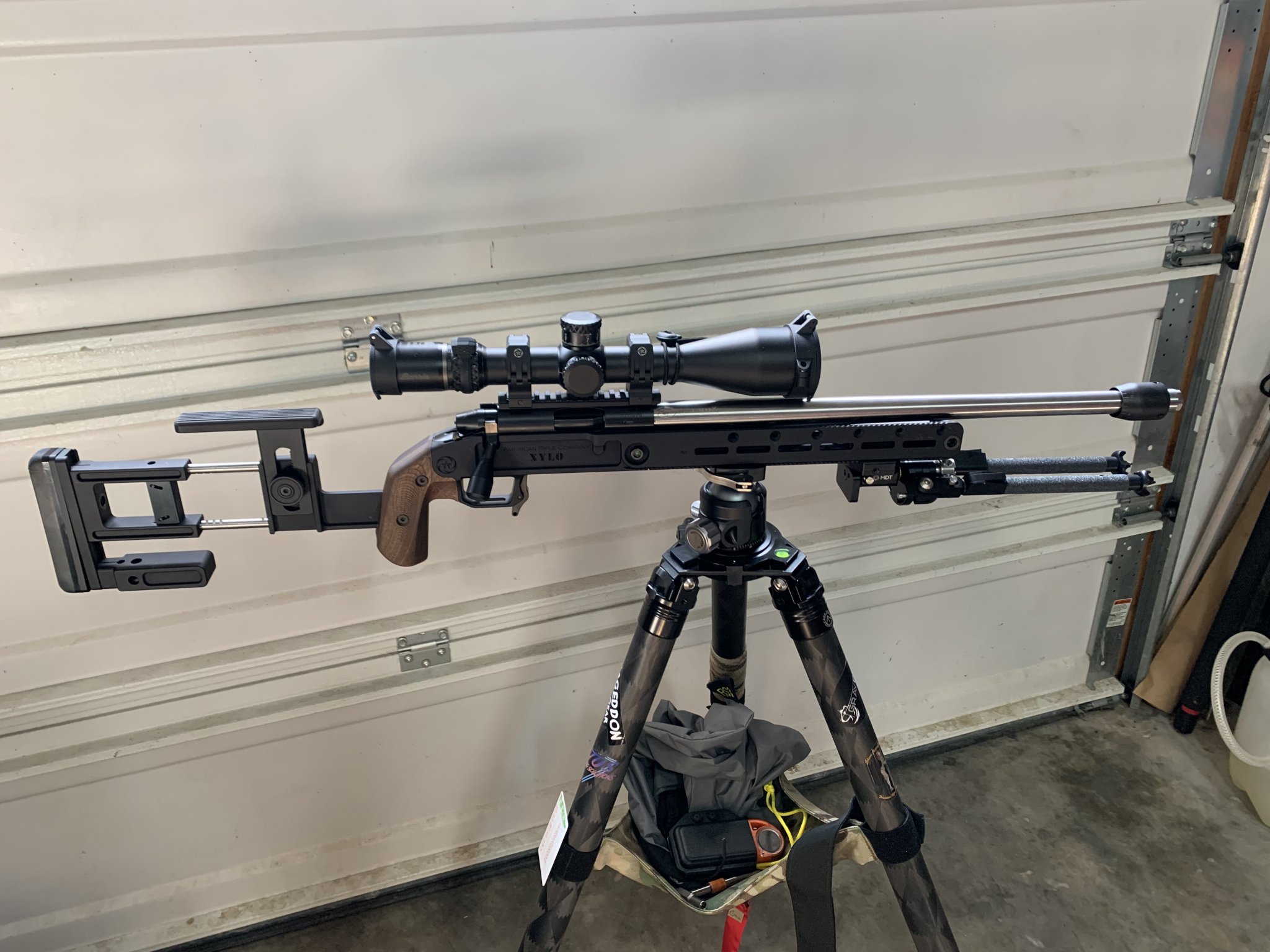

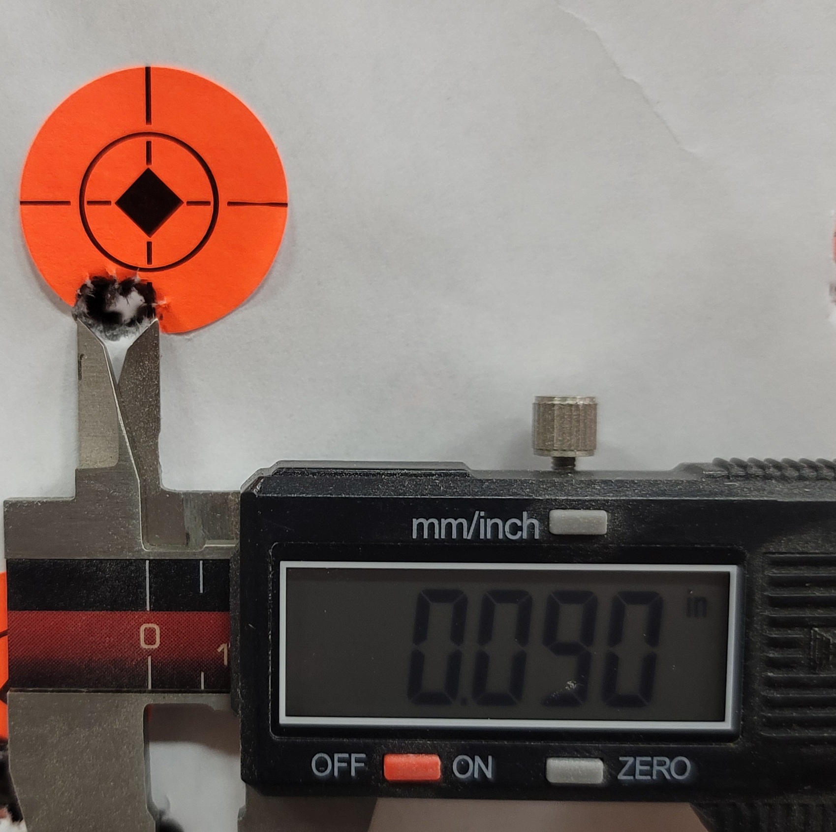

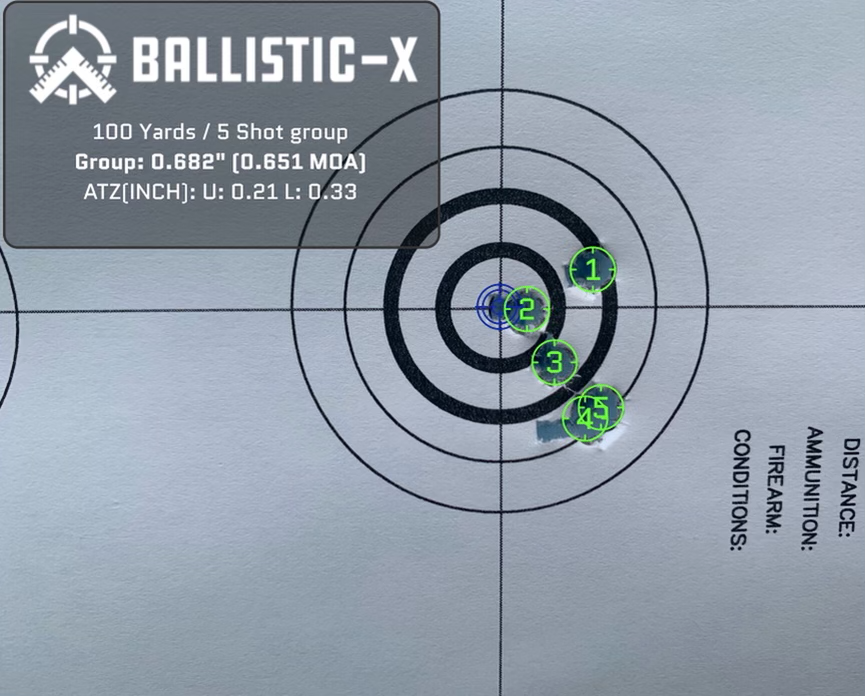

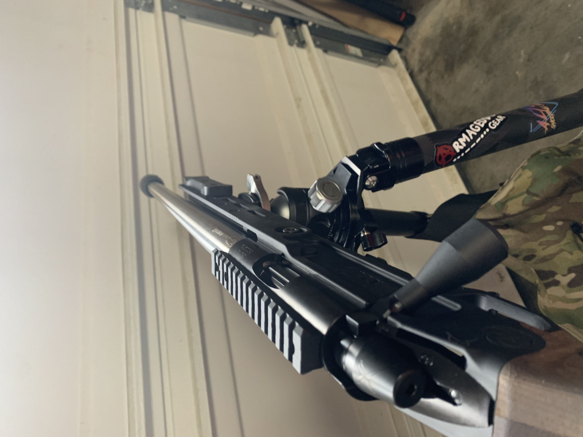

I was finally able to install the trigger, torque the barrel and mount the optic. I zeroed at 50 with SK Standard+. It was a Lot the Vudoo shot well. 40 rounds of it and it was OK. I then installed the ATS Tuner and switched to Rifle Match and made some moves. It’s time to go to the Gun Range and get the tune final adjustments. I only have 110 rounds down the tube but DAMN. I couldn’t be happier.

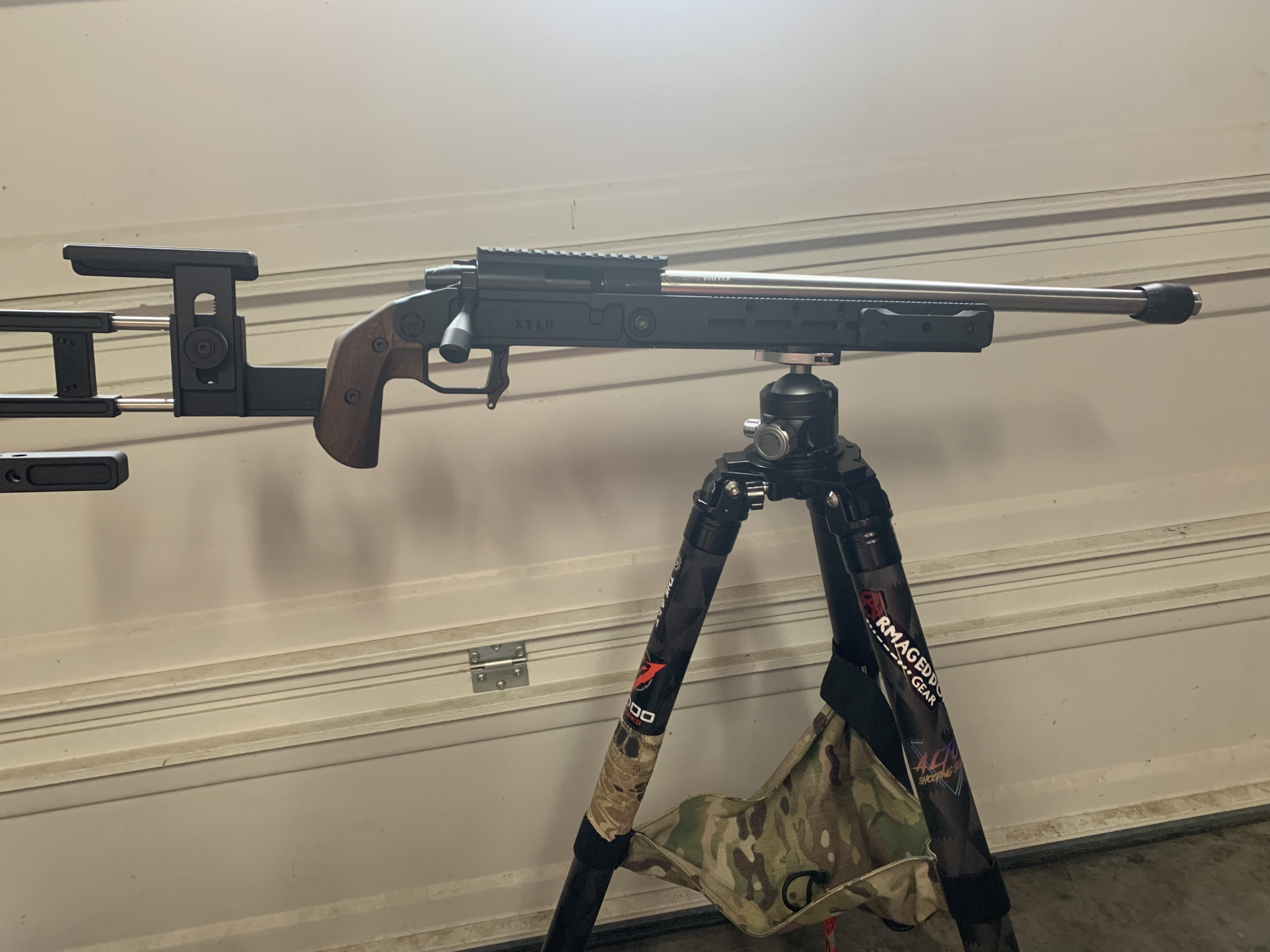

Build
PVA 22” 1:12T M24 5/8-24 Thread.
ATS Tuner.
ARC XYLO Chassis.
ARC Rings 34mm Med
Burris XTR3 5.5-30/56 SCR2 Mil/Mil
I pulled #5 so I sent #6 into the same hole.

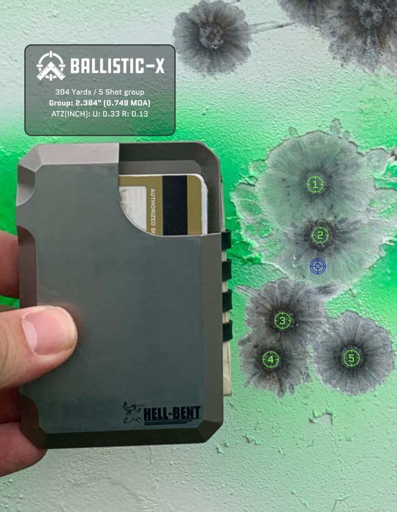

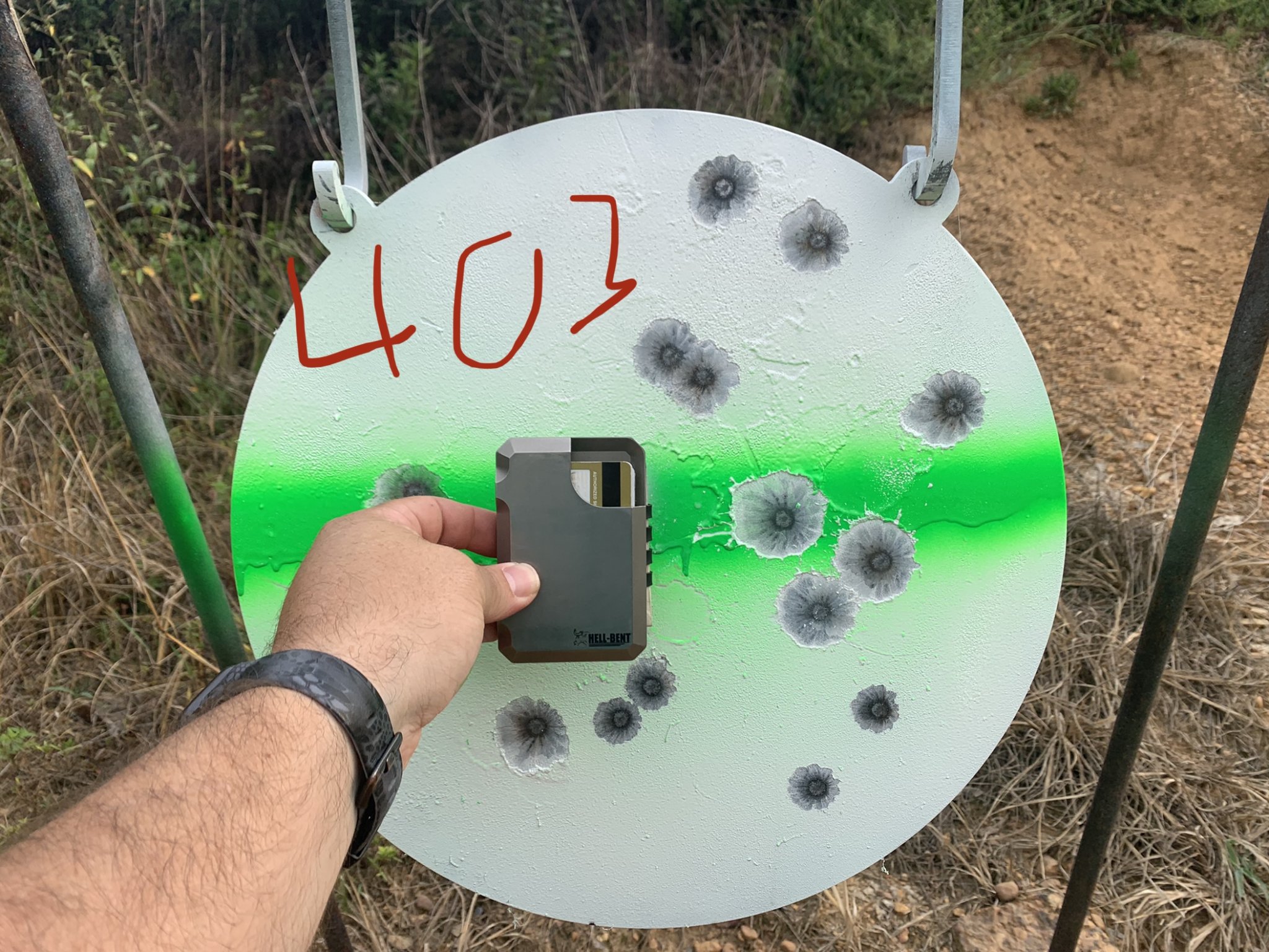

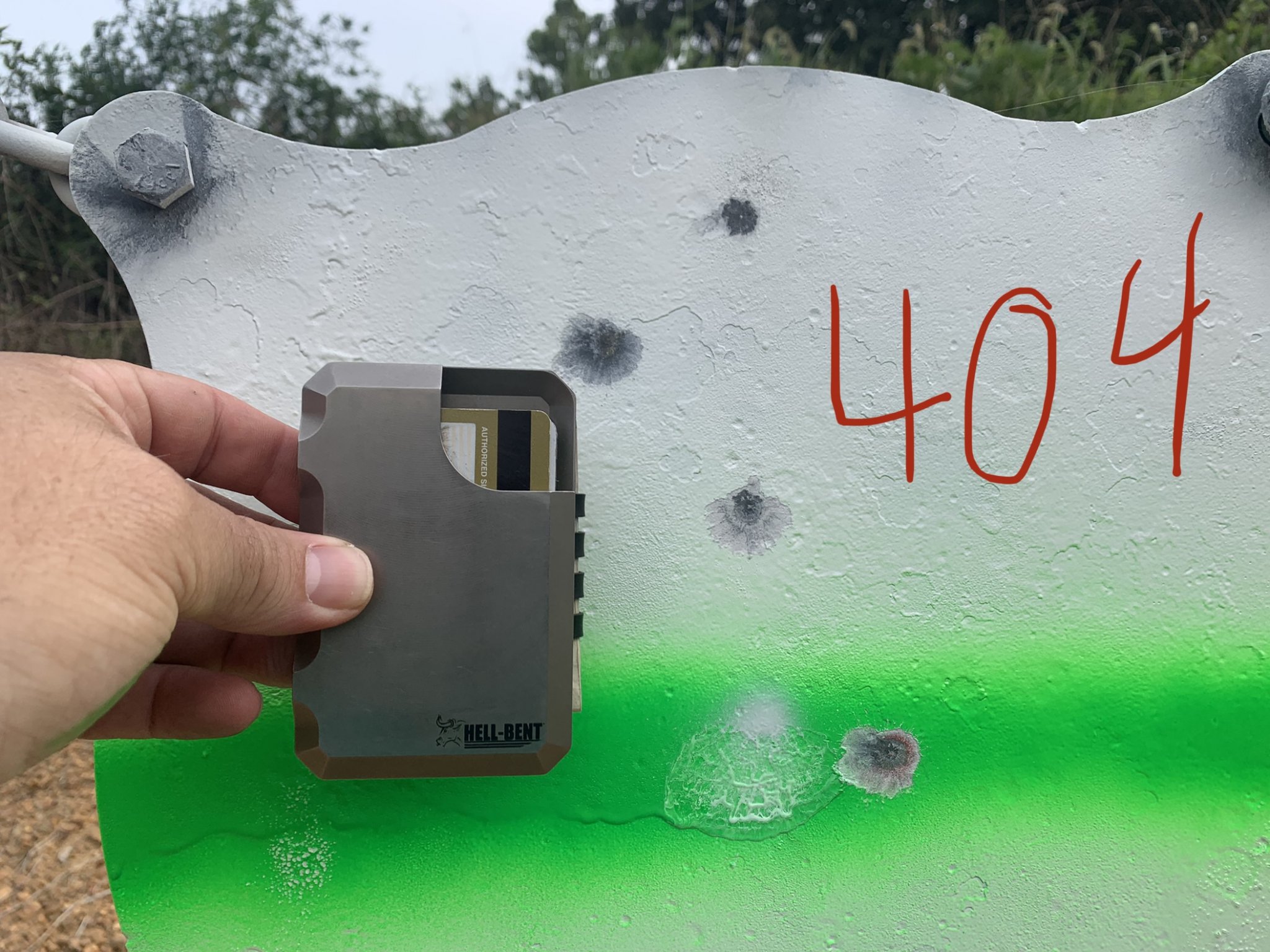

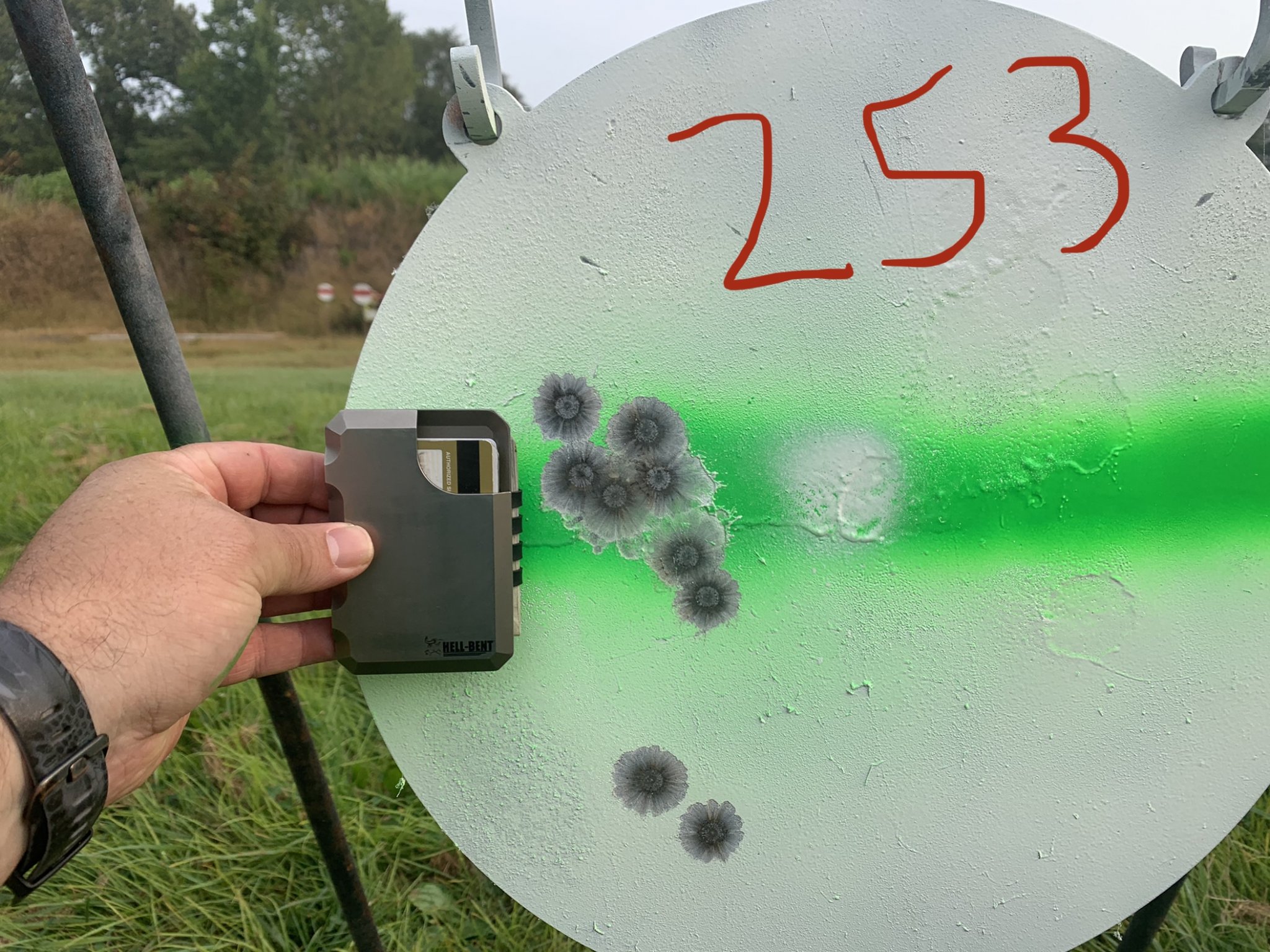

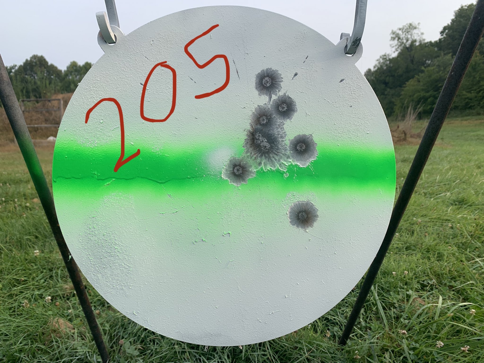

I finally got a chance Sunday Morning to get to the Range and verify DOPE out to 400 and fine tune the ATS Tuner at 100. This 12T PVA Barrel is legit. Do not second guess these guys. I had to make 1 Cal DSF Adjustment at the 300 mark. It called for 14.6 and it was a 14.05. My average velocity is 1076 for 30 rounds. SD was 3-7 and ES was 18-22. I did have a couple that went 1098 and I deleted those shots. They always have potential of being there. This is SK Rifle Match.

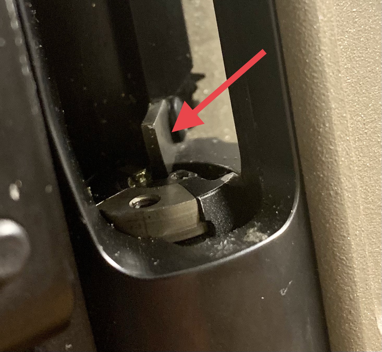

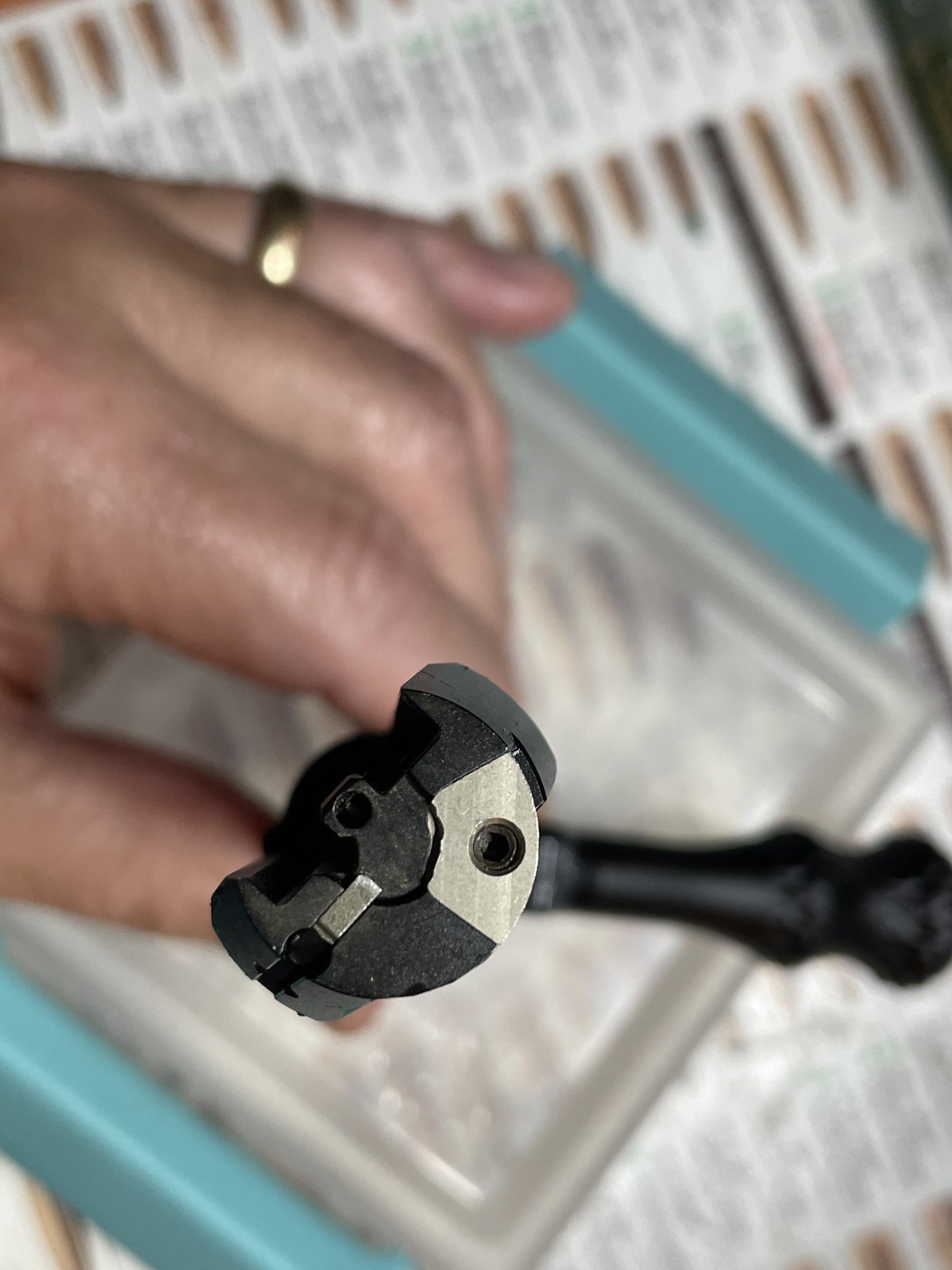

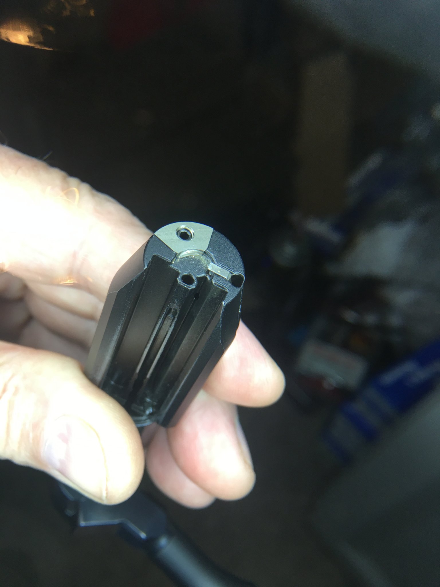

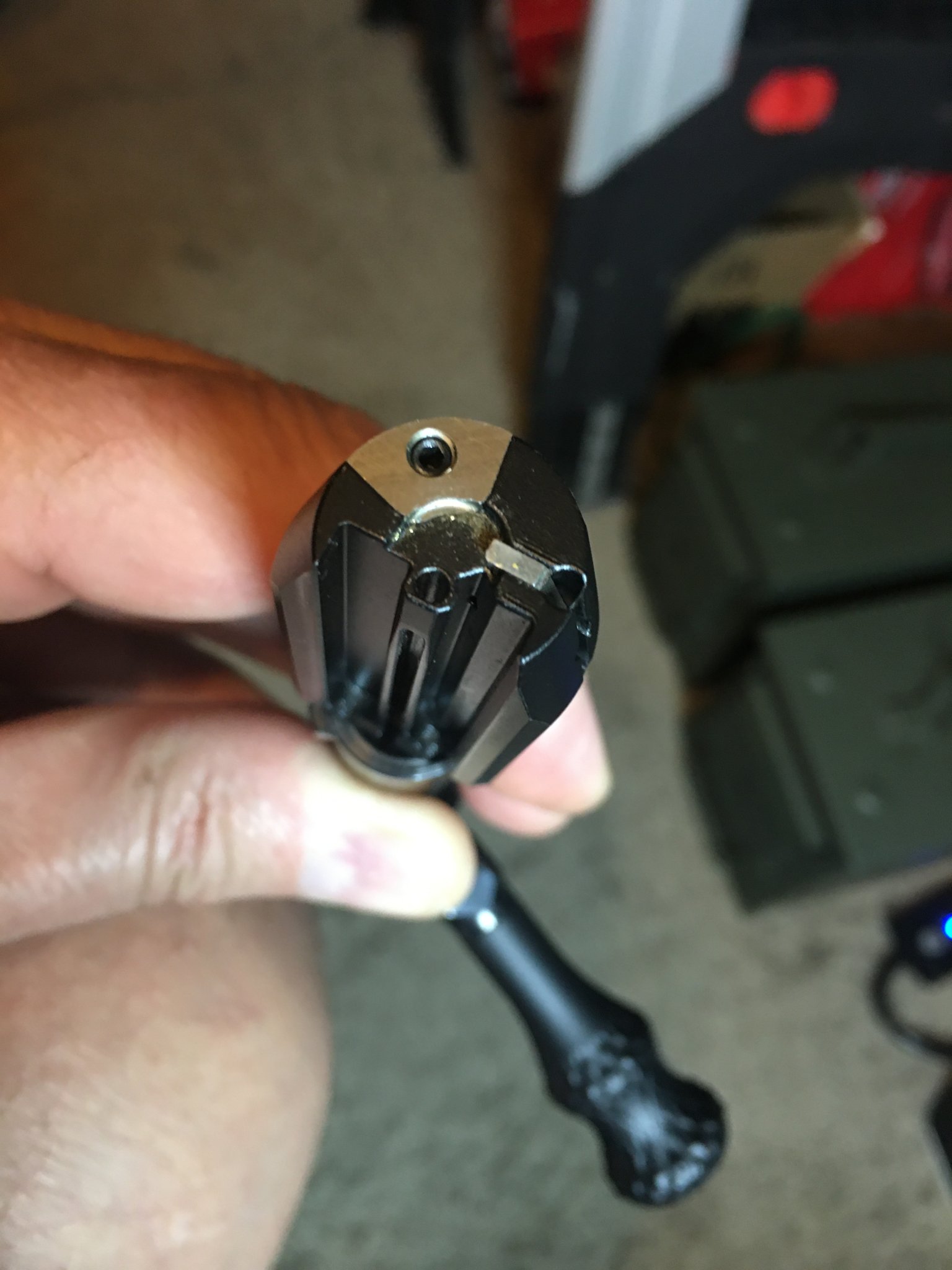

Finally got my Rimx built today. I added a radius to the tensioner that was discussed awhile back. I still have ejection issues and after looking everything over it appears I do not have an ejector in my action.... I noticed there is a screw in the side of the action the appears to be where one would be.... can someone post a picture of inside the action so I can verify that it is missing.
Thanks
Here you go
  • RimX Bolt Head Schematic 2.pdf

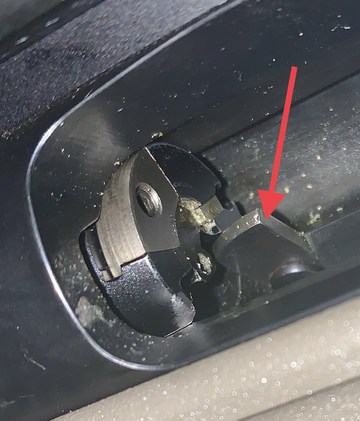

Big shout out to Ray at Zermatt arms. Sent a picture of the extractor and a new one is on the way.
The only trouble I’ve had with the RimX, is since the extractor got chipped. Very weak extraction and the occasional fully to chamber and the round needs to be pulled out by hand. Up till this point, about 650 rounds, zero problems! Love it!
Jeff
