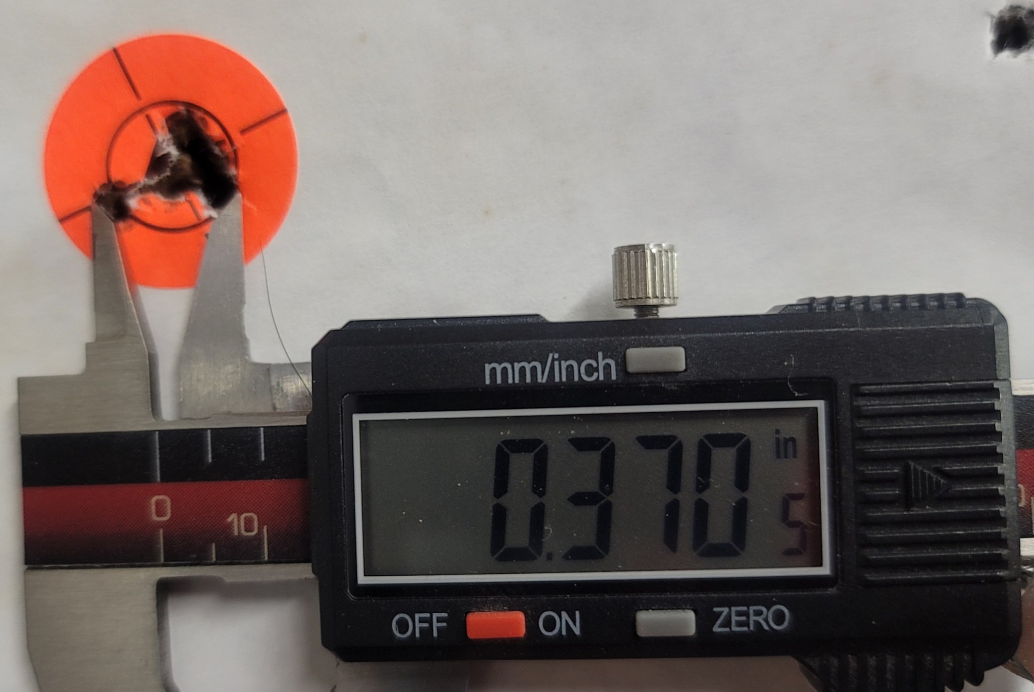

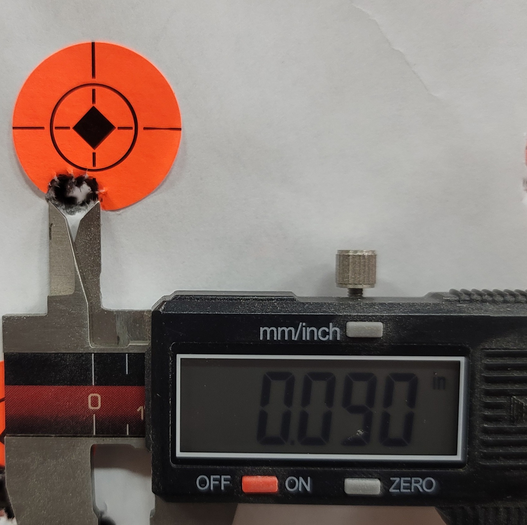

10 shot group at 50 yards!
5 shot group at 50 yards.
5 shot group at 100 yards.
Ammo used and was that with the tuner? What results were you getting without the tuner? What do you recommend for barrel vise and wrench. I can't find anything to explain how to disassemble are reassemble on youtube. Straight Jacket is having a sale on these now and would like to compare to my Lothar Walther.
The ammo was SK Standard Plus!!! It was a great batch that I haven't been able to get a comparable results with more expensive SK ammo.
I was using the tuner and it definitely helps but it was very good before that. A tuner isn't going to make crap ammo good!!!

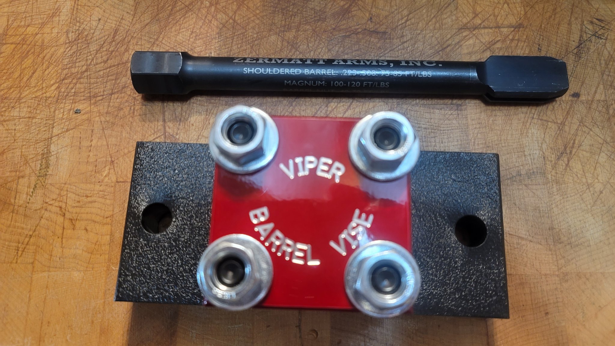

here are the tools I used to torque the barrel to the action.

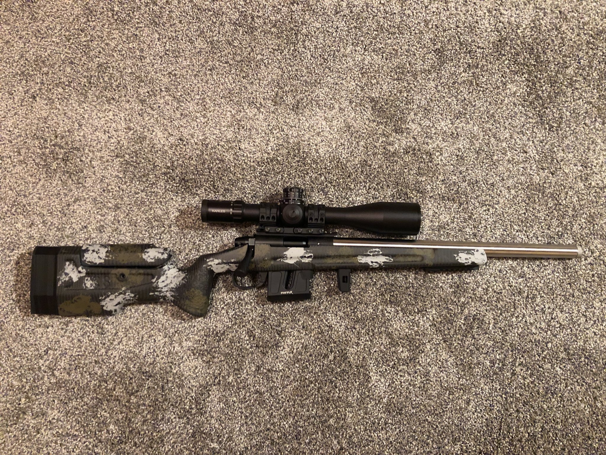

Finished up my build today after my Green Mountain barrel arrived from Keystone Accuracy the other day. Everything went together great and tested fine. Had to adjust magazine just a little to be at correct height but once that was done it feeds and extracts great. Test fired and cycled some rounds with no problems. Now to zero and start testing ammo.
Nice rig. Welcome to the addiction 🤣

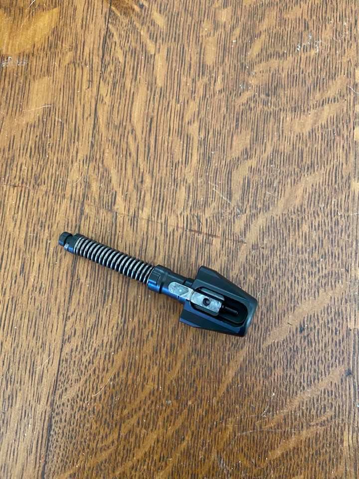

Is it a fix for Timney Triggers FLF, Ray was gracious enough to send me a redone cocking lever because I
was having an issue with Timney triggers and FTF's . Trigger Techs are no problem. Hope to be able to pull the trigger in a few days and see
pretty sure problem will be fixed

After hunting this morning I had planned to stop by the local forest service range on the way home, I loaded one round with the new cocking lever installed from yesterday, I am going to have to readjust the magazine catch and or trigger guard in the KRG Bravo stock, the Trigger Tech as installed works perfect and shoots so well, I am not going to bother with trying to "make" the Timney trigger work, If anyone else would like to give it a run, send me a message with your address and I will mail you the cocking lever that should work with a Timney trigger.

The barrel I clean after about 5k rounds. To do this I separate the barrel from the receiver in a barrel vise with the Zermatt action wrench, so fast and easy to do. Depending on your barrel vice mounting you’ll have a nice solid hold to clean the barrel. I just got a in-line fabrication bench mount for my reloading press with quick change adapter. One adapter for the vice. This brings the barrel in the vice into a nice high extended working position above the bench.
