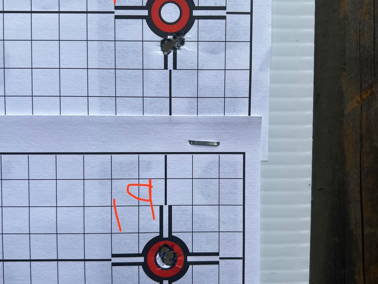

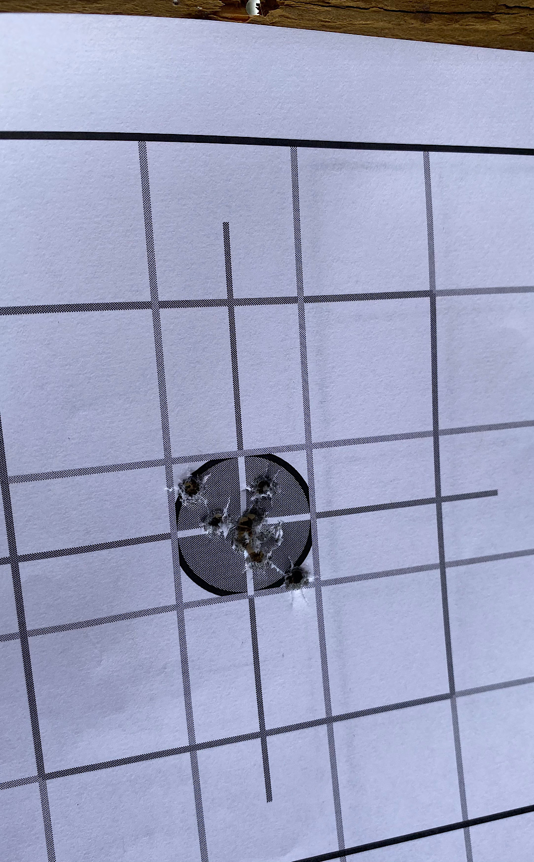

Got this new Keystone Accuracy Green Mountain back out today to really see how it shot with various types and lots of ammo after breaking it in yesterday. Good old 22LR, ammo and lot testing is the name of the game. o_O
After putting 200rd+ through it yesterday, then giving it a cleaning today I went to the range to shoot some groups and test ammo to see what it liked. Upon arriving at the range I put a 50rd box of SK Pistol match through it to foul the barrel then started the below ammo test. It really shined when it found ammo it liked but thats the name of the game with precision 22LR isnt it??
Here are the results if you dont want to zoom in and read the target
Everything was shot from left to right, starting at the bottom and going up. All groups were measured with calipers outside to outside black smudge minus .223. If you subtract something else, go ahead and +/- from my recorded group size. Ive used this method and measurement for all my testing so Ill stay consistent for comparison sake.
Two of the CenterX lots were straight hammering. Cant wait to get a calm sunny day to shoot them at 100yd! Those 2 lots shot sub 0.5moa 10x5's which is awesome. I dont think you can find a better value for the money. Custom made to your spec RimX barrel sub $400... Hard to beat that. Is it the MOST accurate RimX barrel, no. Did it shoot the smallest groups or AGG in all my 22LR testing, no. But it sure does shoot consistently for the money and brings a ton of value with the right ammo/lot!
Also, this barrel is not using my chamber. This is a new custom .22LR Match reamer Keystone Accuracy had made a few months back that they are using for all their RimX barrels unless someone specifically requests a different reamer. So far, just over 200rd down it yesterday and 550rd down it today. Not single feeding, ejection or stuck case issue. No shaved lead. Ran like a swiss watch.
Shot from the bench at 50yd, bipod and rear bag. No can.

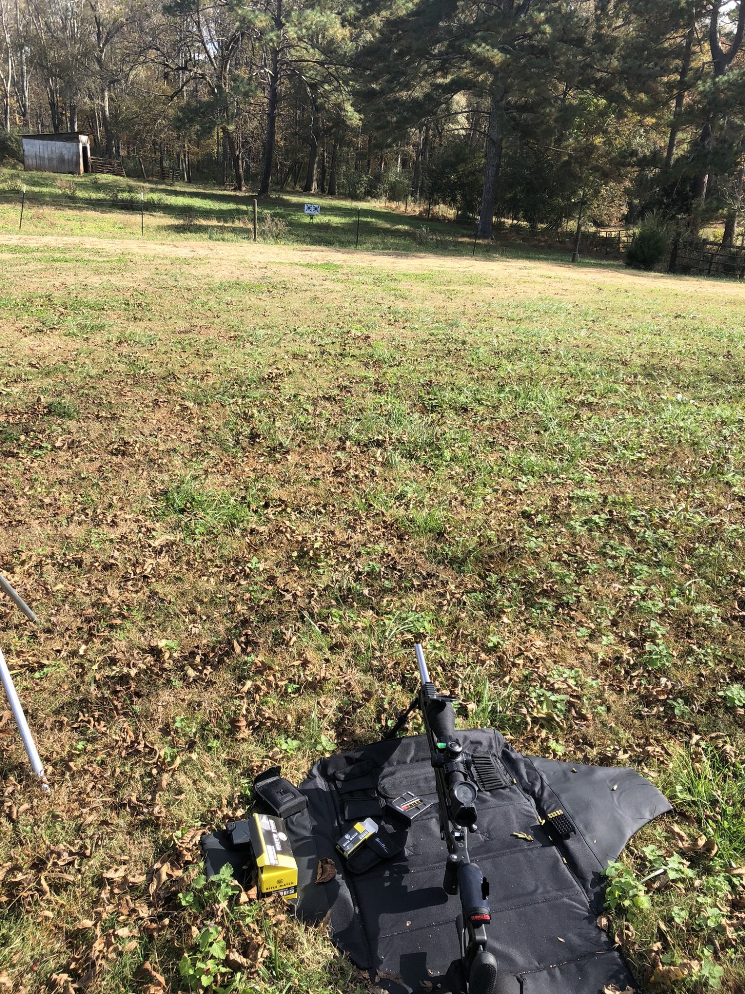

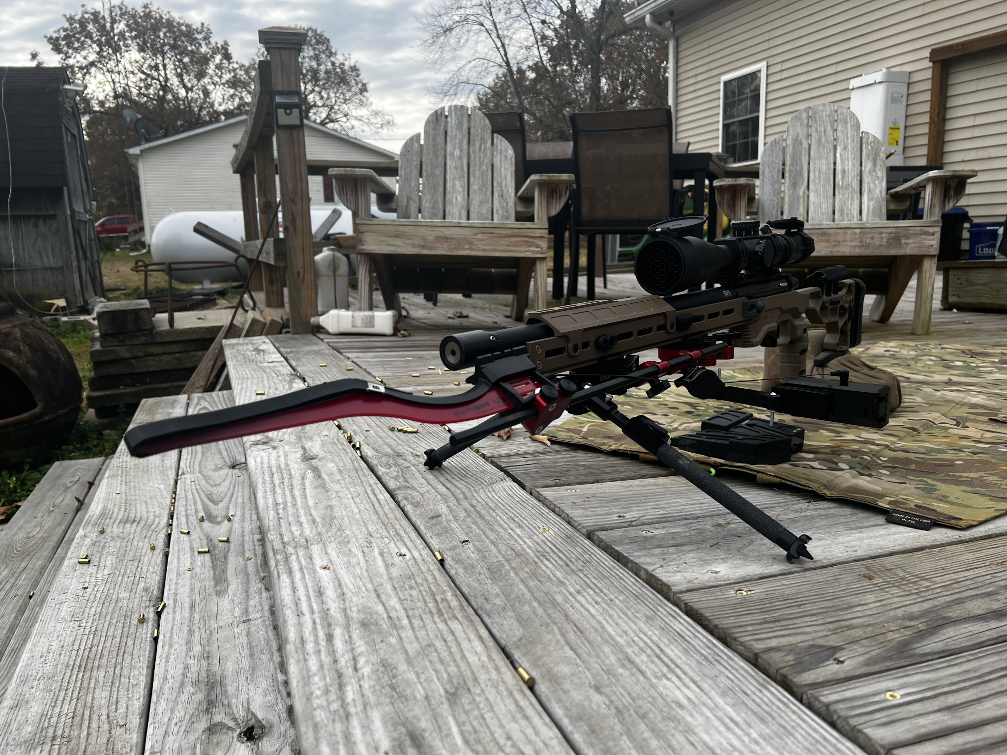

After a quick zero check at 50 yard. Wifey drilled this 3 round group at 200 yards with Eley Pistol Match. And then a 10 round group at 150. Light winds 9 o’clock 2-3 mph. She used to do even a bit better with a trigger tech Diamond but since it’s her “trainer” I put a TT 2 stage because that’s what she has on her Arc Nucleus 6.5cm so the pull went from 8 oz to 1.25 lbs.
RimX, Paradigm 16” barrel carbon wrapped.
Reactions: camocorvette

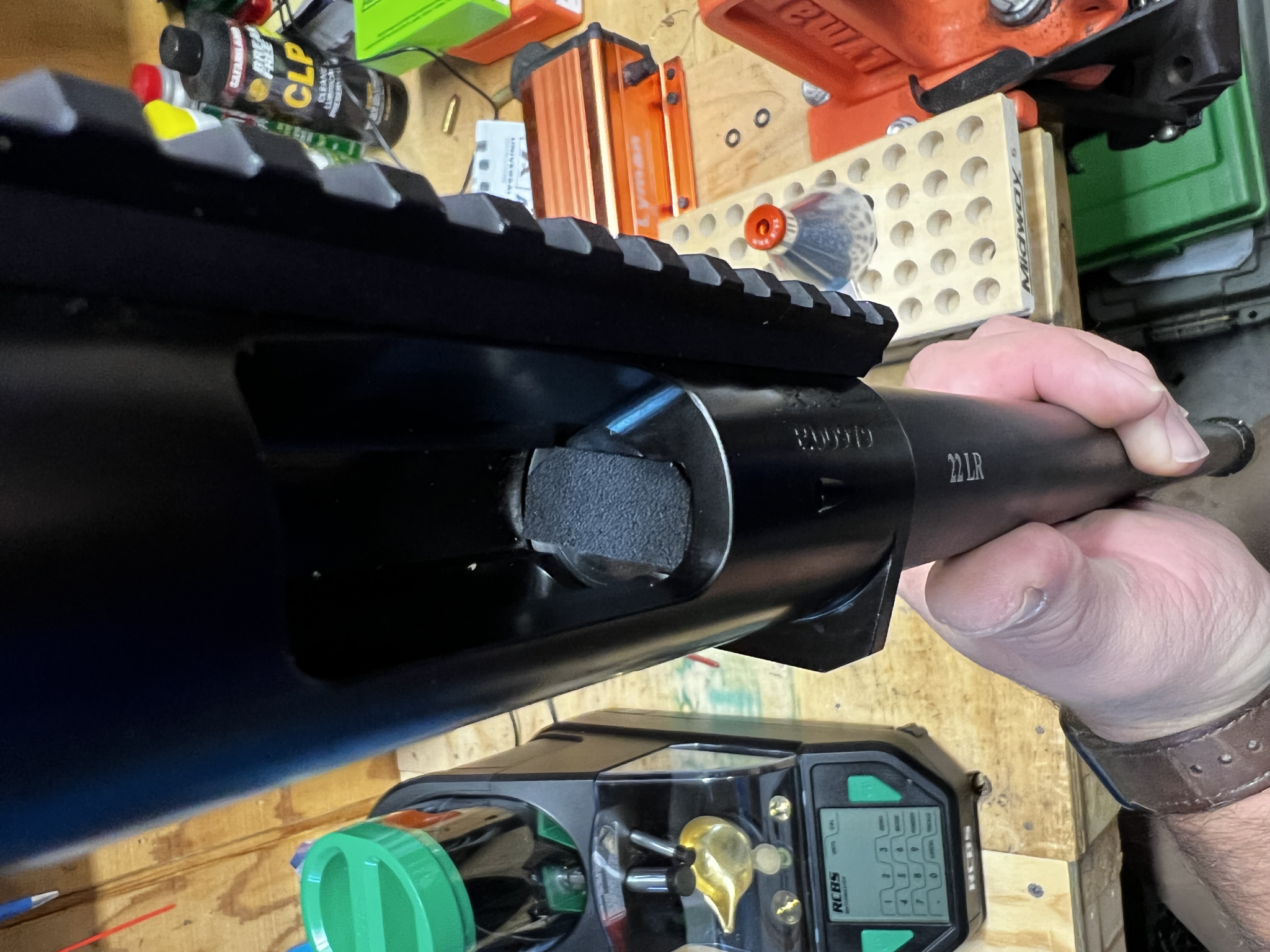

A thin piece of kidex on the breach face below the action wrench makes me feel better when spinning a barrel off & on. Textured side is up and slick side is down.
A thin piece of kidder on the breach face below the action wrench makes me feel better when spinning a barrel off & on. Textured side is up and slick side is down.
To be honest, you should leave the ejector in the receiver when you use the action wrench and just stop when the wrench hits the ejector. It will have more lug engagement and torque will be absorbed better by the receiver.
Being that far away from the threads is acceptable since there is considerably less torque required in this area.
Thanks - Ray
Thanks - Ray
Thanks. Ray. I was afraid I would screw up the ejector some how. I will not remove it next time.
Thanks - Ray

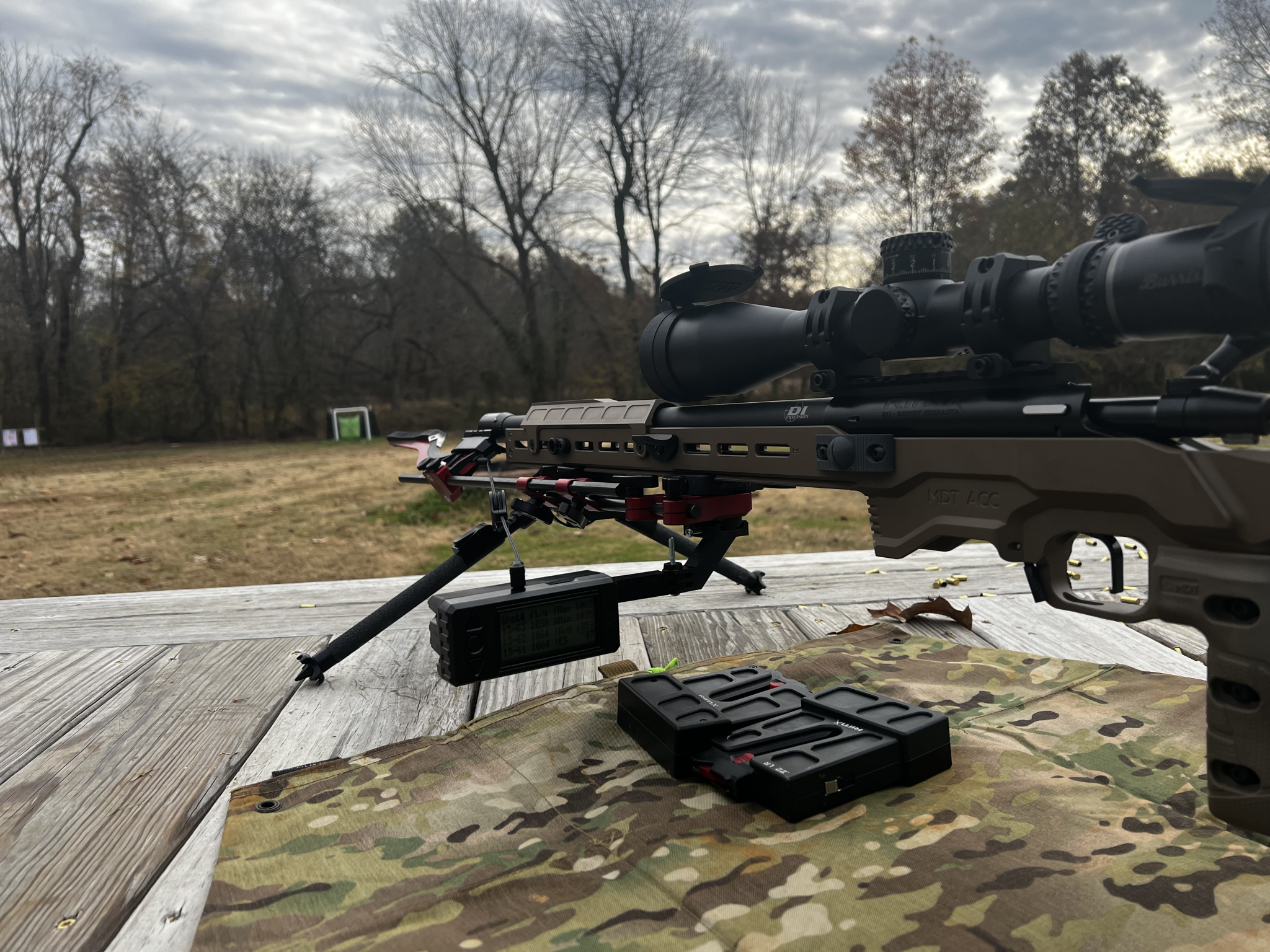

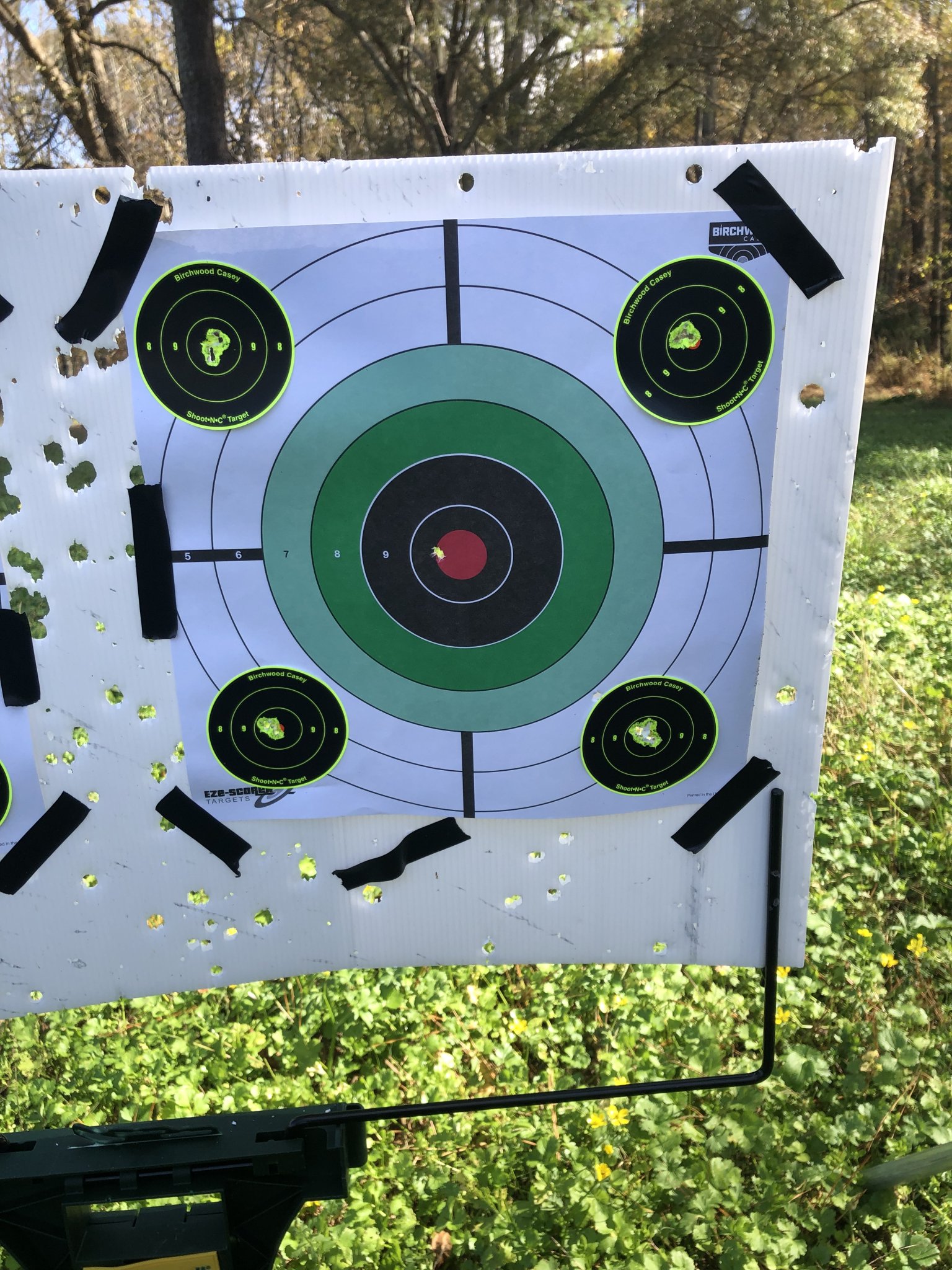

I finally was able to find some time to shoot the RimX at my dads farm. This rifle is so fun to shoot. The action is so smooth and feeding is flawless. Shot 250 rounds today of RWS Rifle match without incident. Here is the targets for sighting it in and getting use to the rifle. I spent the rest of the time shooting my KYL target at 50 and 75 yards. Only missed a handful which for me is outstanding. All the groups are 5 shot groups shot at 50 yards. Didn’t measure them but I was happy with them.

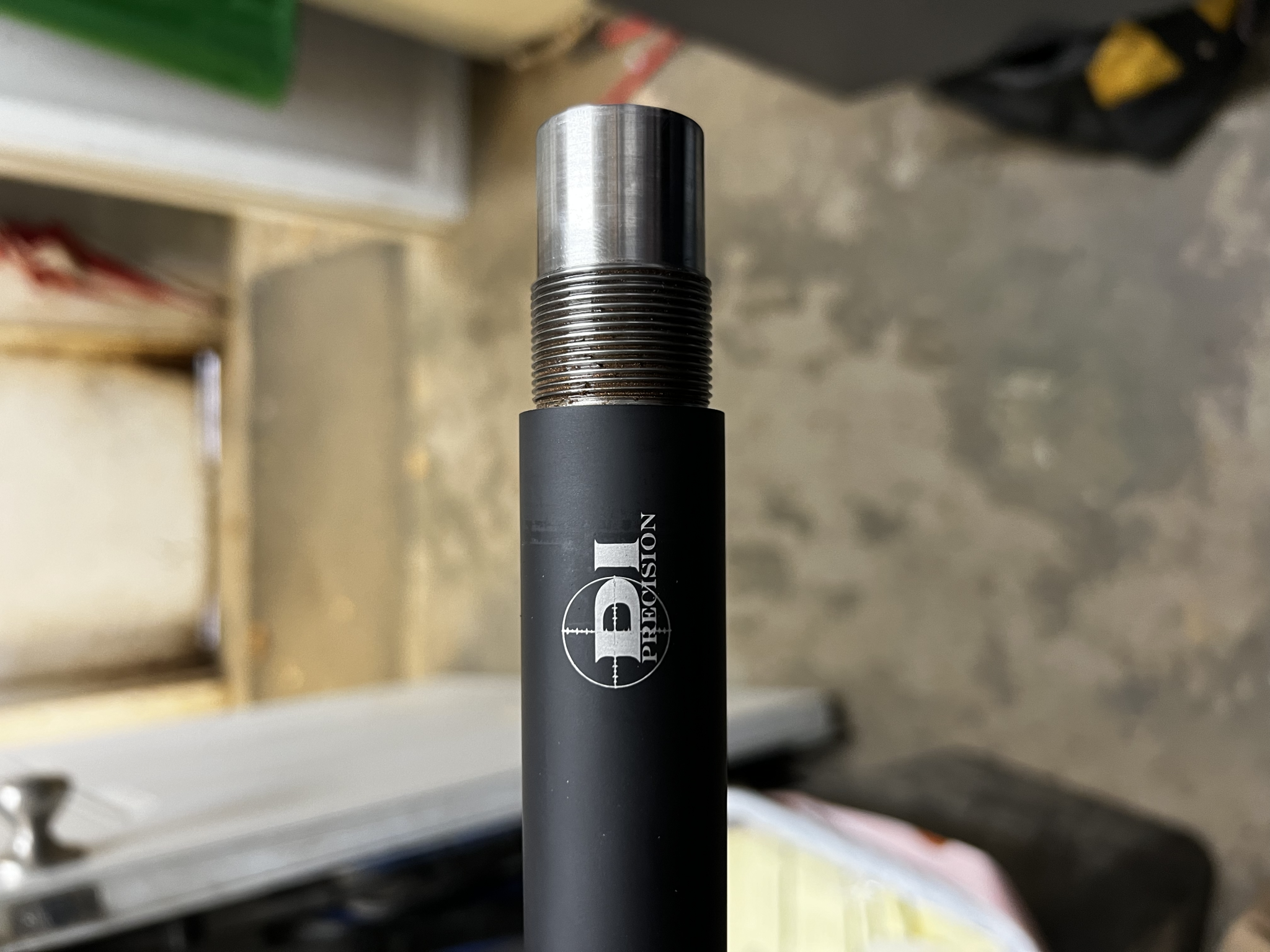

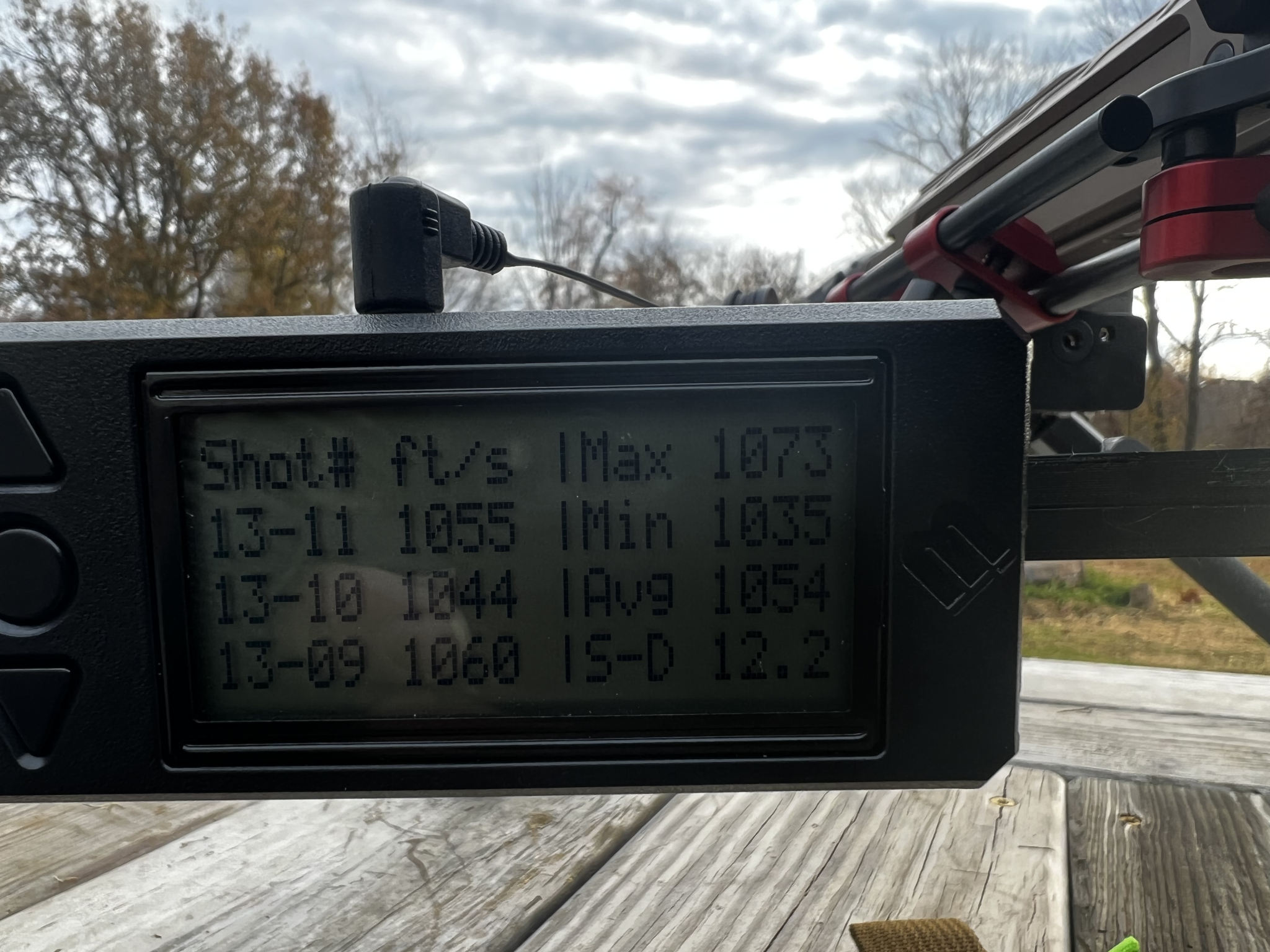

I was able to shoot my New to me Di Precision built Kreier 22" 16T with EC Tuner on Saturday. I am shooting a lot of SK Long Range that I had 1900 rounds of. I was happy with the Tune test and need to stretch it out to 100 for a fine adjust. All in all I think its a great barrel and I will be shooting it for the next few matches.
I finally was able to find some time to shoot the RimX at my dads farm. This rifle is so fun to shoot. The action is so smooth and feeding is flawless. Shot 250 rounds today of RWS Rifle match without incident. Here is the targets for sighting it in and getting use to the rifle. I spent the rest of the time shooting my KYL target at 50 and 75 yards. Only missed a handful which for me is outstanding. All the groups are 5 shot groups shot at 50 yards. Didn’t measure them but I was happy with them. View attachment 7745198
View attachment 7745200View attachment 7745246
Get a Vudoo it will shoot better. Your groups suck
….ok. Haven’t been shooting since July due to the death of my father and not really trying to get the absolute smallest groups I was ok with them. The rifle is more than capable of shooting much better. But you have a good day.
That’s why I blocked him a long time ago.
Don't let the troll get to you. They've been in and out of this place a few times spewing garbage that certainly doesn't add to the conversation.
It takes all kinds of kinds they say.
